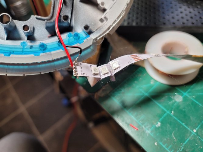

For the update, I was up at 0430 with stomach problems, so I haven't done much today... New soldering iron made it, a cheap Ryobi 18V soldering station, but man it solders.

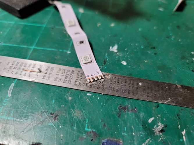

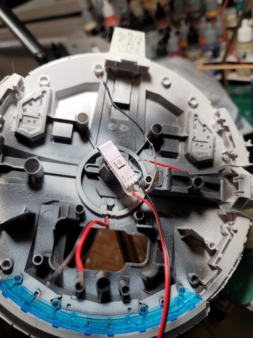

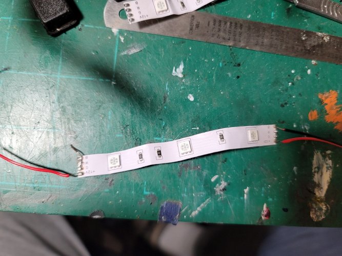

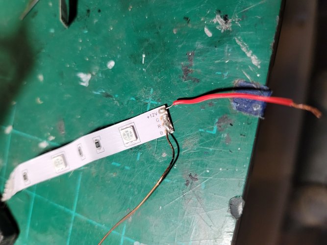

These are 12V RGB LEDS from a mood lighting kit, 3 in the cockpit, and these thre will light the gun tubs, and boarding ramp.
I solder both ends of these three, cause, the other elements will get thier power from this one. I soldered solid copper wire across all three terminals on one end, and only to B on the other.
Then folded so that an LED points up, one down and one into the ramp.

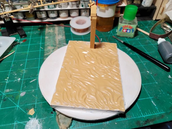

![Millenium Falcon 077.jpg Millenium Falcon 077.jpg](https://www.zealot.com/data/attachments/186/186424-ccdbf4d2704106e96c7fed4d5ff23ef6.jpg)
Also in the above pic, you can see my main power coming up thru the lower gun shield, immediately aft of the stand mount. I am going to pose it in left banking climb.

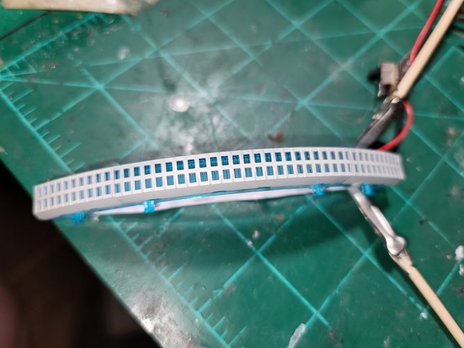

Then 12 LEDS get folded up, and taped together to light the engine grill. You can see the process I use to fold them here.
I'll get pictures of the work on the stand tomorrow.
