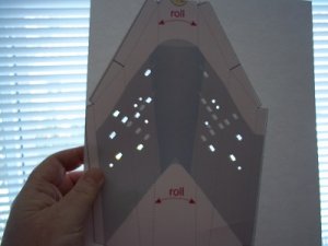

Not exactly what I wanted for Ron's recolor and 200x enlargement. I guess it will have to do until I get my skills at cutting windows out up to par. I used a xacto blade and surgical scissors [tiny]. Kind of disappointed as I wanted the windows thing to be very easy for builders to do, hence the black backing with blank window spaces to shine thru. I will now print the entire piece black on the back and cut them out.

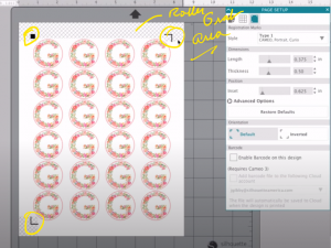

Only 50%!! Not COOL! I don't know the cost difference between my Cameo and the Cricut..but on Print and cut on the Cameo you get about 95%, Just have to leave 3 squares open on the top and bottom Left edges for the registration marks... I do know the Cameo was NOT cheap! But I got lucky and got a Cameo with tons of stuff, cutting mats, extra cutters, etc, etc. as a system on a dirt cheap sale, so! That and at the time, it was a far better unit than the Cricut....but I know they have all changed since then. The one I REALLY wanted, was in the 1500-2000$ range was the Skycut D24 Dual head Professional Plotter/Cutter...up to 2 mm cut depth, and they use a spiral cutter blade vers. an x-acto type blade...Hey, they are on sale NOW!! only $1,498.00...that's a whopping 100 bucks off!! Yeah, Right, at that price gimme two!!
wow! ok, so you increase the border on the top and bottom left sides and that will increase the cutting area?
Cutting area is determined by page size, up to 12x12...( Mat limitation...but then you could find some 3 mm vinal and make that 12" x 30' if you wish!
On the print and cut side of things, it takes 3 registration marks Upper L&R and Lower L...these have to be a clear area and set up in the page view for P&C...I use Legal size card stock, so they don't even matter for me with the extra 3 inches of space.

I think I understand, 3 g's high and 4's over added to the bottom. Then I row of g's on the Left? side. I will be drilling you for answers when my unit arrives!!
I used to take a tooth pick to rub the end of windows, then a machinist file to clean up any fibers. This was mainly for porholes on ship hulls. Your windows look great to me. ;)
