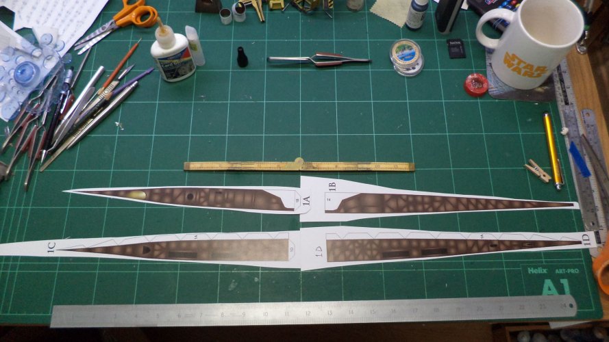

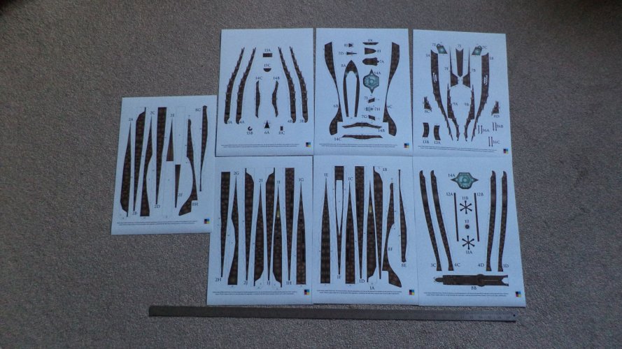

Around 78 parts make up the model, and as custom on my builds of late, I had my local copy shop, enlarge this up onto A3 sheets.
Giddy with excitement and rubbing my hands with glee... *I set sail to own my Nautilus - *Come with me as I dive in!
(*This build will no doubt be full of nautical puns)
Sorry for the low light on these first two shots, as I was away from the bench, due to technical reasons.

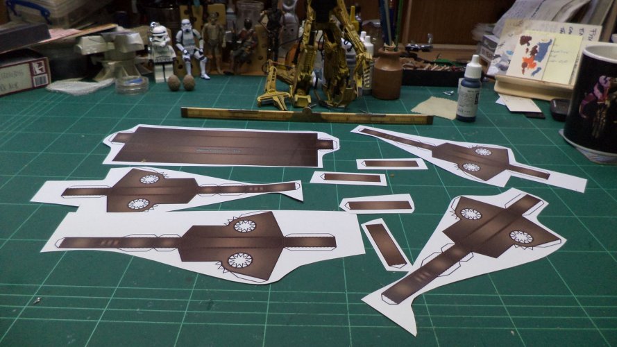

78 parts on seven sheets are the order of the day here, with a further 9 making up the stand (sheet not in picture)
Parts have good register and offer a nice rendition of the boat.

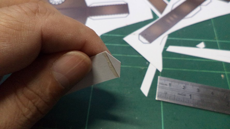

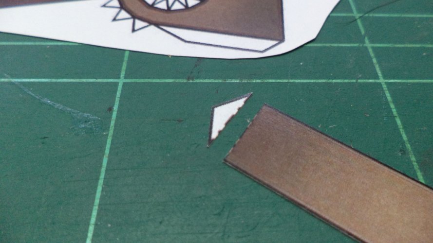

On this build I will be cutting off the tabs and re-setting them underneath - I think I've had just enough experience now to edge bond, rather than rely on tabs. Certain areas warrant it, but I would like smooth edges on my constructions from now on.

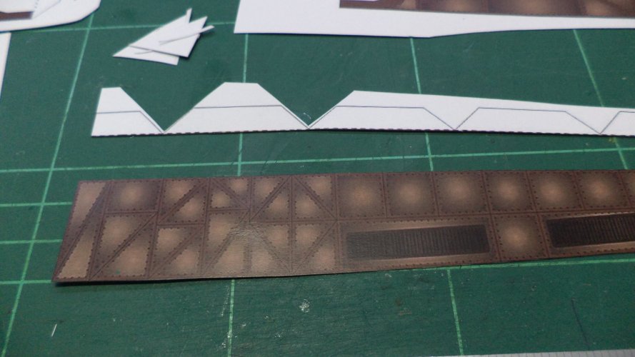

Tabs on the parts help locate some connecting points.

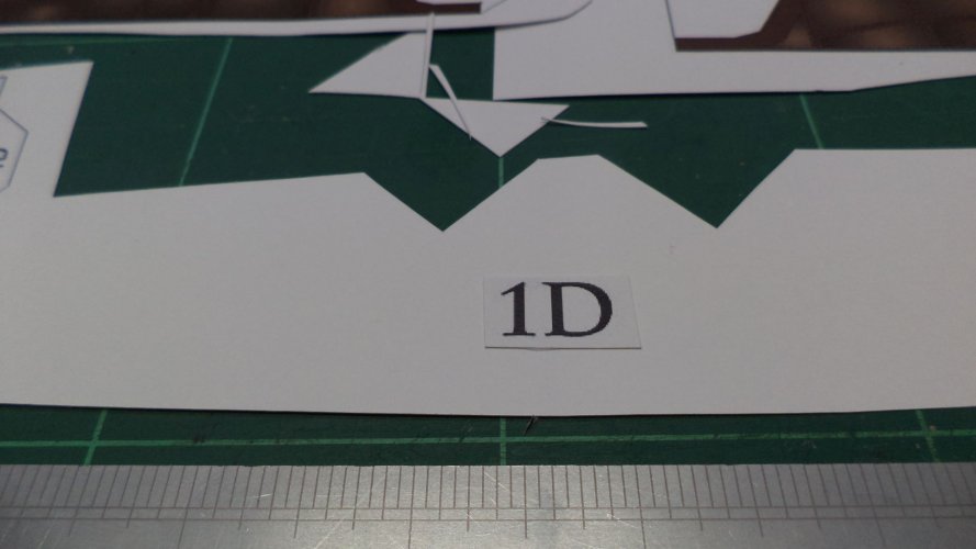

In an effort to make sure parts were not mixed up, I cut the number off the part and stuck it inside.

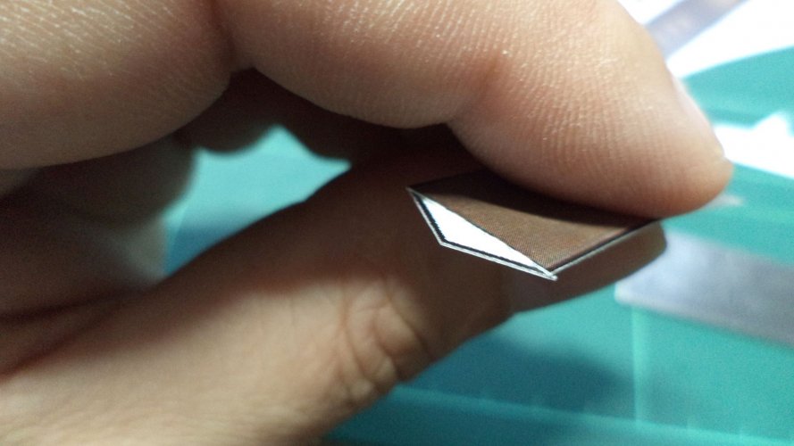

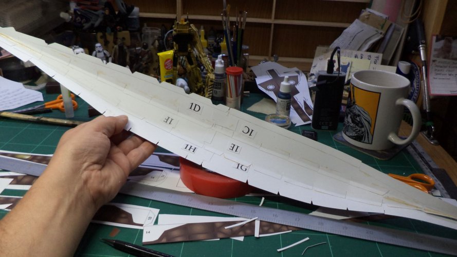

Progress continued and as mentioned in the first part of the build I was cutting the tabs off and resetting them for a flusher fit.

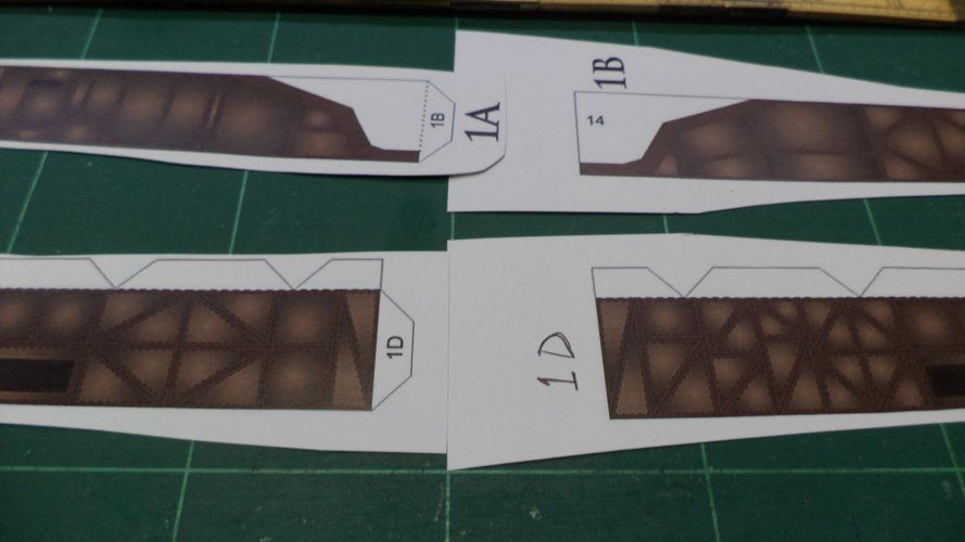

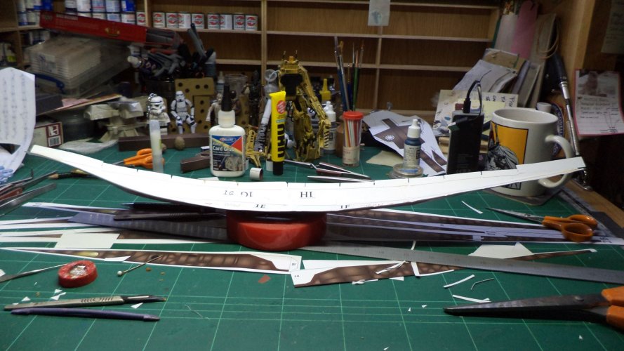

Instead of starting with the parts as instructed, I took it upon myself to start at the bottom as there made more sense with some of the parts and their fit - Six sections of plating which make up the underside were selected, I joined these in the middle to form three lengthy strips.

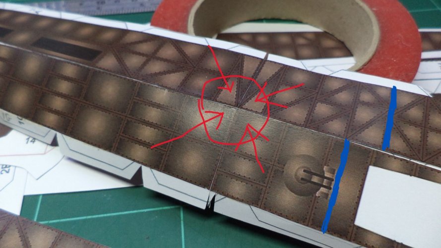

Tacking one to the hull and popping off for a coffee, I came back and noticed an oddity.

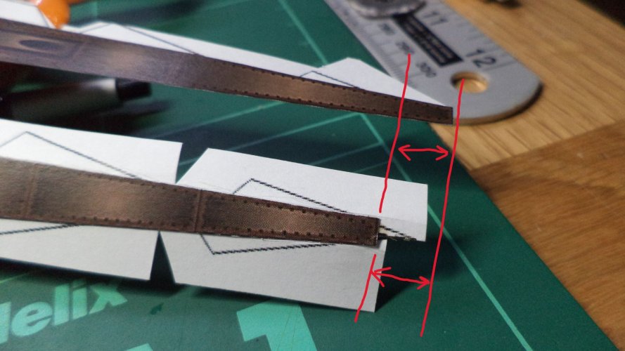

Without dry fitting the parts I had joined the plates in what I thought was the appropriate place 'the middle' but the blue lines are the correct 'I hope!' position.
You can see here the discrepancy in length - a pour over the plans suggest all the stern sections end in the same place. Noting too the panel lines and where they corresponded with each other was also in order.
Thankfully not too much damage was had pulling them apart and this time a dry run made.
Starting at the stern for a second attempt proved much better, and all was well.

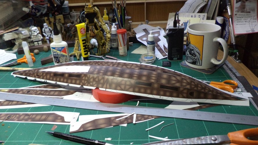

Re-setting the tabs has meant for slow work, but it one afternoon the lower hull has been formed.

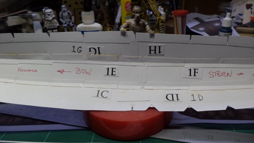

She will be over 30" when finished...
If there was a plan picture showing how these matched up, I would've appreciated it!
Making sure all was as it should be.
Looking slightly like a Junk, rather than a submarine!
Appearing to be an 'easy' build is proving to be more difficult than first thought...but we shall prevail!
