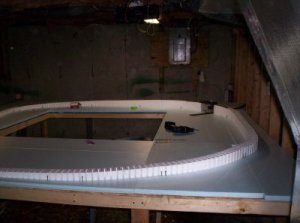

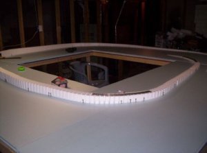

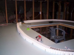

i hope this works this my new layout in pregress its ho bench work size 11' x 11' with a 5 foot hole in the center for track cleaning each table is 3'wide

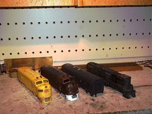

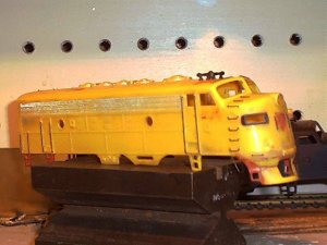

I've gotten a few of the shells repaired and started adding detail parts.
The F7 shells all had some steps rebuilt that were broken off, A pilot was fabricated for the Athearn F7A, the winterization hatch was replaced with a 36" fan and another pilot was grafted onto the Bachmann shell, the lower headlights on the F7As were filled in, the steam generators were removed from all the shells and the molded on grab irons and lift rings were shaved off and replaced with formed steel wire.

Here's a closer look at the Athearn F7 pilot.
I have installed the grab irons since this photo was taken and just need to install the Pennsy style Train phone antenna.

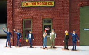

trains1972 still look'n good, do you have any shots of your son's weathering job?
My next structure is moving along very slowly so I thought I would attempt at a couple more LPB's. 7 down, only 100+ more to go. :eek: Here they are gathered at Cliffton Motor Co. just passing their time away. (I am affraid to get any closer, it might get scary. I figure they look pretty good far away so we'll just stay at this distance.) They need a shot of dullcoat and once I decide where they will go I will perform a little plastic surgery and cut their bases off. :eek:

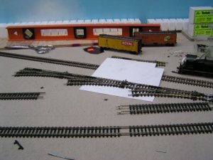

As for me, I had to rip out the yard ladder. My switcher kept derailing, and no amount of shimming seemed to fix the problem. Basically, the ladder was right over a spot where 2 pieces of benchwork meet, and there's a slight bump in the roadbed - almost impossible to see, but quite enough to cause problems.
So, I'm relocating the yard ladder. This will actually give me a longer yard, so there are some plusses to what is otherwise just frustrating.
spitfire
Jul 28, 2002
3,448
Toronto, Canada
www.parkdaleyard.com
That's funny - I timed out but the post went through anyway. Ok, here are the pix I was going to include.
1. Ripping out the ladder.
2. Mockup howing how the upper level track will look.
