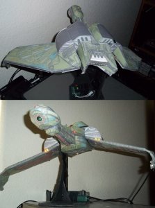

Messing around with this, got it finalized now. But darn! those little flaws look as big as a house!!
I put the video link up again so you can see the led effects better. That green battery box is for 2 AA batteries
to show how big this is.

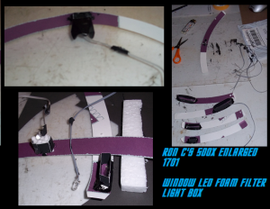

Still cutting up the lite boxes on the big 1701.

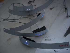

Also, still working on the rims part of the 1701 saucer. trying new material.

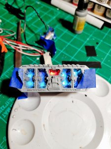

Got the lights up on the rim finally. Next- The Saucer. Unfortunately, the printing on the back of the rim parts came out a faded purple instead of black. I will simply buy more black ink for future projects I guess.

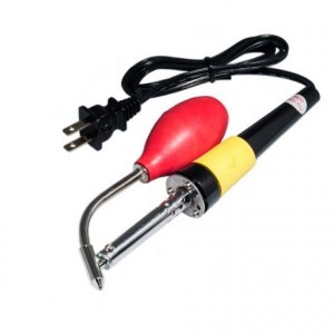

Hit a Tag Sale, and try and find a "Weller" soldering base, with solder want. One that has a temperature base is even better. I picked up a real beauty for $15 bucks a couple of years ago. That unit would be in the $100's today. Even a regular wand can be found for $4 bucks. They have better tips than the new junk they make, which will not tin and only apply heat. I would recommend a solder sucker, it's a wand with a heaterd end that has a hole on the end that heats up. you squeeze the ball, and when you need to remove solder or remove some solder, the releasing causes the molten solder to get sucked up. I have obtained them for free when people though they were no good. All you do is put them over a propane stove, and the solder inside the tube melts, and you just blow it out, voila, new solder sucker.
The one below is #14.88, though the shipping is $8 bucks. I'd try to find one locally, if you have any electronic shops. ;)
Link = https://www.showmecables.com/desold...MIkNyjrrHC7QIVhNzICh2jbg94EAQYBiABEgLnZPD_BwE
