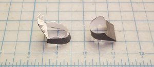

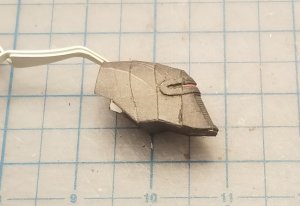

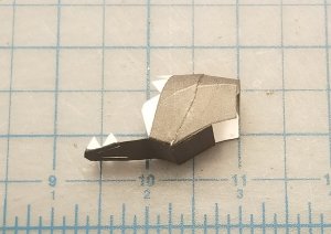

Now working on the head.

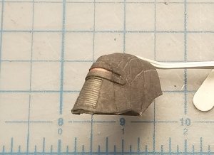

I raised the "ring" around the "eye".
I recessed the "mouth" and scored the lines.
The head is attached to the lower part of the body.

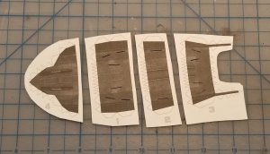

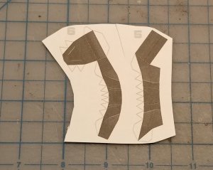

To continue work on the body and internal formers.
Here are the internal formers.

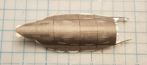

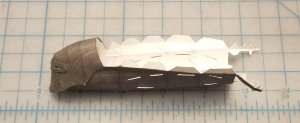

The internal formers are inserted.

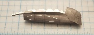

The skin for the top of the body.
The main part of the body is finished.

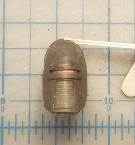

So, as promised, I have finished the body of this Raider!
As you can see, I have enhanced the scanning "eye" (by cutting a circle and painting it red) and raised the border around the "eye", recessed and scored the "mouth" (by "mouthpiece"area open and layering another "mouthpiece" behind it, and added detail to the inside of the main exhaust by layering the texture.
