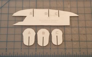

To continue work on the body and internal formers.

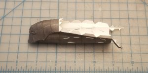

Here are the internal formers.
The internal formers are inserted.

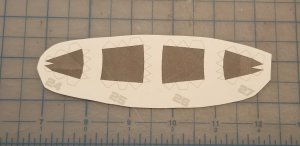

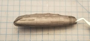

The skin for the top of the body.
The main part of the body is finished.

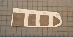

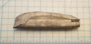

The main engine exhaust components.
The main engine exhaust is attached and the main body is complete.

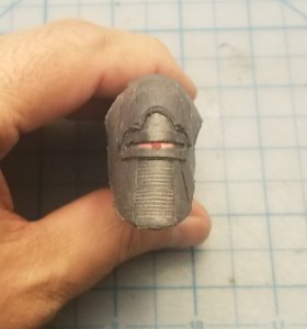

So, as promised, I have finished the body of this Raider!
As you can see, I have enhanced the scanning "eye" (by cutting a circle and painting it red) and raised the border around the "eye", recessed and scored the "mouth" (by "mouthpiece"area open and layering another "mouthpiece" behind it, and added detail to the inside of the main exhaust by layering the texture.

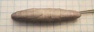

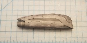

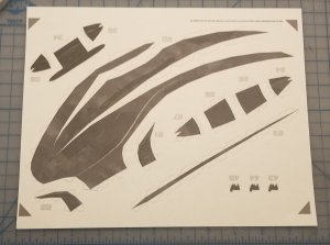

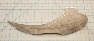

I have started with the wings. I have to say that the wings are a bit tricky. There are interlocking glue tabs. SO, cut them off and use glue strips (unfortunately, I did not).
Starting with the top part of the wing. Here are the parts sheet for it.

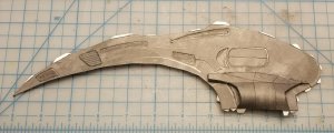

Here is the main body of the wings. Be careful of lining everything up. IF you do not, the wing will warp.

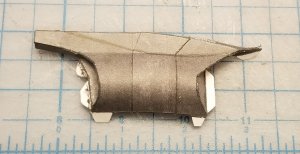

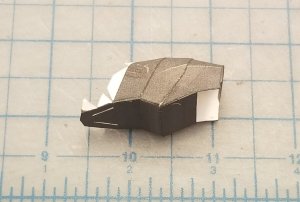

These are part of the wing root.

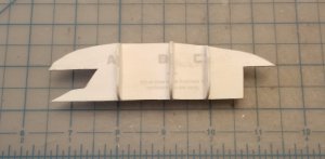

This component goes on top of the top part of the wing.

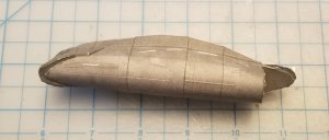

The component is assembled (The component looks like a "slug")

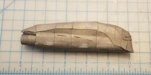

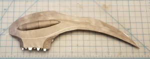

The "slug" is attached.

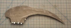

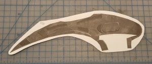

Here is the bottom half of the wing.
As you see, I recessed a few areas and louvered a section. So, to complete this, I printed out two parts sheet for this. I cut out the areas that I wanted recessed, and then glued the second part to the back (giving the look of the areas being recessed). I then made "louvers" for the "vent" in the front of the wing.

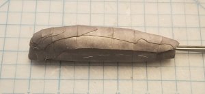

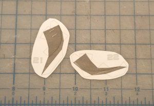

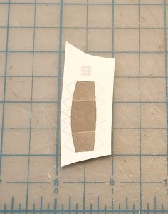

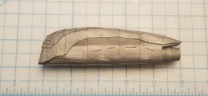

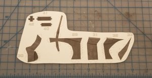

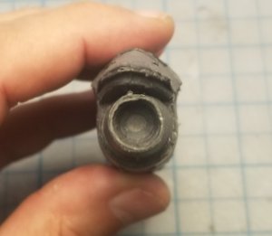

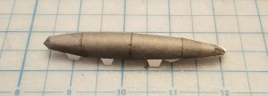

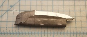

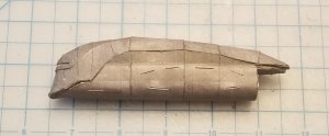

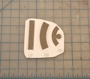

These are the parts for the air-intake and wing mounted engines.

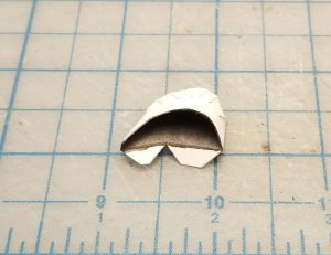

Here is the air-intake.

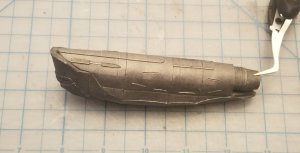

The engine is assembled.
The engine is mounted to the wing.
