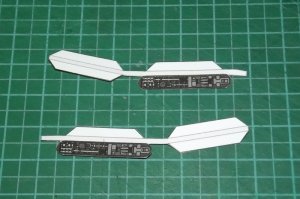

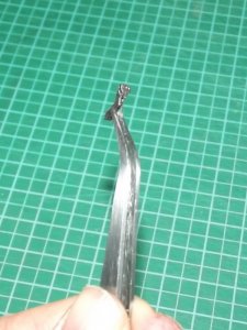

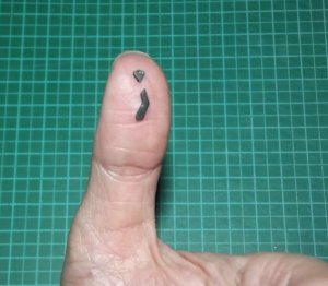

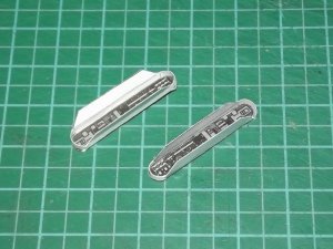

The assembly of the joystick was simplified. I opted for laminating the front sides to 1 mm card and painting the edges and the back sides black. This simplifies the build and saves two parts.
BIG thumbs up! :)
Beware, these parts are TINY!
10,104
9,727

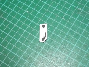

The joystick was glued into place and the CI is put aside for a moment.
The placement marks for the seat had to be slightly revised. The good thing: Joel's graphics have been applied straight and level. Phase 1 accomplished!

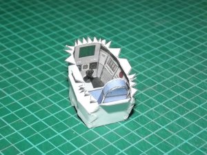

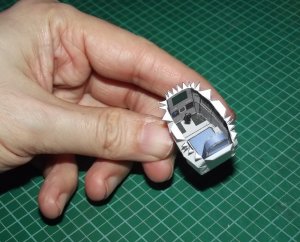

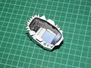

I have found the cockpit tub to be too complicated, so I changed the shape to a "bath tub" with a straight bottom. The step is gone. It was a side effect of the real CI mockup which had holes for the legs of the actors in it. When I pulled the front area down to make a closed cabin without holes the step was created.
Necessarily the chair had to be heightened.
You always have to keep in mind that the Viper mockup had nothing but the chair and a flashing light in it. The cockpit interior was a very crude thing which even did not have a seat:

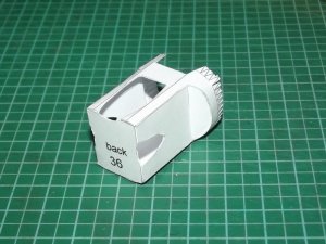

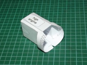

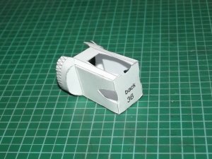

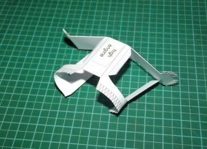

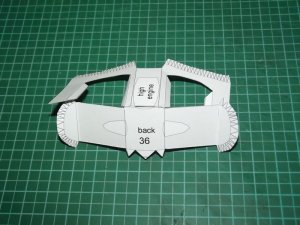

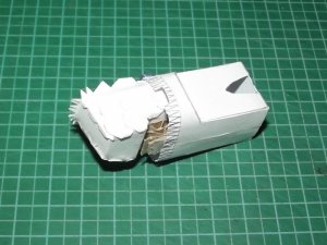

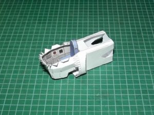

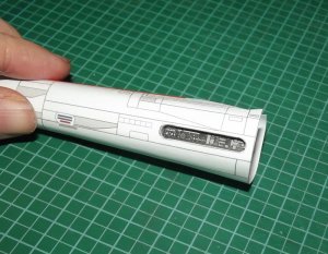

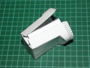

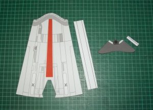

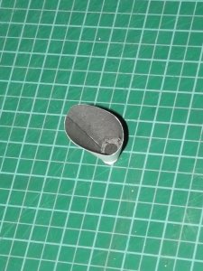

The back of the nose consists of two parts:
The glue strip guarantees a smooth finish.
After the parts were joined the white areas are cut out.
The CI is glued into place.

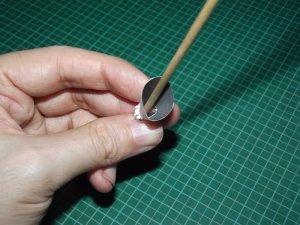

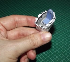

The tub was shaking around a bit. I added some corrugated card to the bottom to fasten it up. A similar option will be added to the final kit.

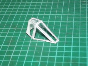

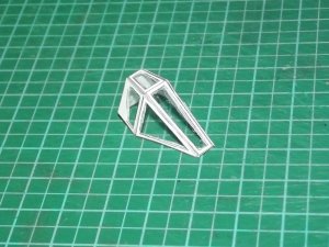

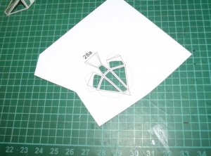

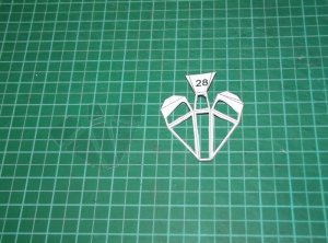

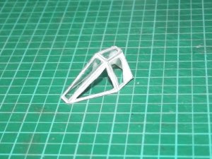

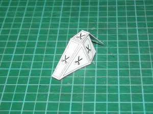

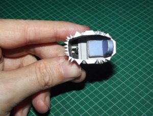

The canopy assembly is pretty tricky but doable.

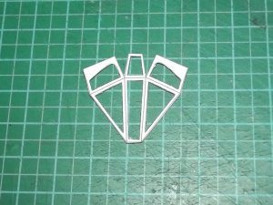

No matter if you want to use a canopy with clear "glass" or a closed canopy with tinted windows you'll need to cut out very thin frame pieces and glue them on top.

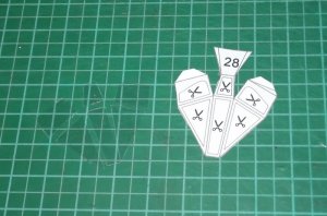

First you cut out the canopy part itself and use it as a guide to cut pieces of clear sheet that match the windows.

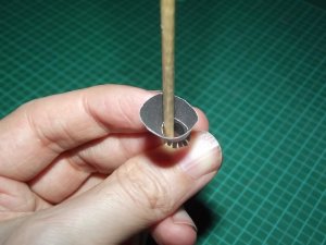

Then you pre-shape the canopy.

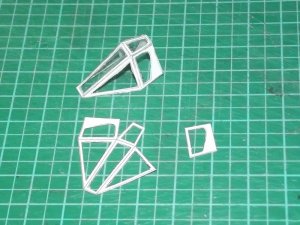

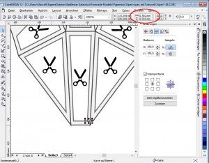

Flatten it again and cut out the windows. Be careful and patient and use a sharp knife. It is better to wiggle it through the paper instead of really cutting through it. Start on a sharp edge and push the knife down. Then move it a bit down the line and press again. Repeat this procedure until you are 2/3 through. Then turn the part around and again start at the sharp edge, wiggling towards the point you have already cut. This ensures that your cuts stop at the edges and don't damage the thin frame.
Edge-glue the canopy together.

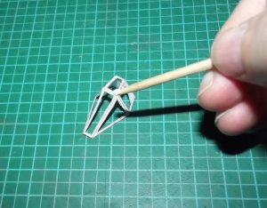

Use a toothpick to apply glue to the frame.
Attach the clear sheet pieces one at a time.
The edges look milky because the glue is still curing.
The kit comes with two canopy parts, one for a glass window version and one for a tinted window version without CI. You will need both to complete it. If you build the model with a tinted glass canopy you'll need to attach the frame pieces of the glass frame part and vice versa. Reason for this kind of layering: The glass part of the canopy sits a little bit higher than the rear part on the original miniature. The Revellogram Viper is wrong as the front and back part are flush. Moebius' Viper is basically better in that respect (minus the too prominent rivets they put on).

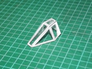

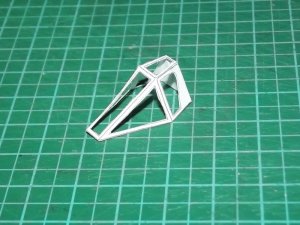

One frame piece after the other is attached on top of the clear sheet.
You may enhance the effect by glueing several frame layers on top of the clear sheet. Rhaven suggested to use thin strips of paper to close the gaps between the frame pieces. You may do so if you like. I'll leave it this way for the time being to save time.

It is really coming out great. One small bit of advice, either cut on the line, or inside the line, or outside the line. Chose your poison! :)

I know - the frame is so thin though and I'm working with bad lights and no magnifiers!!! :hammerhead: :hammerhead: :hammerhead:

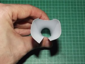

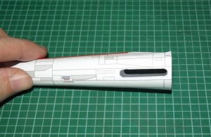

P.S.: I just dry-fitted the nose parts - they fit! I'm testing a glue strip connection. CU later! :)

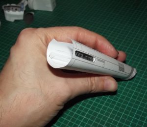

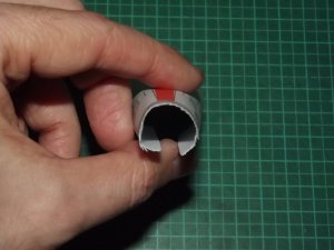

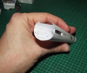

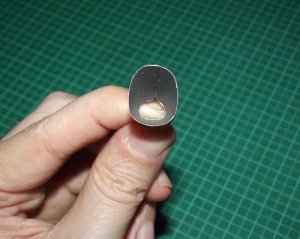

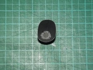

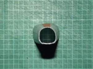

I'm still debating where to put the seam line of the cone that is inserted into the nose. At the moment it is on top because I thought that area won't show much when you look at it from a 3/4 perspective. Con: The line is fairly long. If I put it on the bottom it will be shorter. What do you think?
dscf5977-jpg.181128
bigpetr
Designer/Master Modeler
Jan 27, 2016
902
1,380
Czech Republic
From my experience I would put it on top because it will be looked at from the above most of the time, and on the top it will be more in the shadow even when viewed from below. To illustrate that - try to search for images of Viper. Majority is taken from above. :)
