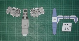

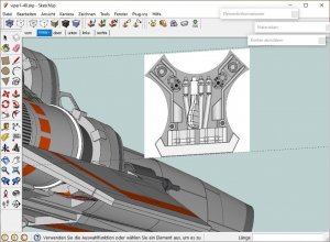

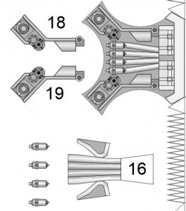

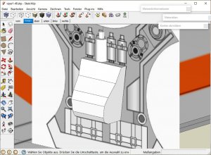

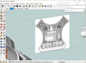

The small version will feature simplified Y-piece detail. I copied the detailed Y-piece I made for the larger version and turned the single tubes into one piece:

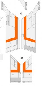

The tubes will be represented by the texture (part 16):
The landing gear will be a first for me. Since the landing gear doors do not allow being cut out like on the Thunderfighter because they are too close to the engines I'm using another solution here. It will be a contruction using slits and notches. The alpha test will show if the theory works. Stay tuned! :)

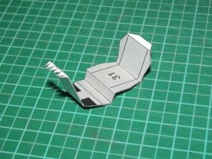

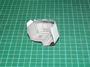

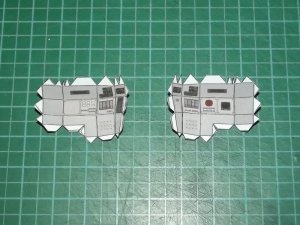

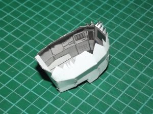

The side walls of the cockpit tub:

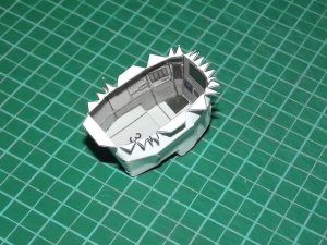

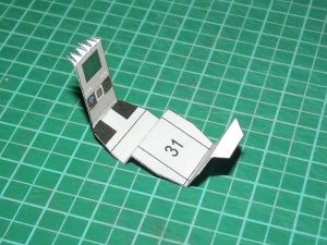

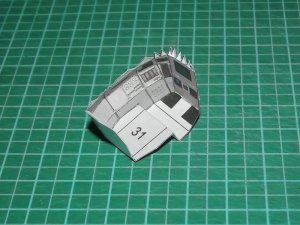

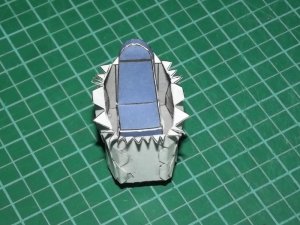

and the bottom:

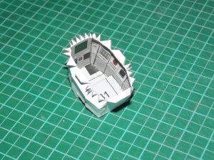

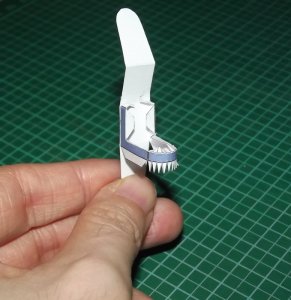

Attaching the sides is a bit tricky at this scale but it can be done.

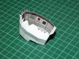

The dot thingies are no dead flies but the cockpit instruments printed at 1/48 scale. ;)

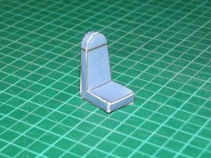

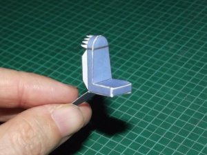

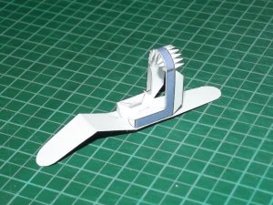

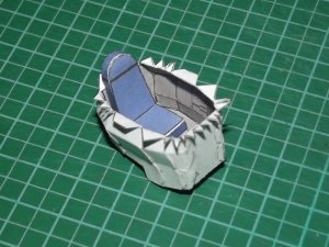

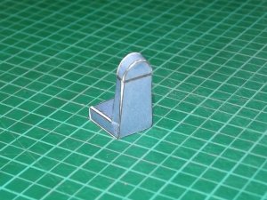

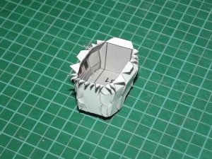

Seat installed:
