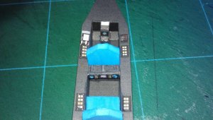

After the EXPO that I had attended recently, I had given my entire Thunder Fighter squadron (with the exception of the one that I built in memory of my mother) to the children of a member of the PM club that I belong to. I am now rebuilding my entire TF squadron with cockpit interiors, landing gear, and as much detail as I possibly can.
I will be posting photos of the detailed parts and explaining what all I am doing along the way.
I have started with the cockpit interior. I know that some (if not most) of the detail will not be seen once the model is finished, but I am doing this for my own pleasure (and torture sign1)
Here are the photos of what I have done so far:
Here I recessed the sensor screen.
I recessed the screens and raised the button panels.
I recessed the screen.
Raised all button panels.
Added seats and some control panels.

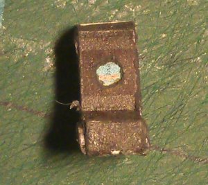

Update
Here is an update on my progress of the project.
In this set of photos, all I really did was raise a few panels to give realistic texture to the model.
Here are the photos:

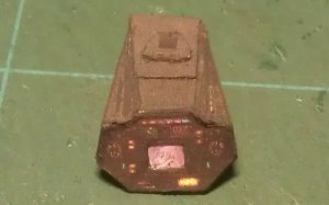

More photos
Here are more photos:
I scored the lines on the ribbed area that is on the front end of this piece.
Both halves are now attached.
Cockpit interior now in place.

How big is the model, just out of interest?
This is just the standard model size and scale (1:32) (L: 29.5cm, W: 17.0cm, H: 7.0 CM).
The only thing that I am doing different, is adding more detail by raising or recessing (or a combination of both) the textured panels, scoring vent lines, and what ever else, I can think of to enhance the overall look of this model.
