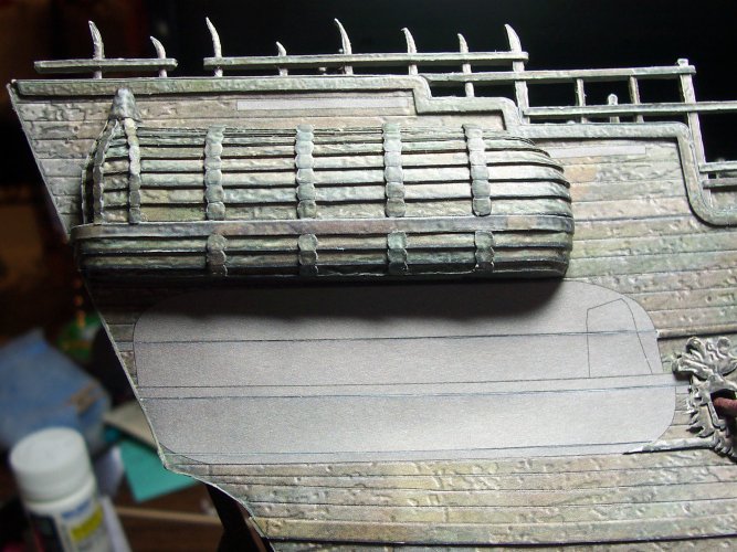

This is the first Quarter Gallery that will be fitted to the ship. It is for the upper, starboard location. This is where I needed to significantly modify the part to fit the ship. I used the sandpaper to grind the bottom so it is 3 planks deep.
This is looking at where the part will be fitted in the upper section, 67.13P. I found that all the Quarter Gallery assemblies had to be significantly modified for them to fit within the marked lines. I had to get pretty medieval on them for sure :hammerhead:There is NO-WAY they are going to just be a drop fit! Lots of shaping and griding!
The bottom corners had to be split, pushed, pulled and glued into the correct shapes to match the lines. Lots of test the fit, modify, test, modify loops. And there it is! Don't be tempted to just think ah, I will just wing it and glue it! That will be a disaster because the stern walks and stern decoration amongst lots of other assemblies rely on these being an excellent fit!
