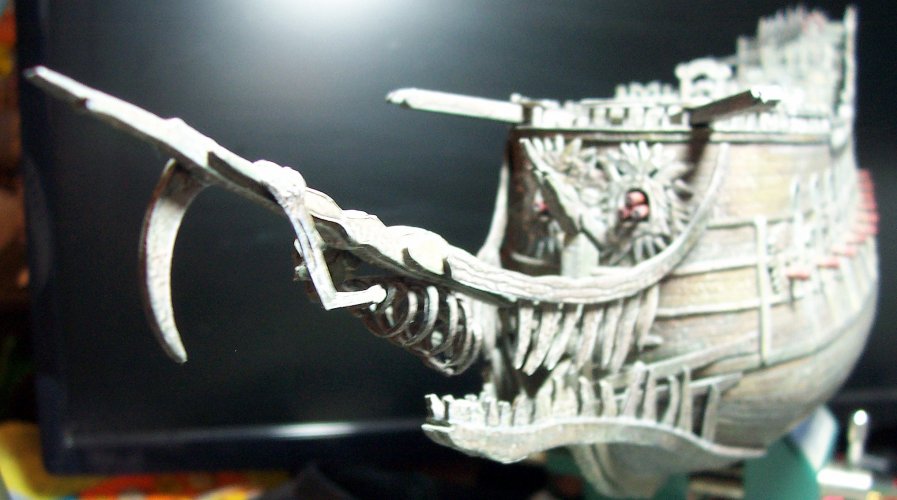

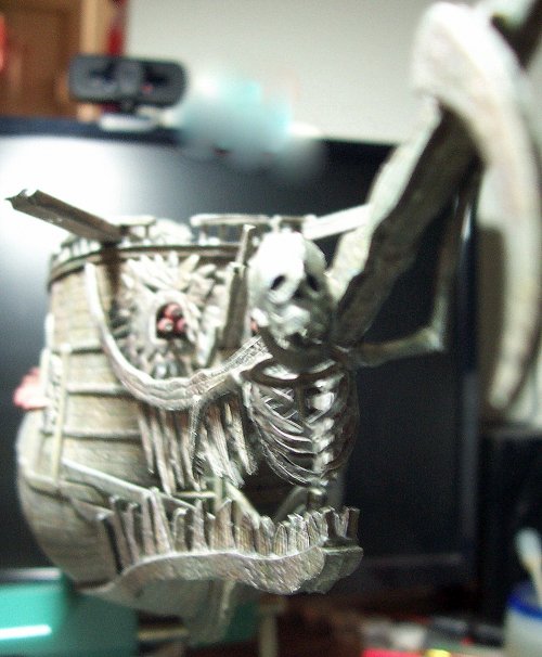

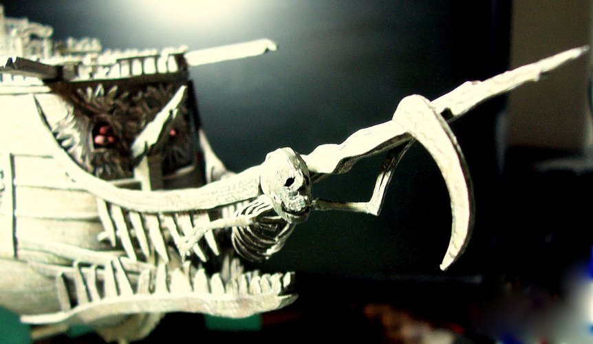

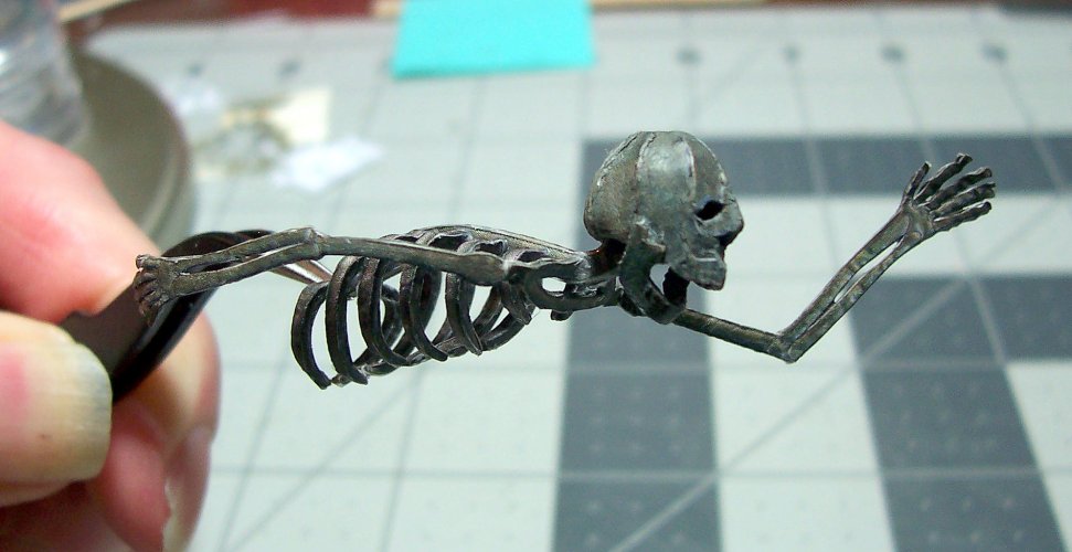

Continuing on with the Grim Reaper figurehead assembly, and installation. Good looking guy or what? :skull:biggrin:
With it installed on the ship. Kind of a sinister view from below.
Complete with his scythe.
I folded the skeleton's hand over the bowsprit.

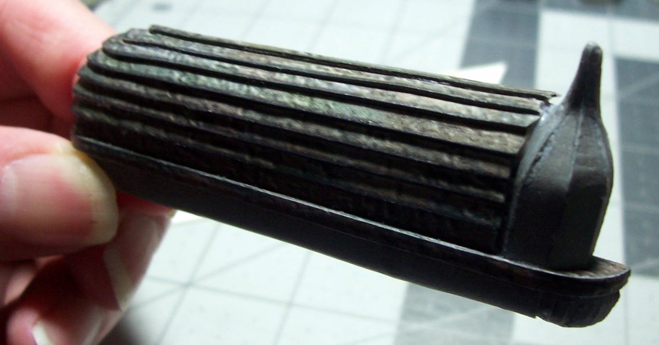

The Ships Storage Caskets​
I tried to find if there was a name for these but the closest I could find, was a casket. There is no mention in the instructions. They apparently built the same way as a barrel or casket with overlapping wooden planks to form a rounded shape.
I have to say that these were VERY difficult to construct. They were also extremely labor intensive. The smaller caskets are 94 parts X 2 = 188 total, and the large caskets are 168 parts X 2 = 336 total, giving a grand total just for caskets of 524 pieces.

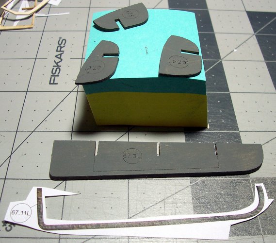

This is the plan for the structural bases.
Parts for the structure of the caskets.
Using discarded pieces of card to ensure that the layers are aligned true.
This is what it the 2 smaller caskets look like complete and ready for final panelling.

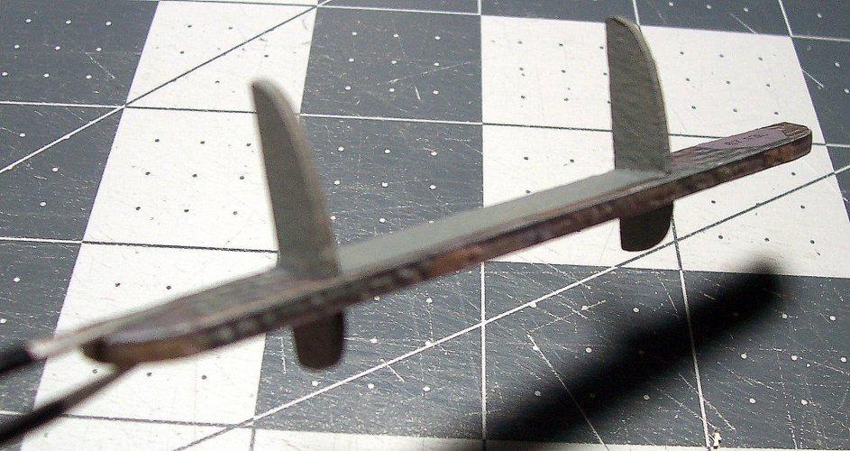

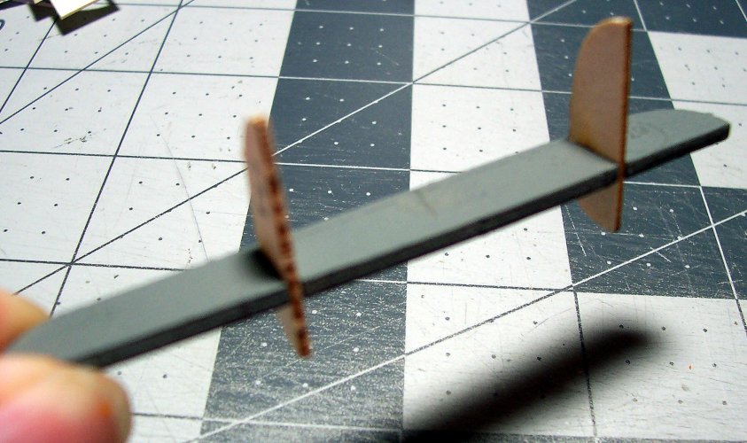

This is the central backbone with color veneers.
Glued and color veneers in place.

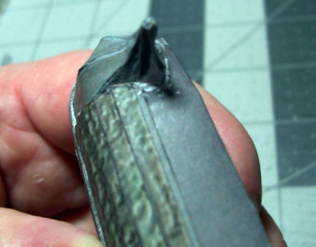

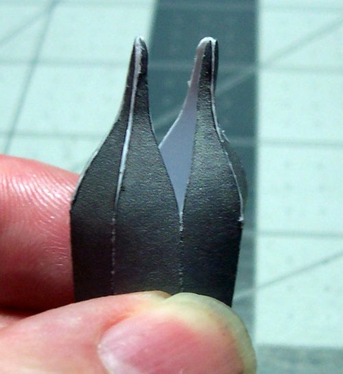

This is the "turret" that sits on the one side of the casket.
View of the turret assembled.

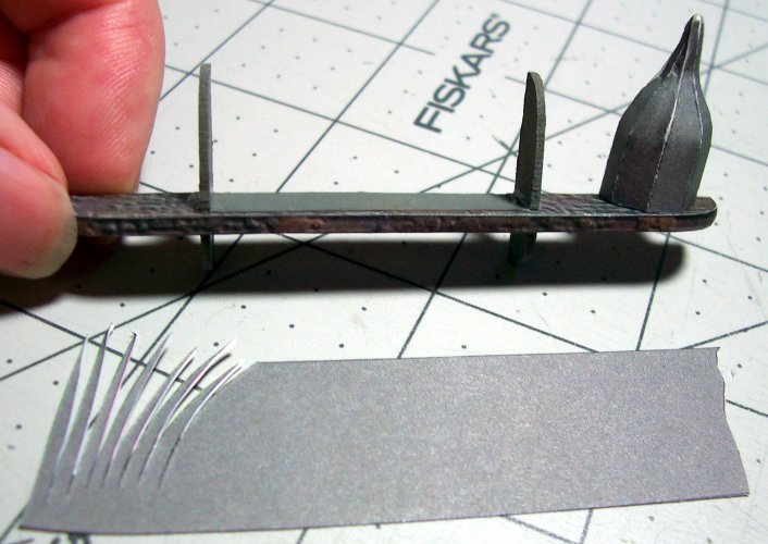

Base and turret ready for assembly together with the upper skin.
Its easy to get confused with this and put the pieces in the wrong positions, so be mindful.

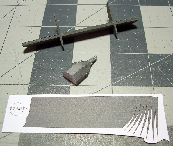

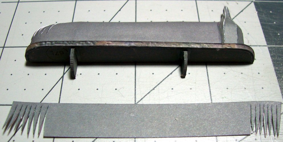

The upper skin is cut and ready for rolling and folding into place.

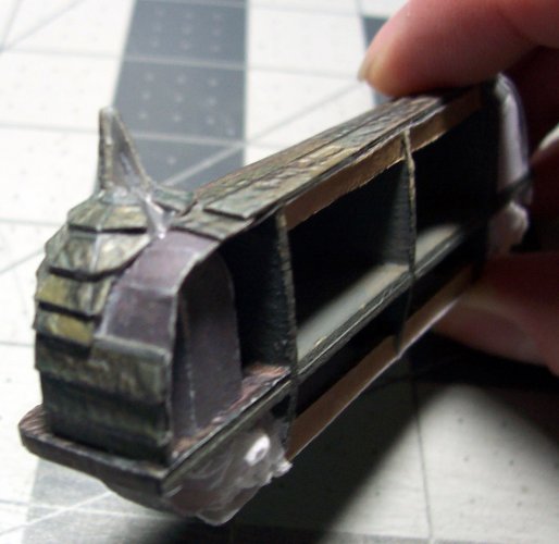

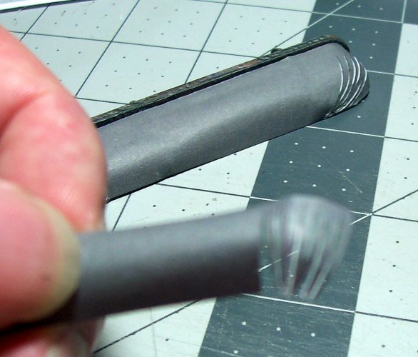

I used water applied with a cotton swab to help roll the skin into the correct form prior to gluing in place.

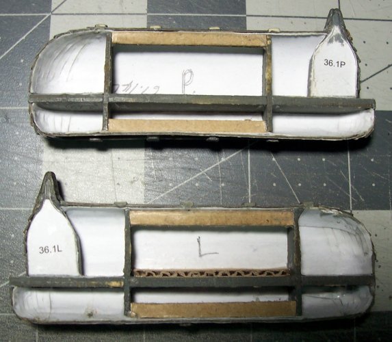

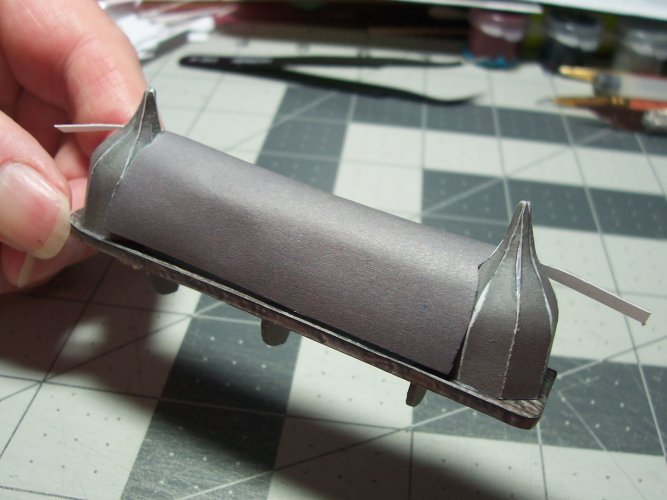

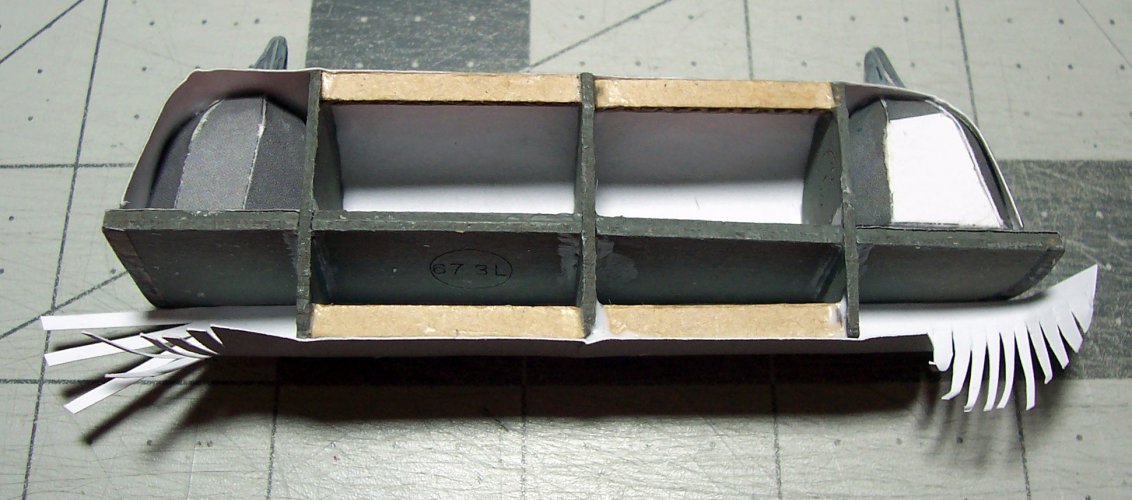

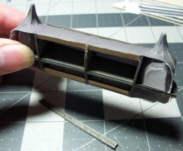

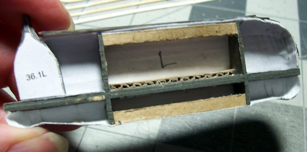

This is the inside view of the casket so far.

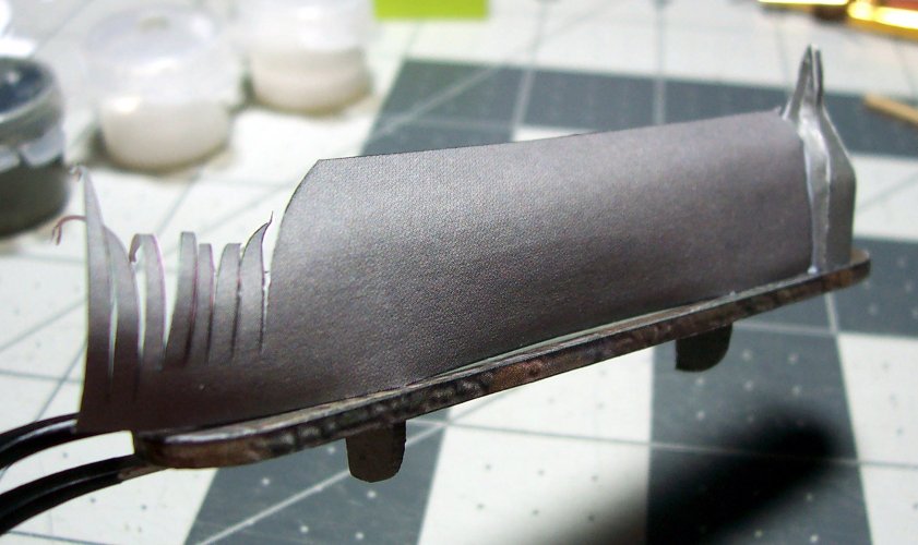

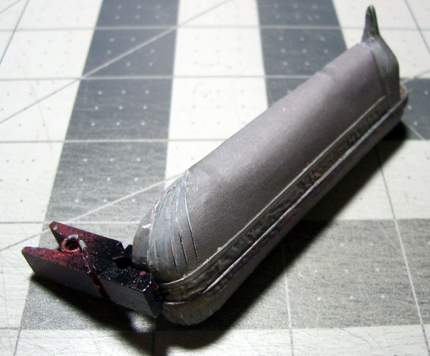

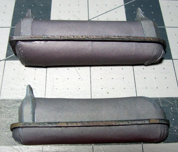

The upper skin complete. The bottom skin has been cutout and ready to install below it.
The lower skin being prepared.

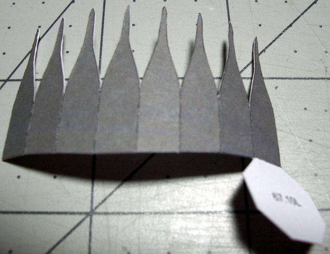

The end of the skin needs to be glued one frond at a time to make sure it gets the right shape.
I built this off the structural assembly first as I found it much easier that way.
The 2 smaller caskets with their draft paneling in place.

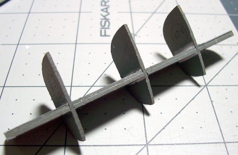

Again, double layer for the center backbone, and single layer for bulkheads.

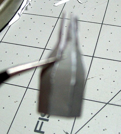

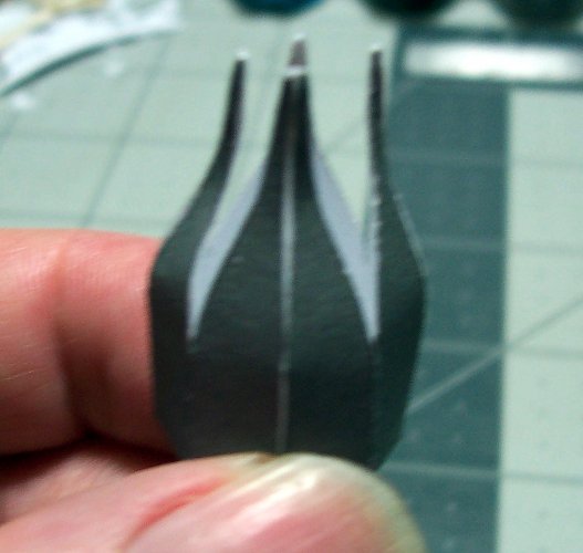

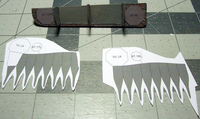

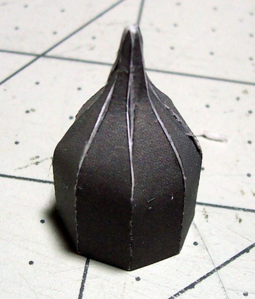

These are the 2 turrets that need to be cutout and built.
The following is a step guide for building and gluing the turret.
Finally glued and ready. There are zero tabs on this model so be careful to butt-joint the edges accurately.

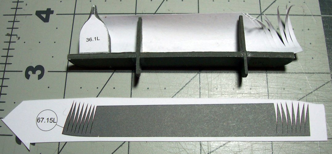

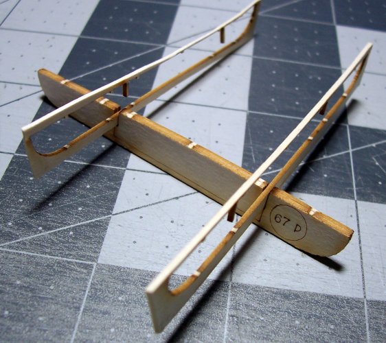

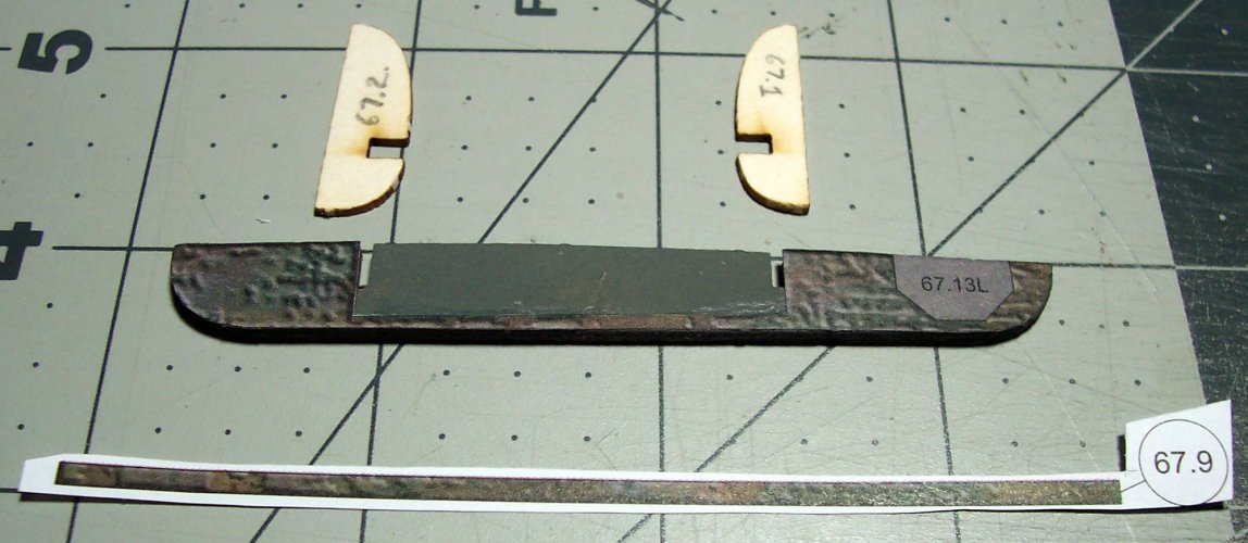

Continuing on with the storage caskets located on each side of the stern. As mentioned before, these are somewhat difficult to make but with the aid of these photos, it should help quite a bit.

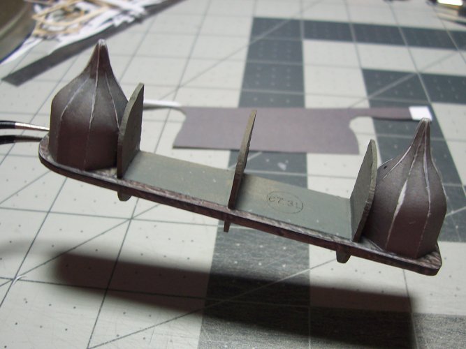

Make sure to get the towers in the correct orientation. Look at the angles of the tips of the towers to make sure they are angled as needed. I found it a good idea to carve and sand the joints to make them smooth to assist with adding the planking later on.

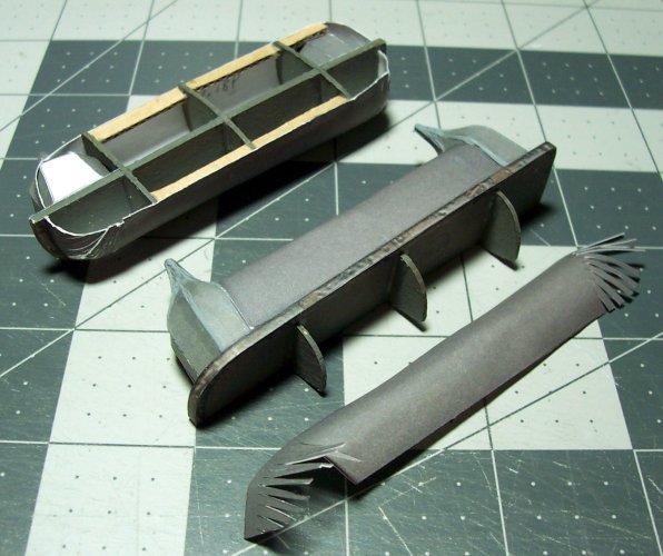

The upper skin is a good guide to make sure you have everything else installed correctly. Just tack it on the inside a few places to hold it in the correct fashion.
There are a LOT of curves on these caskets! They must match the places for them marked on the sides of the ship. I found I needed to stop the sides of the caskets pushing in on the long runs. This could make them look very bad. So, I used some scrap card to add some formers to the edges as required.

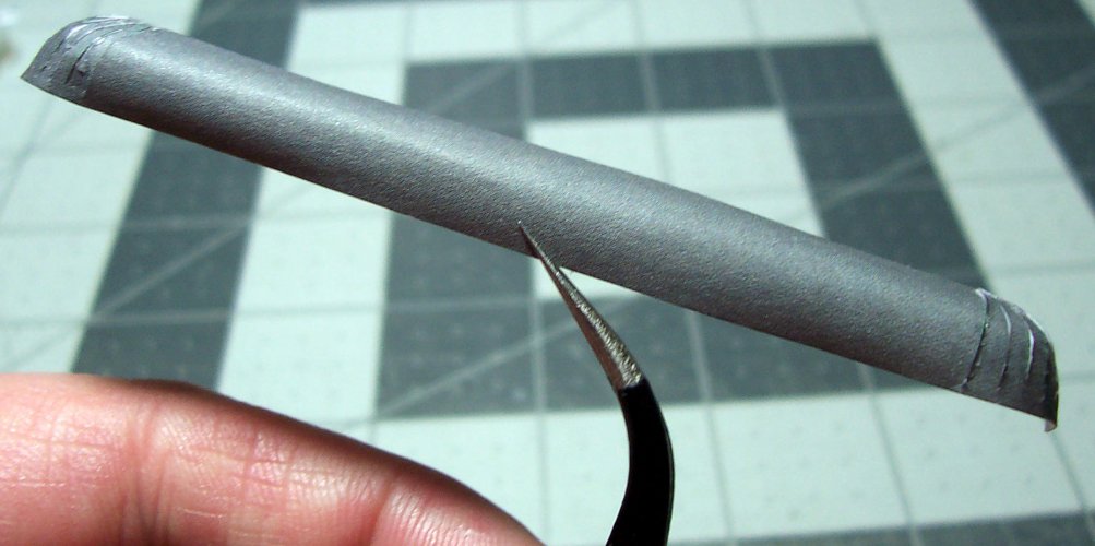

It is necessary to get a bit medieval on these things to get them to conform to the right shapes. I slit the skins where necessary to get the correct curves. This is the same for the bottom and the top skins.

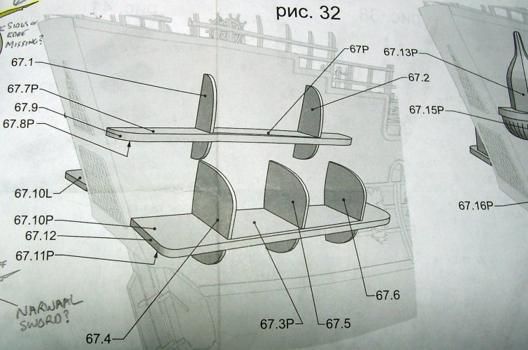

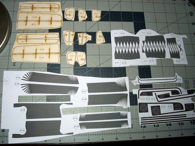

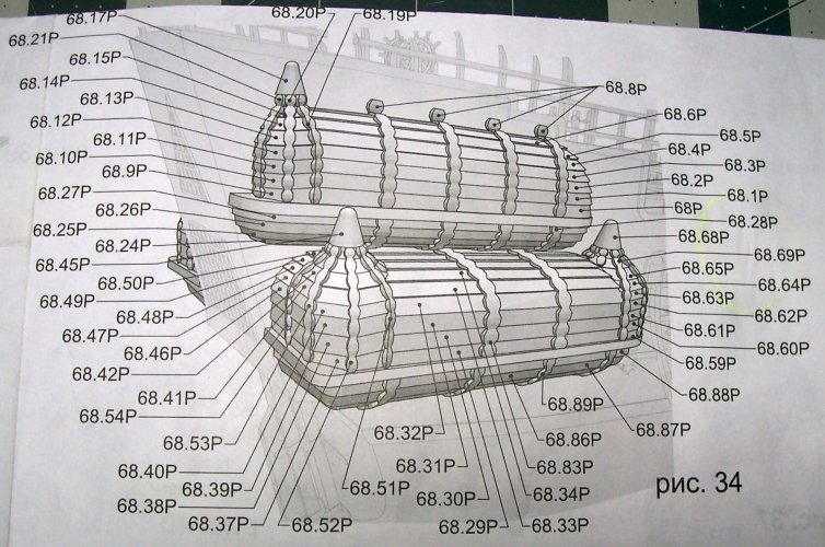

This is the plan for the Caskets Assembly. There are several minor issues on the plan but nothing too drastic. There are a lot of parts that are not actually shown here? Its not too hard though using some intuitive knowledge once you are in the zone.

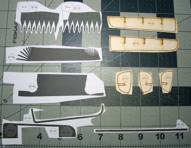

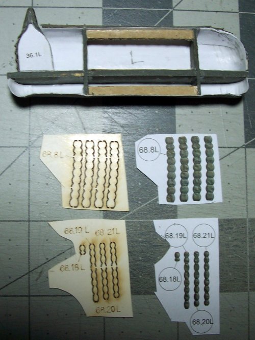

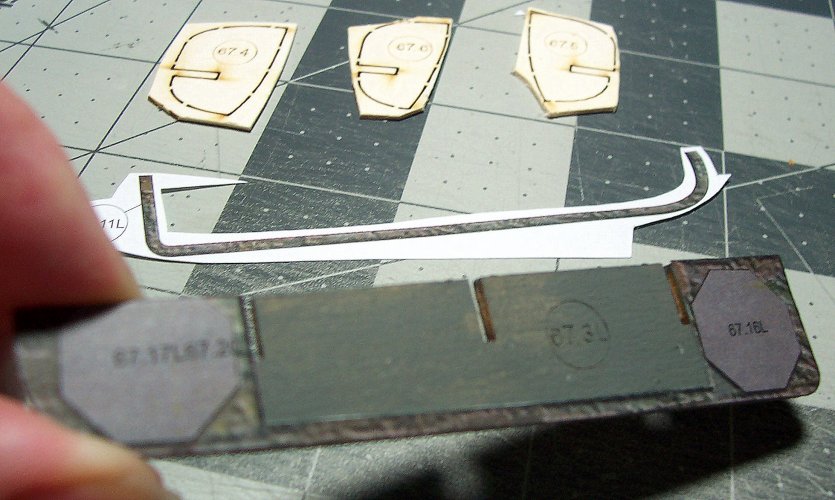

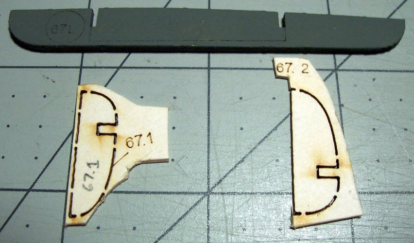

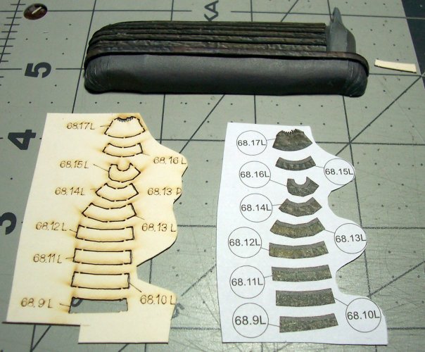

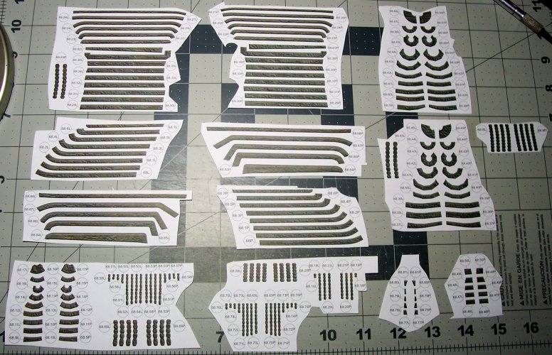

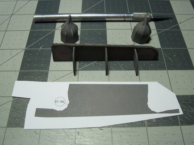

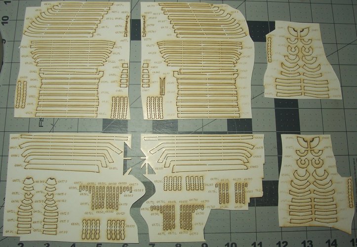

These are all of the cardboard parts for the "soft" parts of the caskets. Note that these are laser-cut for accuracy.

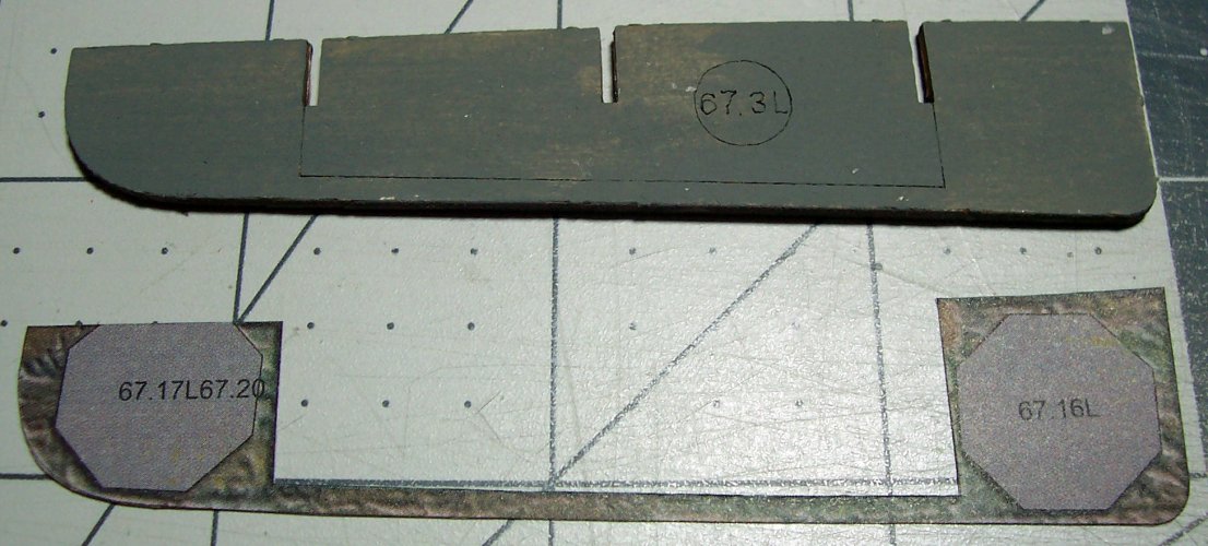

These are the color veneers that are glued onto the card pieces in the picture above. Its pretty much a one-to-one card for color veneer. These all require cutting out of course with the new scalpel blade, and small sharp scissors. Just work on one part at a time.

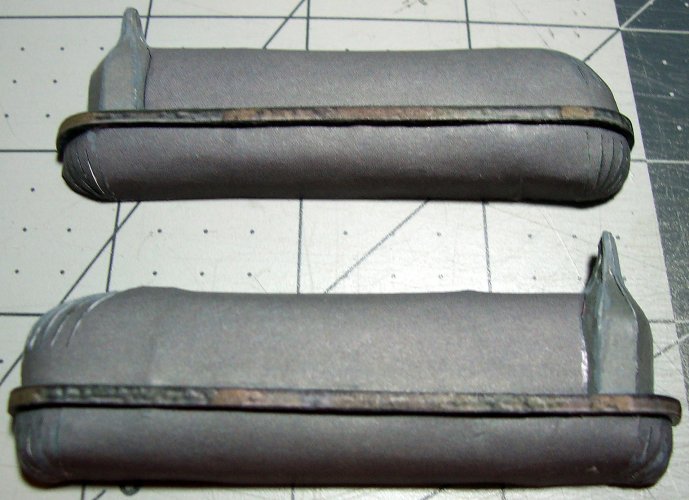

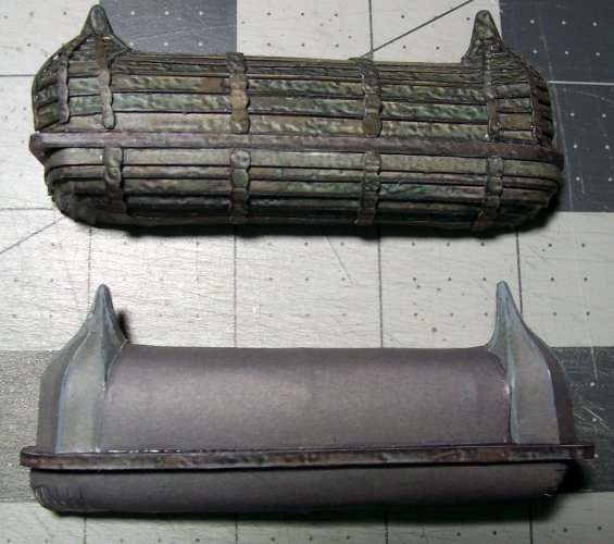

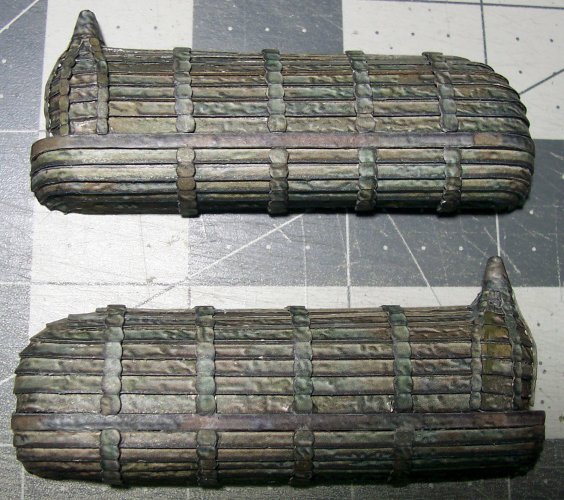

The photo below show the two starboard caskets completed. The ones on the right are for the port side of the ship which I will go over in more detail in the following explanation.

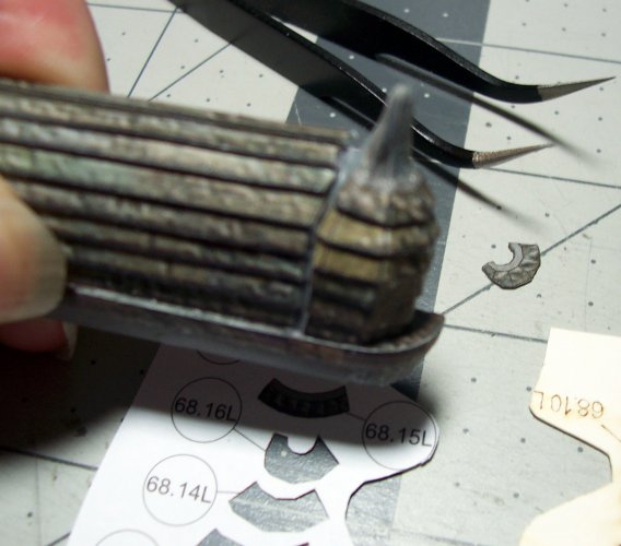

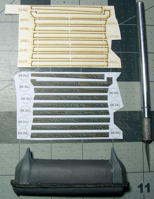

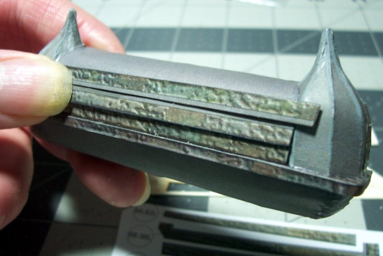

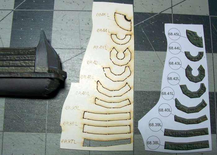

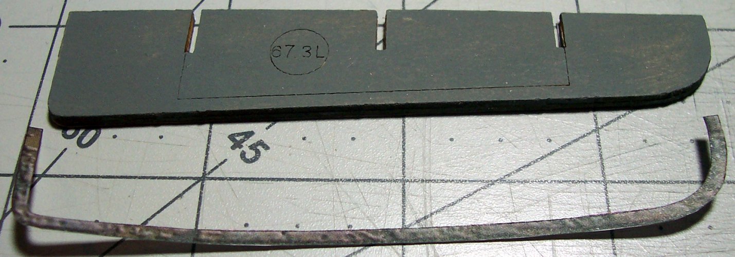

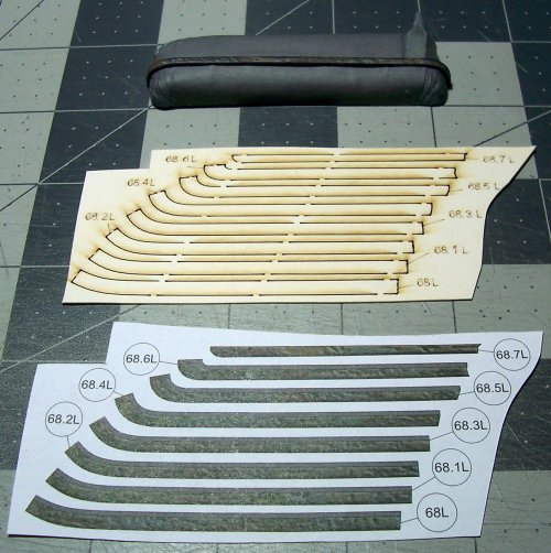

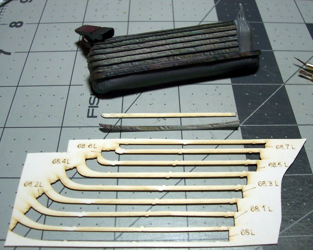

These are the upper planks that go over the draft paneling. Parts 68L through 68.xx L. These need to be pasted together one at a time following the numbering sequences.
The first one that is fitted is on the bottom edge. They do require pulling and pushing to shape. I used some small clips to hold them while the glue dried.
Working the way up to the top of the casket. Note that the planks overlap on the upper edges. Do not cut them down! If there's a problem with them fitting, fix the shape of the casket. I glued them first in the center of the plank, and then the edges one at a time.
All of the upper planks in place! They start to give a nice affect to the casket, and add a LOT of strength!

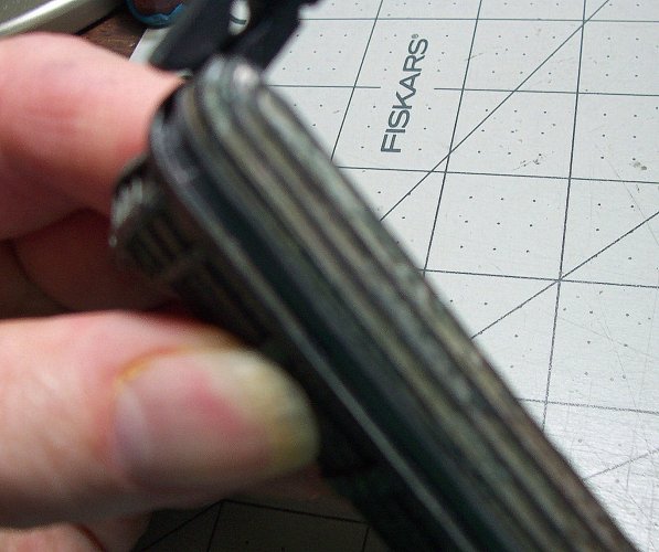

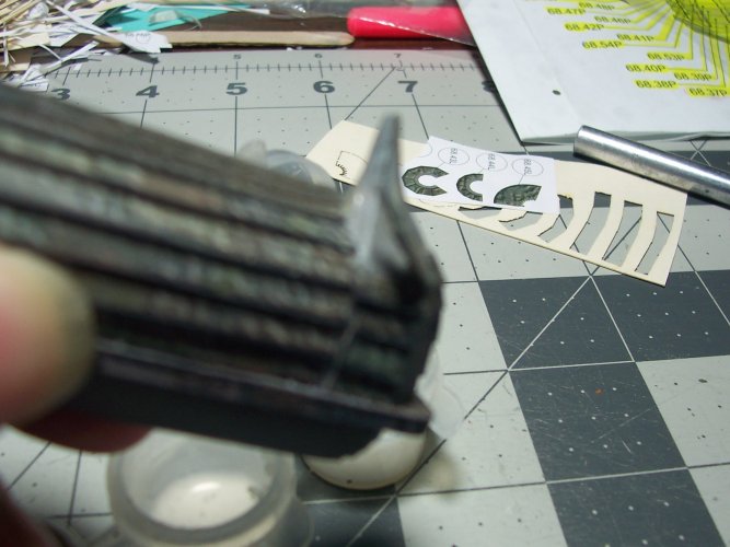

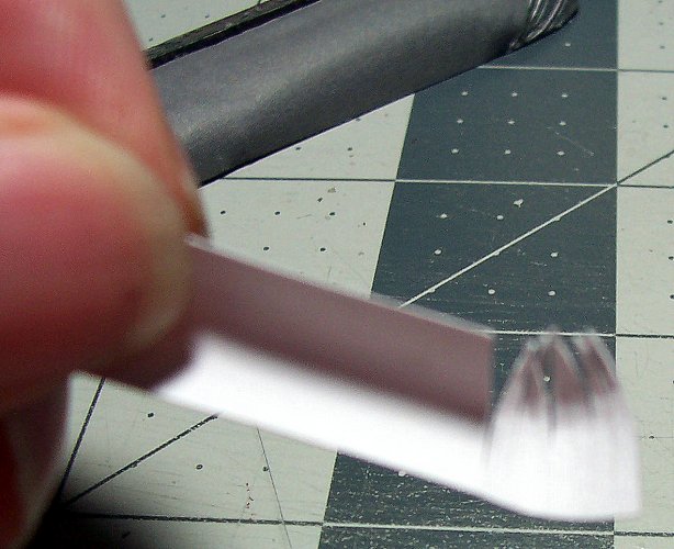

You can see that its easy to distort the shapes of the edges as you hold the part in your hands. I packed the corners with small pieces of tissue rolled into a ball later on.

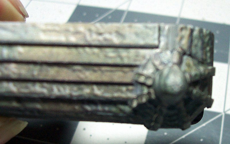

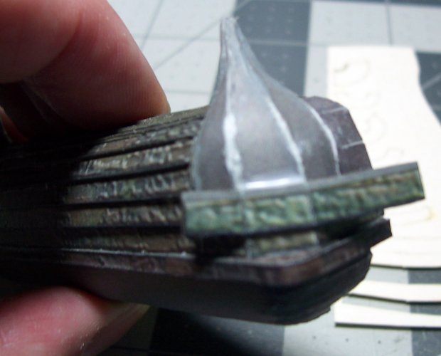

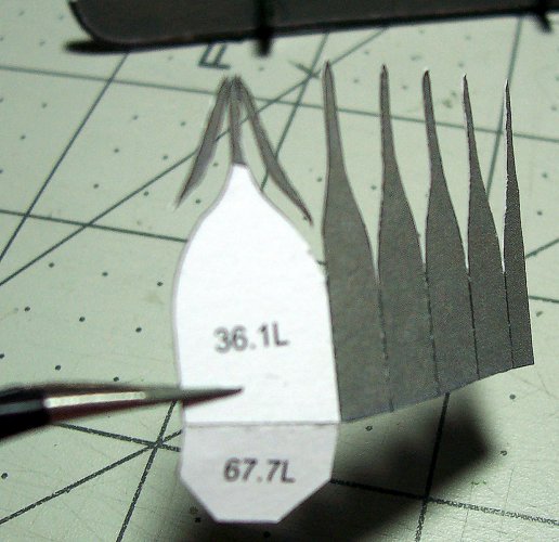

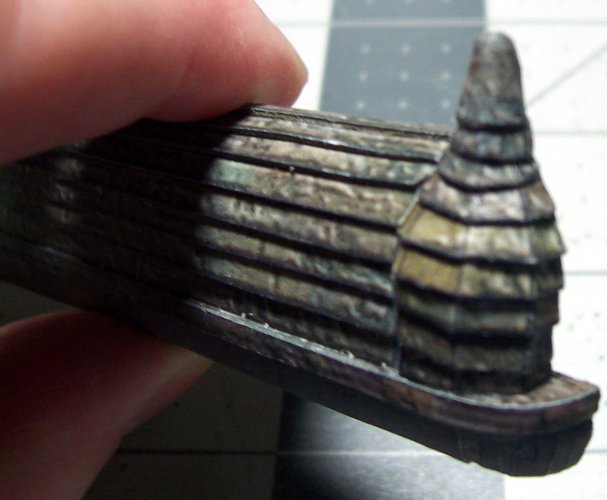

Now we add the planking to the turret. Again, just do one part at a time! This is critical to avoid all kinds of problems.
These are the first 6 parts in place. I found it easier to score the fold lines on each of the parts where needed. And then pre-fold them to shape before you glue them in place.
I carved and sanded the turret at the very top to allow a better base for the final top "cap".

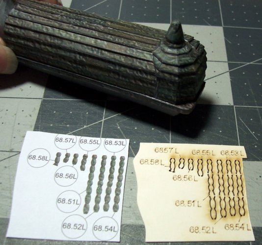

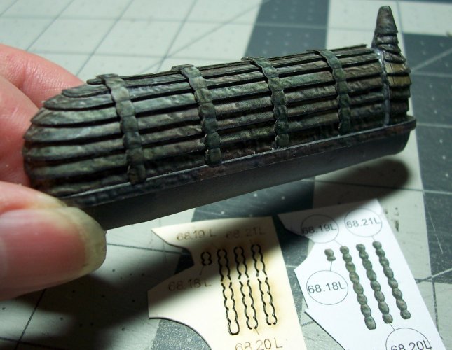

This is the rear view of the casket showing the progress so far. Also, there are the four straps that will go around the body of the casket on the upper section.
I glued the base of the strap first and waited for that to dry before gluing the rest of the strap. Note too that the straps have different ends! The short stubby round end goes to the middle of the casket in all cases.

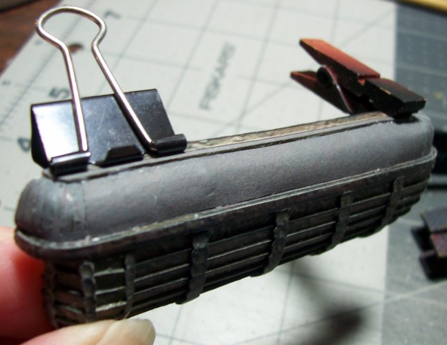

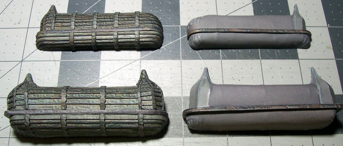

Continuing with the rear storage caskets construction. These are the upper straps in place.

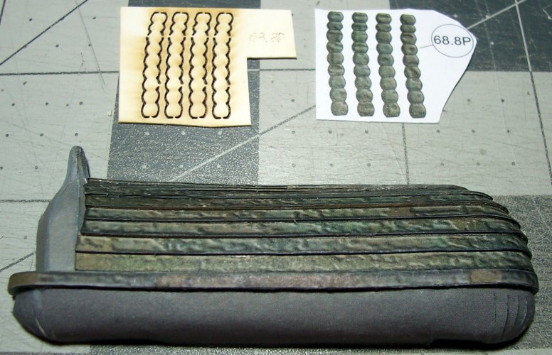

Now, its time to install the bottom planking details over the draft panel skin.
Because the bottom planking starts at the bottom, you will need to glue the plank in the center of the casket. Its critical that this is measured accurately or it will throw off the alignment of the rest of the planks.

Also, these are the reverse sides. That completes these two for now.

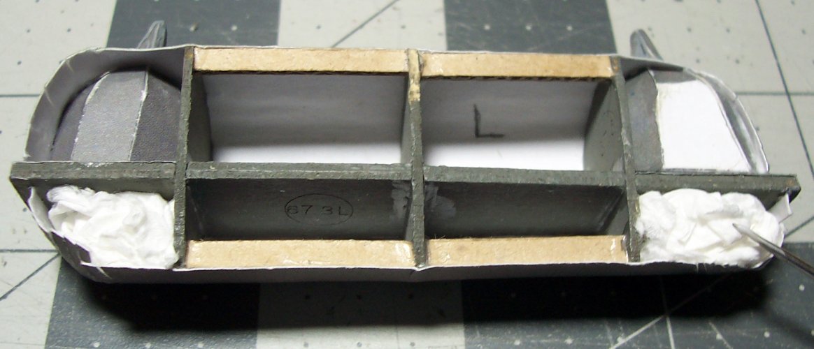

Here's the tissue wads to prevent crushing on the edges while working on the planking.
