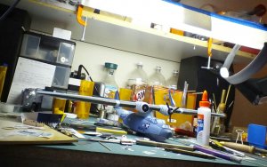

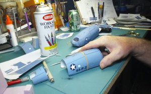

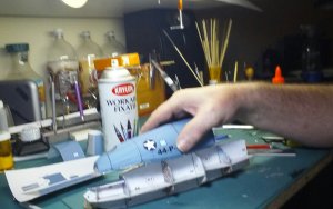

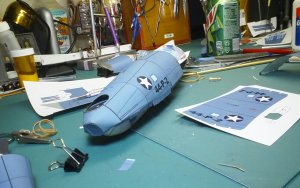

I jumped into this model with little building building before hand. Some of this has taken a lot of time and trial and aire to my surprise some of it works the easy way better then the hard & a lot of effort way.
I am once thanking zathros for turning me on to the paper I needed.
I discovered the way to making straight trailing edges and a tail cone with no creaceses

Those parts are incredible done well!! You've got it nailed. :)

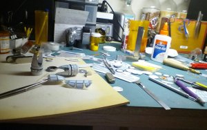

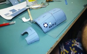

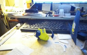

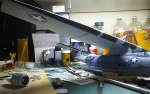

Engine and blister work proceeding The blister seems to be harder then first thought
I will be at this one to completion I really do not under stand why in the pic's thereKINDLE_CAMERA_1422688689000.jpg KINDLE_CAMERA_1422739507000.jpg is color shift in panels

The blister looks great. Personally, I would have cut the panels out and tried the frame with clear tape as windows, or heated up some plastic. If you make a paper blister, then use some two part epoxy, you can use the paper blister as a mold for the two part epoxy putty, then heat up some plastic over a candle and stretch over the mold. However, yours looks so good , and it fits the rest of the model, which also looks great! This isn't an easy plane to build. It is one that everyone recognizes though and yours is unmistakeably a Catalina! :)

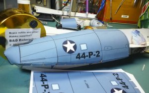

I agree with you about the blisters they would look quite good see through.
Starting out I thought about it and all windows see through, I decided to build this one as is and learn then tackle the stretched glass on a other model. I started this thread along time ago and should finish it and move on. There are a lot of diddle parts with this one, I am not sure how he intended the air intake to go on and strut fairings are the first thing removed (next to wheel skirts) and not put back on ever. Looking at the pby pics I only saw one.KINDLE_CAMERA_1423238971000.jpg

I think those wheel fairings where a liability, which is why no one used them. The model looks great!! I have to build me one of these. There was a beautiful at the New England Air Museum, but a Tornado took it and some other irreplaceable ships from us. It was a real shame. These models are a way of keeping history alive, and a lot easier to show to your friends and family, and give short historical blurbs. You would be surprised how many people do not know it was one of these Catalina aircraft, "Strawberry 18", I believe, that spotted the Japanese fleet and gave us the edge at the"Battle of Midway". There was no other craft that could have pulled that off. Being able to handle representations objects present at such pivotal moments makes them so important, IMHO.

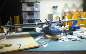

Well I believe it has been more than a year,two printers three different inks and a bpy that looks a mess as far color. Most of it is different in the camera then to the eye. I jumped into a model that was above my skill level made many mistakes but learned a lot I did not learn to stay a way from models above my head!!
