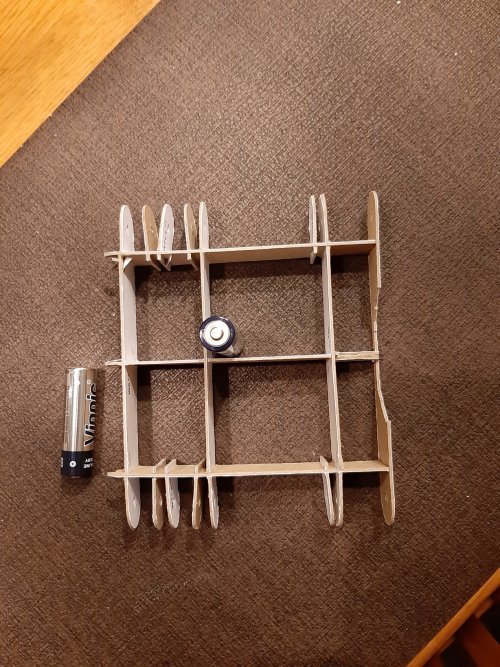

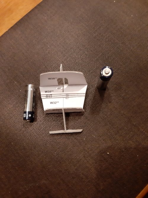

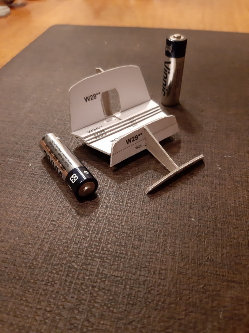

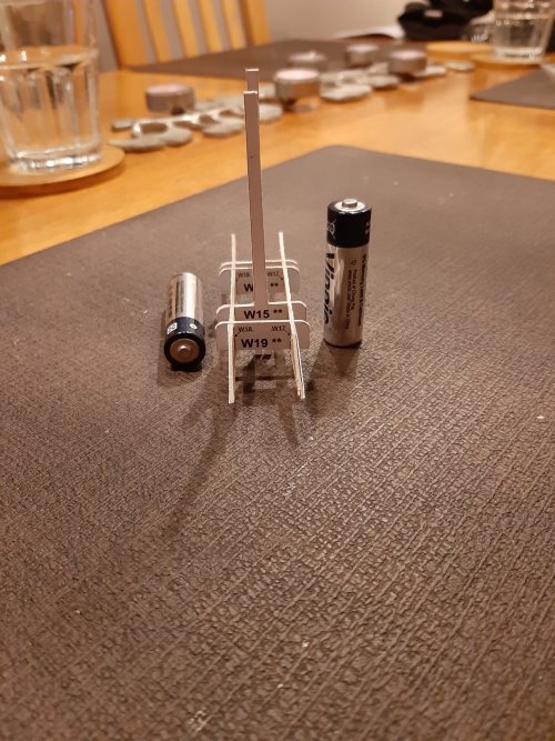

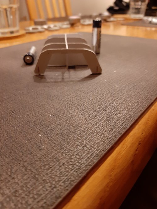

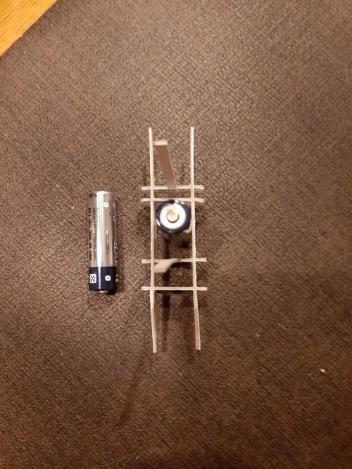

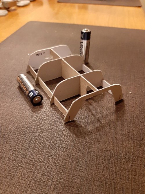

Quite a lot of structural support in this model - some models you get nothing, and this has tons!
Cheers for adding the batteries as a size guide too, much appreciated

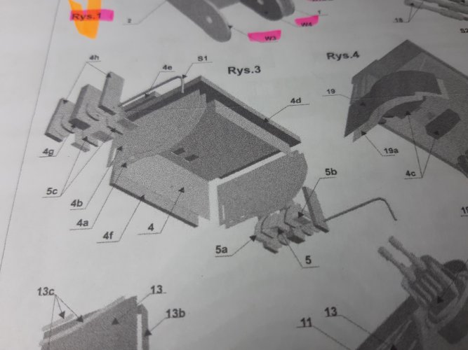

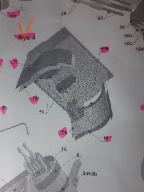

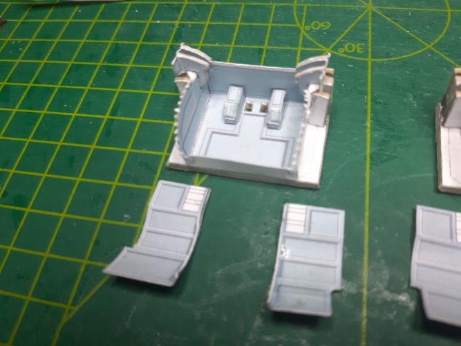

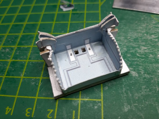

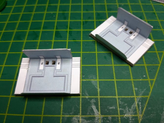

Following the instructions this time we need to start building the landing gear.
First step are the wells below the parts needed.

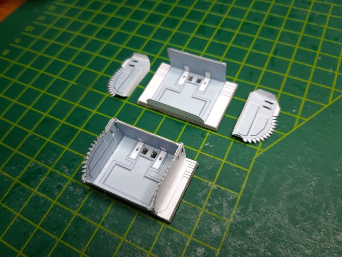

Following the instruction you will end up with this.
Cut and assemble the side.
Glue the sides.
I have used clamps to hold the tabs in place.

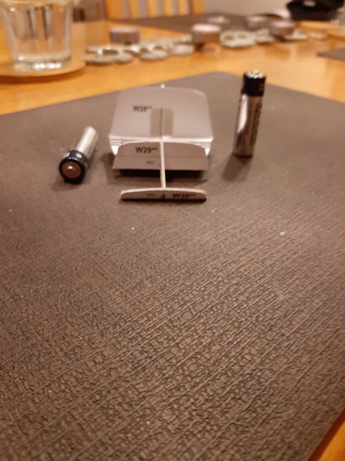

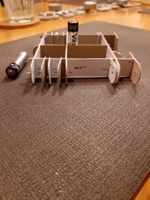

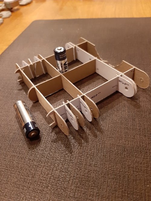

Im thinking to add some LED to this model I think I have enough space in the frame work and maybe in the wings.
I will take a good look when I assemble the rest.
And yes I already have the AA batteries Chuffy!
You do indeed matey, go for it! Could prove an interesting challenge
Reactions: mijob
13,502
9,558
Looks great. Make sure when you look down from the top, all the formers are exactly symmetric and are 90 degrees! :)

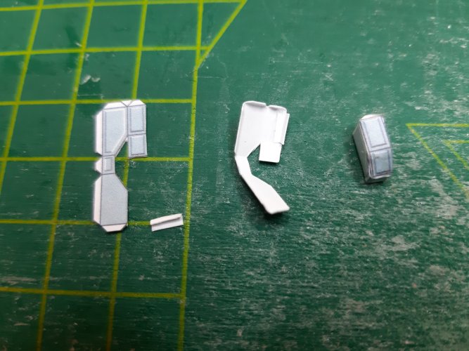

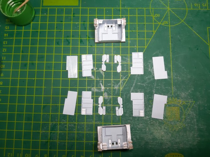

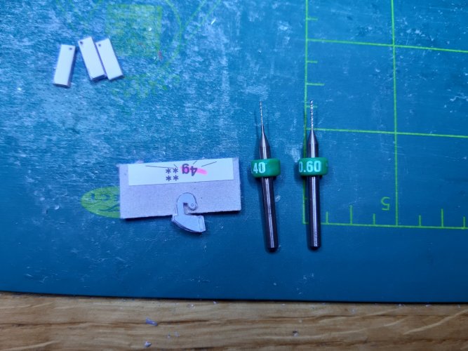

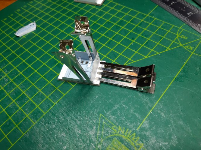

Time to make the landing gear hinge.
In advance I can tell you its a bit of a challenge to figure out to assemble it. But after a few hours I made all four hinges.
Lets start with the parts that you need to cut.
Then score and fold the parts.
Then assemble the parts as shown in the instruction. It was a pain to figure it out.
Next up drill some holles. I used 0.4 and 0.6 mm drill. Between the drilling I used extra glue to get a cleaner holle.
Then attach the hinge to the side panel of the well.

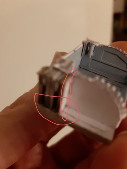

For a working hinge we need a 0.5 mm metal rod and form it. To form you can use the template.
After this place it in the parts to make a working hinge. Use plenty of glue to hold the parts at the side of the well panel. See red circle.
Yust only the side and the lower part. Otherwise the hinge will not work.
If all went good you end up with two working hinges.

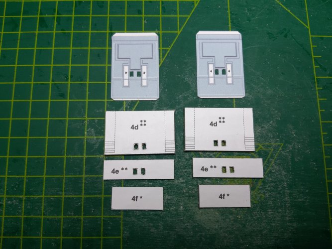

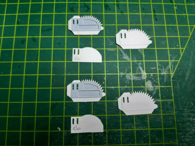

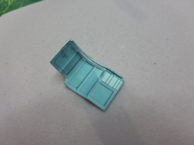

I made the landing gear doors.
The parts that you need to cut.
Glue the door halfs together and preform them.
Glue the side part on the doors. First glue the part at the top. After a few minutes you can glue the rest.
This part will be glued into the well. score and fold the lines. I have used an ectra gluetab to make the assembly easier.
All parts are done. Dont glue the doors on the hinges yet..
