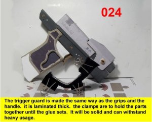

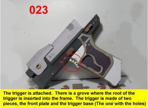

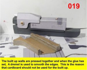

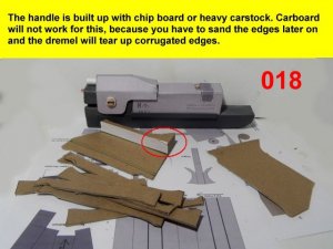

So here is the first installment on the build thread. The beginning does not look like much but the changes to the model are apparent. I wanted this model to be able to withstand kid power. enjoy and see you all soon with more.

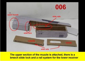

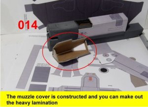

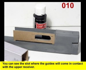

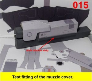

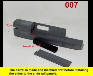

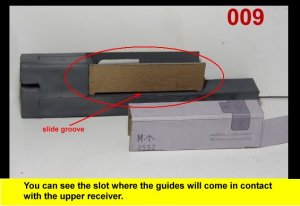

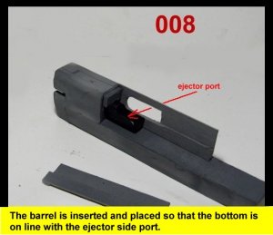

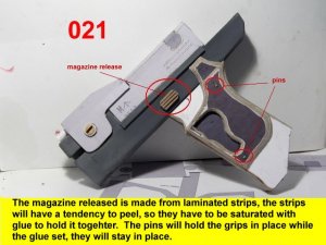

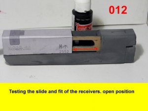

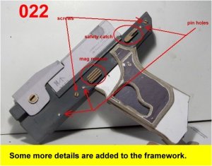

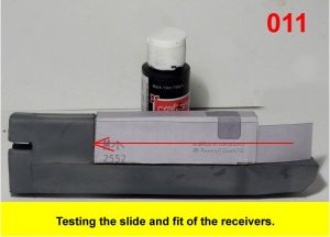

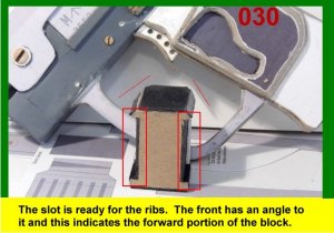

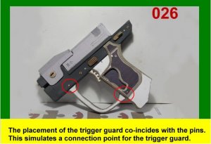

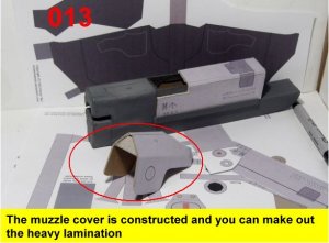

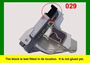

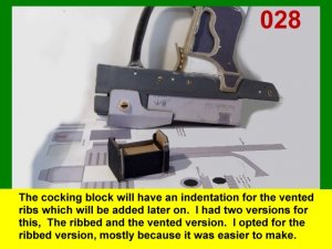

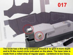

Here is another batch. As you can make out from the template/plans/diagrams. the upper and lower receivers have been cut apart and made into two separate build sections. That nose muzzle has a slight curve to it and the inside support had a notch cut into the bend before the skin was added. If this is not done, the muzzle nose will have a hard time staying in place. Enjoy and see you all soon with more. One item I did not circle in the photos, is that I cut away a section of the upper receiver to accommodate the Muzzle cover.
The gun is finished and my grandson wants it now, but I will make a stand for it for those of you who may want to display it.

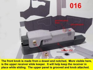

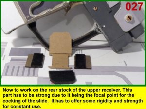

Here is the next batch of photos, this time on the cocking handle for the upper receiver.
