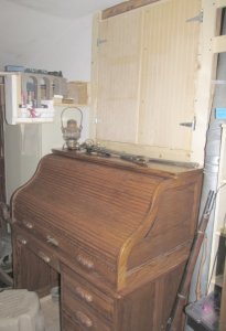

    ASL_A1 attic acces  doors #1.jpg progress on the attic access
    I got the Attic access hole framed in most of the way (I need another 1x4 to complete) and I cut the doors down from the paneling I had used to cover the hole. The paneling is not in great shape; and I considered replacing it, put I used the old paneling cover over the access as a bulletin board, and will probably do the same with this one.
    I got one of the doors hung. Sadly I did my hardware shopping after working a graveyard shift, and besides not figuring the 1x4 requirements correctly, I did not realize that the T hinges I bought were one per bag, not a pair, so I will have to go back for another 1x4 and two more hinges.
    In the photo you can see the desk, and the newly framed opening to the north attic. to the left of the attic access is the narrow gauge return loop @ Gegokayoosa, under the pile of Styrofoam and you can see how close to the ceiling it is. to the right of the desk you can see an exhaust flue for the gas fireplace in my family room. Next time I have some sheetrock scraps I need to fill in the hole in the wall above that flue.
    It used to be really hard to get into the attic here, as one had to go up a ladder, and remove the paneling cover. with the desk there, I can climb up the desk, and open the doors. Next I will have to reorganize in the attic to make room for parts of the railroad as I start to tear down and rebuild a large portion of my RR.

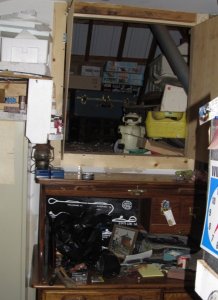

    ASL attic  acess  #1.jpg into the 2nd level of the attic!!
    My house is a split level, with the original 1870 portion having 12 foot ceilings. The previous owner had added two rooms with an 8 foot ceiling. when we added to the house, we removed the wall between those two rooms to make a large family room, and tore off the roof, and built another matching the old house's roof line, creating what is my railroad room in the resulting attic space. from the ground level we added stairs down to a garage, and two bedrooms and a bath for the kids above the garage. the attic access I have been working on is above the kid's bedrooms.
    I got the other side door on it's hinges, and went up into the attic, probably for the first time since we had a new metal roof installed. it was dirty as heck up there, but I got stuff moved around, and looked into the boxes and trunks that were up there to figure out what was stored up there. there was a big steamer trunk tat is empty, so I can use it to store some of my more valuable goodies up there. I have to take down about three large trash bags of **** from up there, and sweep it up (it looks like unknown animals have been doing unspeakable things up there), and then I can start moving my empty boxes and chunks of styrofoam up there. and free up the space in my RR room so I can move around to start tearing things up.

    ASL A_1a dsk & attic door  #3.jpg doors hung
    I got the doors hung on the attic opening, and some 2x4s cut to fit under the desk to raise it up, so I can fit a power chord under it, and route wires under it to go to the layout to power the blocks.
    I started to load stuff up in the attic, starting with the Styrofoam that was stacked on the narrow gauge return loop @ Gegokayoosa, so I can get trains up on the loop again.

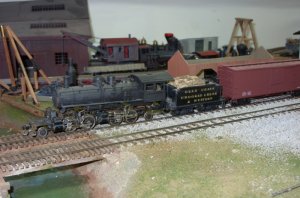

    21 .jpg love them 2-4-4-0s
    QUOTE=Doctor G;963982]You are right Little River #148, the unique Baldwin 2-4-4-2 ,is a beautiful engine.
    Tom[/QUOTE]
    Looking through my logging books, when my folks moved from Ohio to Georgia when I was in High school, the pictures of the Little River was one of the main inspirations leading me to place my Railroad in Tennessee, Years before I would end up in college in the mountains of Tennessee myself.
    In Atlanta, in the early 1970's I picked up my first #148, my #21 and ancient Gem import. it is a stunning model, but was a mechanical mess, with years of work, I got most of it's issues squared away; it is still very noisy due to some spur gears, but with a powerful can motor, some suspension work, and lots of weight it is a hoss.
    My second # 148, my #22 is an Overland power plus locomotive. it is a composite locomotive, with a die cast boiler and frame, and brass details. It is a fine looking locomotive, but it's detail is not quite as fine as the Gem model. On the other hand, is has an excellent mechanism , very smooth and quiet. Due to the fact it has a cast metal boiler, It can't be loaded up with lead (or tungsten) to get it's weight up. I may be able to make some suspension changes, but I need to study up I have not figured out how to disassemble it. there is an article in an old Timber Times, a logging modeling magazine, that I need to get a reprint of on improving this locomotive, It runs so smoothly I'm hesitant to touch it .
    One issue with these locomotives is looking nearly identical, they cannot be used in the exact same capacity, as #21 can pull twice as much as #22 . Once I do my rebuild, and these locomotives have room to run, I will probably put #22 in passenger service, letting #21 do freight and mixed trains
    in this photo #21's nose is a little high, this is due to a spring that puts weight on the front truck. when I bought this model there was no weight on the front truck, and It could pull four cars on the flat. I installed the spring, and packed the boiler with lead, and it could pull 28 cars up a 2% grade. this is an old photo, as #21 and # 22 have red roofs like most of my locomotives, also it needs a good dusting in this photo.
    at some point it will loose it's wood load, as I'm converting most all of my main line power to coal #1 mt primordial antlered 4-4-0 will remain a woodburner.
    when I build my new plan I'm going to have to put some wander in my long straight tracks, so I can see the 2-4-4-2s do their little dance

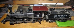

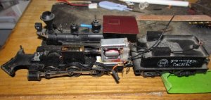

    ASL A-1 M's Pm #2.jpg ASL A-1 M's Pm #1.jpg and now for something completely different
    My Mom's ken Kidder Porter Mogul has been in my shops for some time. I got a gear reduction motor in it, but that was too slow. This small open frame motor would almost fit in the cab only sticking out a little. the original motor stuck out, and was so old it was a three pole motor.
    Not sure where the motor came from, I had a similar motor out of a Hornsby OO Thomas, but that one went into a 2-4-2 I'm working on as a M&NG standard gauge switcher / interchange engine for State Line.
    The motor is noisy, but has very good slow speed control. I have some improved electrical pick up on both sides of the locomotive frame. the tender pick up is awful, and my attempts to improve it have either not worked or messed up the truck equalization , so that is something I can work on.
    I was cleaning up my work bench and found some tiny NWSL cardigan cups. the shaft on the motor was much smaller than the shaft on the gearbox, and the NWSL cardigan shafts were smaller still, so I drilled them out to fit the larger shafts. hooked directly to a power pack the slow speed control is great, as soon as the pick up issues are sorted out it can go to the shops for a paint job to become a very low numbered DG CC & W RR locomotive #1's number is safe, but I may bump #2, #3, or #4 out of their spot. #4 would be easiest, as it is a class A climax that is numbered, but not lettered. I could easily transfer it to the Strong and Perry Lumber co. to open a spot. Hopefully this locomotive will run well with a locomotive with a freight pilot on it, cause even a 3.3 percent grade will severely limit this critter.

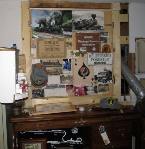

  16. Bill Nelson
    Bill Nelson Well-Known Member
    Dec 15, 2008
    2,448
    148
    A     IMTD  SS &  Tckwy  rmvd.jpg A     IMTD   Mtgmry frnce gone #2.jpg A     IMTD   Mtgmry frnce gone #3.jpg I have been contemplating a major rebuild of my railroad for a long time. I have taken a lot of time with the redesign process, as I really like the looks of my current mountain. My rebuild will give me a much longer run , and will allow me to use my Valley division ruling grade as the ruling grade for the entire main line. My Mountain division currently has 8.5% grades. so this rebuild will allow my rod locomotives to run trains on my whole system. 28 years ago , when I started this railroad, I had only one excellently running rod locomotive, and six or seven excelent running geared locomotives, so the steep grades were not a deal breaker. in the m ean time iI have rebuilt a lot of my rod power, and improved their running capabiliities emensely.
    My new plan will use a helix in what used to be my dispatcher's nook to get the required altitude gains needed for a five level rialroad. I started tearing out my railroad in the south eastern corner removing Ridgemont Tn. on the top level, Montgomery Furnace on the level below that, Tuckaway ( a log camp staging yard below that, and, below that my Southern Staging yard down below that. all of it gone in an orgy of destruction.
    I hope my spelling isn't too ban I'd dislexic, and I think my spell checker switched itself to German, as it thinks everything is misspelled, and the sugested replacement are not english.

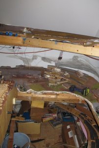

  17. Bill Nelson
    Dec 15, 2008
    2,448
    148

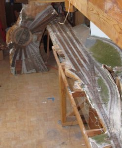

    ASL A-1a  back aisle.jpg ASLA_1 once and future harlow yard and EF.jpg Asl a-1  Gzrd corner bare.jpg ASL A-1a  attacc bul brd.jpg ASL A-1  blt brd ovflw on dr.jpg I have made serious progress, the south east corner is clear, and I have even cleaned the floor. I have separated out the plywood under the Harlow engine facilities, so once I know exactly how I can re ruse it, I can trim it to fit. the curved cribbing that was along the back side of the turntable, I was able to remove in one piece , and I'm hoping to modify it and use it behind the turntable in State line.
    I have started work removing the Harlow yard which currently consists of three yard tracks and the main, with a little passing siding at the yard throat. In the next incarnation this yard will be up against the east wall on a shelf, with the main off on the center peninsula. I'm going to use the former main as a caboose and coach track.
    the top level of the central peninsula, Perry's gizard was started as a modular section, and had the track and some of the scenery done when the last incarnation of my railroad was started. It was built originally as a companion piece to my Bumpass module, originally in a rental house, and then in a trailer (both in Nashville); then it was in a back bedroom of our farmhouse when we were able to move back into our farmhouse full time. So when it was raised up into place in my new attic space when we added to the farmhouse, it was the Gizzards fourth time as a part of a railroad. As soon as I put it up there, maybee twenty three years ago, I started using the tall fashia of the layout as a bullitein board. Just this last weekend, I moved all of the stuff off the outside corner. most of it I re-posted on my new attic door, and on the door to the railroad room.
    Next I need to do some cleaning and organizing in the attic, and then box up the stuff on the shelves on the east wall, so I can build new shelves on the east wall to carry several levels of track, with some passing sidings to use as staging, so I can operate Crooked creek as a humongous switching layout, while I tear out my center peninsula, where my best scenery is. it will be easier to do now, as the tracks no longer go anywhere.
    Nelson

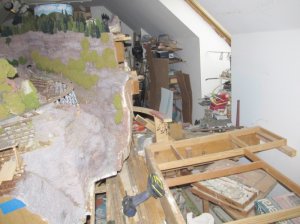

  18. Bill Nelson
    Dec 15, 2008
    2,448
    148

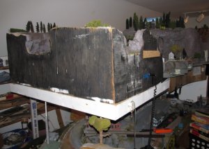

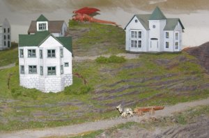

    ASL A-1a  Smaugs new home #1.jpg ASL A-1a  Smaugs new home #2.jpg Scrap  wood  from shelves behind  harlow.jpg.jpg progress, and habitat destruction
    Well the Harlow yard is out, and the bridges in Terrapin are out. I have removed most of the trees off of Terrapin, Sander's ridge, and Perry's Gizzard disloging that area's largest inhabitant Smaug.
    I had classified Smaug as a Red-Gold Dragon, But Dr Tom, being a very well educated guy, was able to come up with a much more specific identification. On his first trip to visit my RR, well back before the beginning of recorded time, Dr Tom Quickly spotted Smaug, perching on the highest rock outcropping, as is his want; and Tom said; "Look there is a common, ordinary, everyday , Tennessee Mountain Dragon", and so he is.
    Well The trees are coming off of Terrapin, Sanders Ridge, and Perry's Gizzard. while Gegokayoosa has plently altitude, there, as of yet, are no rock outcroppings up there, so Smaug has descended into the valley to take up residence on the tallest remaining rock ledge not slated for destruction ( Smaug is a forward thinking creature); which happens to be in Tom's Bend, the high rent end of Crooked Creek. for the first time in over 25 years Smaug has neighbors. If you live in Tom's bend, be advised, your insurance rates are going to go up steeply.
    in other news the shelves behind Harlow are all removed. I had three boxes on those shelves that had strip wood and other useful wood scraps that I consolidated into one box. ( I have lots more scrap wood elsewhere, much of it way to long to fit in this box

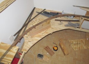

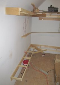

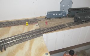

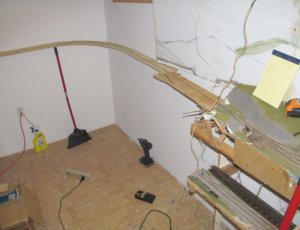

    ASLA_1a  NW  SL  Shelves.jpg ASLA-1a  nw  lftout  joint.jpg new benchwork up
    I put up some benchwork on the southeastern corner of the RR room at the state line level, which is the third level. I have put down a small section of narrow gauge in the back to test the fit of the south attic acess liftout. on the liftouts corner, I made a transition from code 70 dual gauge track to standard gauge code 83 track.
    I have the first switch in for the ore transfer, which is going to be smaller and more cramped than I had hoped, but it should be mare opperable, and look better than an earlir plan that allowed for larger facilities.

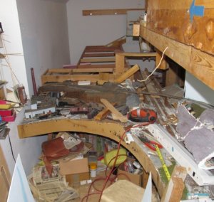

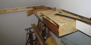

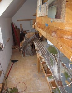

    ASLA-1a  CC LV  SE cnr.jpg ASLa-1a se corner  clean.jpg ASLA-1  lw bnchwrk.jpg ASLA-1a   test fit bridge.jpg new progress in the SE Corner
    I did some reorganizing in the attic, which made space for a lot of the stuff that was junking up the aisles, which makes it easier do do stuff. ; also with the SE corner completely clear : I had some big sterio speakers and a pile of lumber in that corner.
    with the corner cleared out I put in some very low benchwork for the lowest level, comming off of the passing sidding at murray, which is tucked under Crooked Creek the bottom end of this siding used to be level, but I reworked it attempting to match the grade in Tom's bend, which if all goes well will be the ruling grade for the entire mainline. I put the benchwork way low, as this plan will lack for places for deep scenery, where the scene extends way down below the grade line, as on the upper two decks, that will impinge on the deck below. That isn't a problem on the lowest deck So I droped the benchwork way down so I could fit a tall bridge, and the tannery that used to be on the backside of Harlow.
    I also test fit the corner shelf for the Crooked creek level. it will be a very narrow shelf set back as far as possible, so as to not obstruct the view of the river crossing. As I ran the crooked Creek level track, it exposed some errors in my altitude calculations and or assumptions, if the crooked creek level climbs all the way down the wall it will be too high for Harlow, much less the Southern staging where I was hoping to tag it in. So it will climb more gently, and land directly in the Harlow yards. this will shorten the run considerably, but greatly simplify the Southern staging level. this is a lot of fun, I could be actually be working on some scenrey soon, as I like to do scenery around bridges early, as you can really mess up a bridge doing scenery around it. much better to build the scenery first and fit the bridge to it.
    The third photo gives an idea of the intended seperation between the levels, I'm aiming at aproximately 18 inches between the roadbed level and the bottom of the benchwork above, hopefully I can make that taller at the lowest level so the mid level doesn't block the view as much, and I may be able to get away with less at the second level . there is only a four or five inch seperation between the eye level at state line, and the over the head level at Gegokayoosa, but being eye level , and very skinny one can see in that hole very well (unless you are short); in which case gool luck trying to look at Gegokayoosa, where a six foot person needs to stand on a milk crate.
    I need to get back to the lumber store, I'm about out of the plywood I used for roadbed, and I have thirteen feet of shelf to do on three levels. Boy howdy this is fun. sadly no power to anything yet, as soon as I have those three shelves in, I will try to start hooking up some power to the remaining blocks and the new ones, as from the new Harlow TN. yard to Sander's Switch TN. on the level below it through Crooked Creek TN. , and Murray TN.; I will have over 53 feet of main line, without getting to the center aisle, the helix, or the upper standard gauge level yet. This has been painfull up till recently, it is starting to be fun.!
