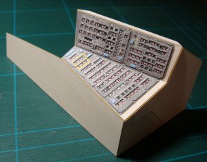

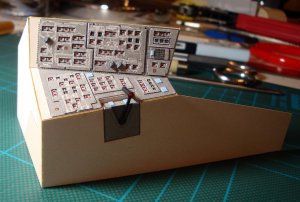

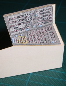

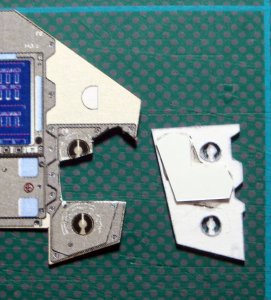

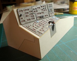

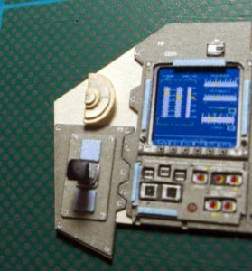

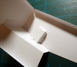

I've builded the front left console. Here are some photo.

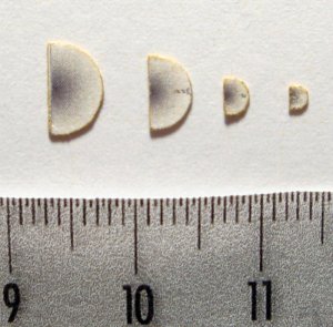

Do you wanna laugh? As you see I've prepared six knobs. This because I counted them on the pieces you see on the table. I didn't consider that some of them was going to be covered by the upper layer... really I needed only 3 of them. :hammerhead:
Well now I have 3 knobs ready for the next panels, no work was wasted. :)

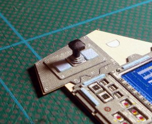

Mmmmmm! The throttle handle is somewhat too long... I often realize I've done mistakes only when I see the photos... I'm getting old :(

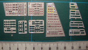

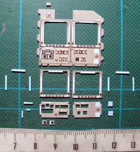

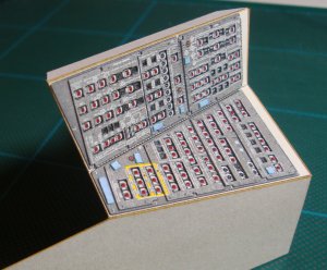

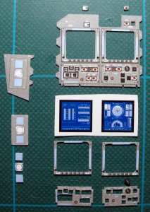

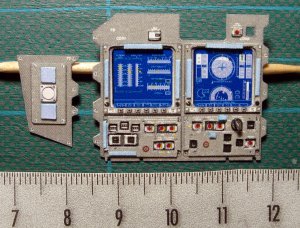

Here is the first batch of front panels
Components for F5 and F6 panels
And panels completed.
The translational joystick on F5 will be added later.
From a lower angle are better appreciated multi-layer surfaces and greebling work.

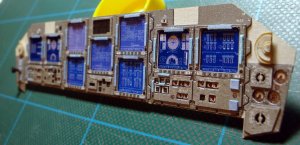

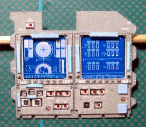

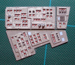

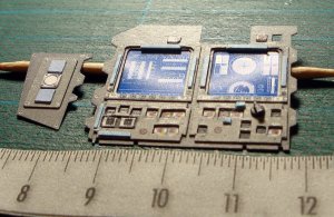

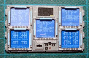

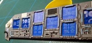

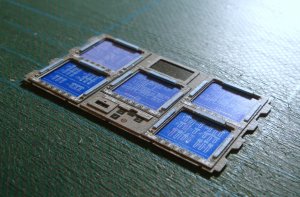

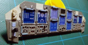

F7 panel components

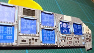

and the panel completed. Lots of screens here...
Another low angle shot for F7.

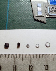

I'm planning to add black knobs to all monitors later. It's a detail that can't be ignored.
Paper is out of question here, I'll use plastic rod.

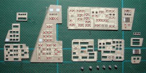

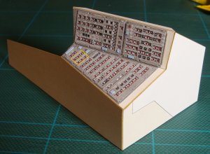

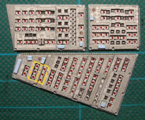

...and this is the last batch.

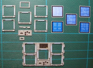

First of all F8 panel
The components (this time I cut also velcro patches before taking the photo... but I forgot the screens... :headbange:
...and the panel completed.

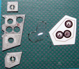

Now with the F9...

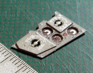

This time I adopted a different approach. As these are the only "old style" analogic gauges in all the cabin I decided to put a piece of "glass" in front of the dials. So, eventually, the panel will have a 4 layer structure.
A rear view showing the layers in place.
And the front view, very realistic (not in the photo: by eyes they are fairly better...)
Unfortunately to fit the panel I have to remove part of the base piece because the added thickness prevented panel to lay flat on the surface.

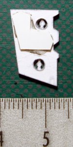

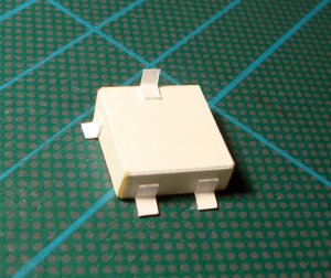

The pieces needed to build front translational hand controller.
...and the control in its place on F5
