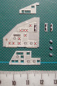

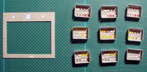

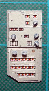

A little update. This time it's the upper right element in the aft deck.
Panel A1U
Panel A1L
Panel A1R

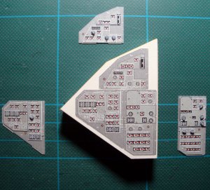

This time we have a three-layered panel. Part of the commands are covered by an additional plate that was added, I suppose, to hide part of the panel that was not more to be used.
:) I realize only now that this photo was taken with all the parts upside-down!

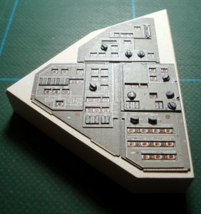

The completed panel group before assembling
And assembled. The low angle photo gives a better idea of the surface complexity.
I hope this feature will be well noticeable once the cabin is completed ;)

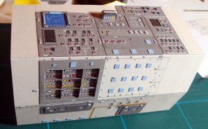

Here I am, after a little gap, with the right aft consolle.
Lots of little panels here and the first CRT screen.

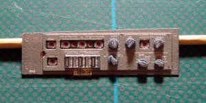

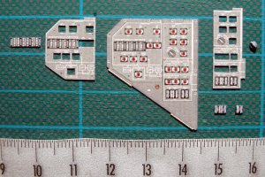

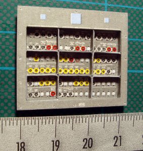

Let's start with the aft right audio panel: R10

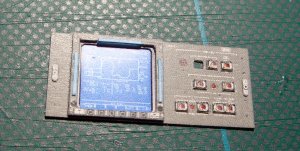

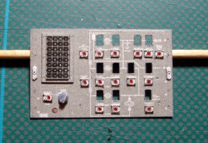

And the R11U the first one with a CRT screen.
I printed the screen on a semi-gloss printable plastic sheet. The result is very realistic. The photo doesn't do justice to it but I assure you that, by eyes, it's very nice. It appears like it was lighted from behind.
And it reflects light just like a monitor.

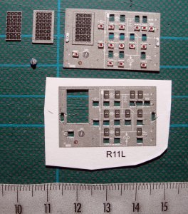

Here is the R11L where I show how I used the second copy of the piece to donate all the details that have to be raised.

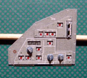

And here is the completed panel

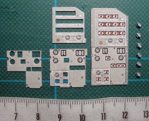

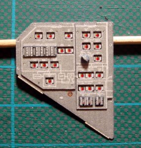

Then a look to the R14 where I had to build another series of little boxes to create the recessed panels.
and the panel completed

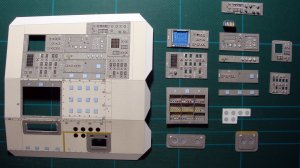

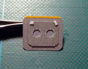

This is one of the access doors placed in the lower section of the right aft wall
And here are all the many parts needed to build this section of the flight deck
And the consolle completed
This is all for now.
