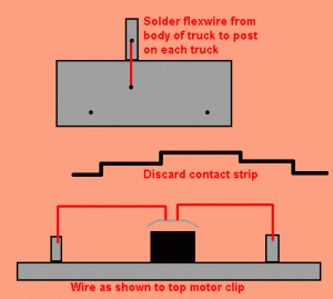

Jon posted about an Athearn switcher that he couldn't identify. Here's a tip on how to get these locos and other Athearn's using the same electrical scheme to run much better than they already do. The drawbacks in the loco are the rivets that attach the post(s) to the trucks,the friction fit between the truck and the frame and the contact strip that uses only friction to maintain contact between motor and the trucks. By "jumpering" the truck body to the posts and the posts to the motor performance will be vastly improved especially at slow speeds. You'll need to use some real flexible wire....the leads from a couple of burned out GOW bulbs will work just fine. Be sure to remove the brush clip from the motor before soldering to it so you don't melt the motor's plastic frame.

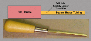

Making Grab Irons
I've always had problems finding straight grab irons for Hon3 in the correct size. Here's a way to make as many as you want and quickly too. This will work in any scale.
Parts Needed:
1. File Handle
2. Square Brass Tubing
3. Brass Wire
First determine the length of the grab irons needed. Obtain a piece of square brass tubing of the same size. In my case its 3/16X3/16. Don't worry if you can't find the exact size. Just use the closest size tubing. They look better if they are slightly undersize anyway.
Insert the brass tube into the file handle and secure it with epoxy or super glue.
Determine the size of the wire to be used to make the grabs and drill a hole in the tubing just slightly larger than the wire size. (See diagram)
Insert the wire in the hole and wind it tightly around the tubing. Pull it tight so you get good sharp square corners.
Slide the wire off the tubing and what you'll have is something that looks like a square spring. Just use your wire cutters to trim out as many grab irons as you need.

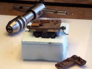

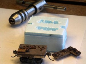

Cheap 'n Easy Car Cradle
Here is a very cheap and easy-to-make car cradle. It took me all of 3 minutes to carve the small block of foam. It keeps the car from rolling around on my work tray while I'm trying to detail it or work on another part.
Obviously, for a two-trucker, a longer piece of foam would be needed.

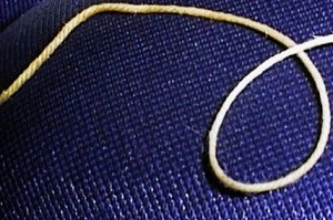

Rope for Tea Totallers
Scale rope is not very expensive, but this is free if you drink tea, and you don't need any long pieces. If you drop the whole bag into the tea, string and all, it comes pre weathered. It has, as you can see, the twisted appearance of real rope and not a lot of "fuzzies" like in cotton thread.

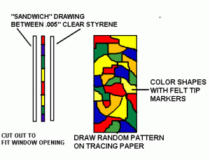

Stained Glass Windows
Hi Chris ...Here's a "down and dirty" way to make stained glass windows. The pic is self explanatory. I didn't try it but I think you could take the "master" drawing to a copyshop that has a color laser copier and have them copy it on to a transparancy sheet. That would eliminate having to "sandwich" the paper and you could just cut out what you needed. Hope this helps:)

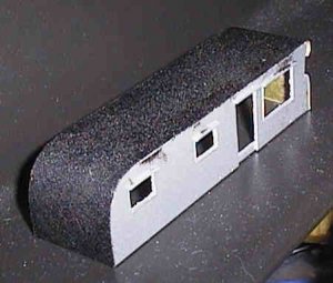

Here's a pic of my favorite scratchbuilding weapon.Do you know what it is?
Give up? It's a nibler,it is used to make holes in control panels(metal) to install switches and lights and meters.It also works in styrene to cut out door ways and windows.
I use this to cut out doorways and windows in any scale I'm working in (as long as the opening is larger than a 1/4".
I bought this one from Radio Shack but I understand that Micro-Mark also has them.In fact any store that sells electronics supplies should have them for under 10 bucks
