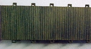

Flat Car Decks
Here's one of those molded plastic flat car decks...not as realistic looking as it could be.
(cont. in the next post...)
Drew1125
Jan 28, 2001
2,975
Flat Car Decks cont.
I take the point of a hobby knife, & deepen the plank separations, & also rough up the surface a little...
Then I paint the deck with some thin Floquil Engine Black...
After this dries, Y dry-brush with some acrtlic brown colors, leaving a lot of the black to show through.
It kinda looks like a wooden deck that gets used a lot.
