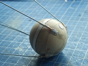

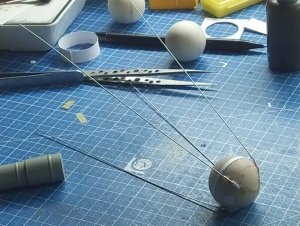

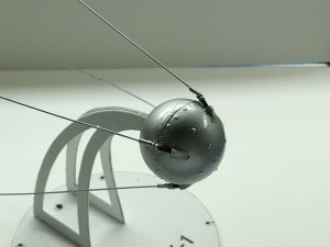

Last weekend in an art store I saw wooden balls, and I thought, can I assemble a Sputnik-1 model?
I decided to do it. I studied the drawings of very poor quality, a bunch of photographs, and drew mounts for the antennas.
The most difficult thing was to mark the ball for the installation of all the elements.
Assembled from materials: wooden ball 30 mm, copper capillary tubes, steel wire, aluminium type, and of course paper where can we go without it.
At the moment, I am preparing the model for chrome plating. While covered with primer and black paint, and I'm waiting for it to dry.

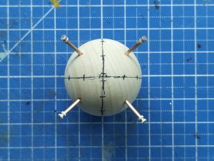

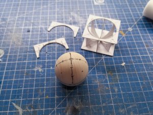

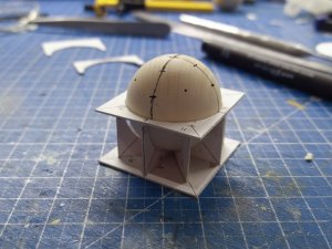

Since I'm not happy with the previous build, I decided to rework the ball marking system. Made a new construction, in which the ball is fixed very rigidly, which prevents its rotation. This made it possible to make the markup as accurate as possible.

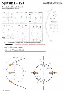

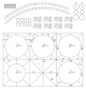

These are all paper parts needed to assemble the Sputnik-1 model.

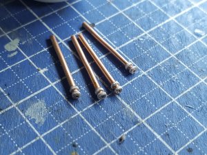

After marking, I drilled holes for the antennas, made fasteners from a capillary tube with a diameter of 1.3 mm, and reeled up paper to simulate the part.
The new design of construction for marking, helped to position the antennas quite accurately.

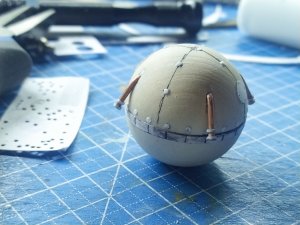

Then I glued all other details and rivets. So far, only the mounts are not ready, which will hide the hole and part of the tube.

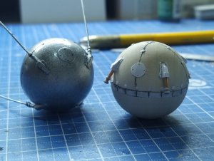

`look for a product called "Molotow Liquid Chrome" I don't know what the equivalent will be over there.

There is another project called 'Liquid Mirror' that is supposed to be as close to a paint on mirror as you can get, but I haven't had the chance to use it myself. The Molotow makes a very believable chrome finish, but the surface being painted has to be perfect, because the chrome shows every blemish.

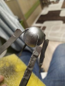

I have something like a liquid mirror effect in a spray can, bought in Leroy merlin. I painted the first version wit this paint. But this spray is good for painting glass surfaces from the inside. If you cover it from the outside, it looks more like a silver paint, but not like a mirror.
