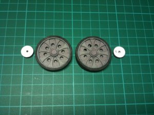

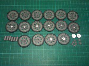

thank you guys for kind words

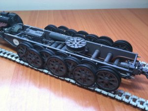

finished the outer track wheels and assembled them in pairs
in a few days i will put the monster on its legs

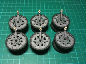

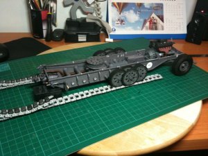

in process...
also found useful tool, pizza plate :)
very handy, because it turns 360 degrees
i can glue the track wheels and align them with comfort

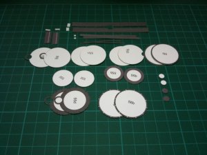

i was so happy that i almost finished endless amount of wheels, that i forgot about bags, as i usually post them after every block assembly, so...
bugs:
all holes for the axis in all details of track wheels are to big! - i cut out little ones that fit the axes
part 52c - gluing place for part 52l big in diameter about 2 mm - painted the white
parts 53f and 53g missing - printed from scan, because those parts are same as 51f and 51g
part 53i i hidden far far in the end of the book, on page 32, one with yellow boxes -good that i found it :)

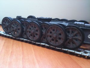

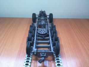

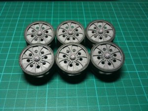

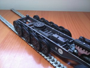

well, i finished to mount the track wheels!
you must to adjust the angle of the chaises arms by frame that stands on front wheels and put the track wheels on tracks, because they too have height
i already started drive track wheels. you can see some parts cut out on the last picture
