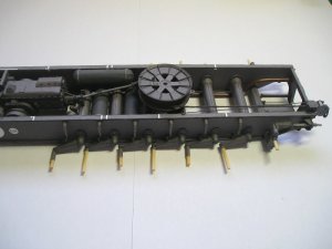

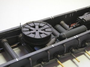

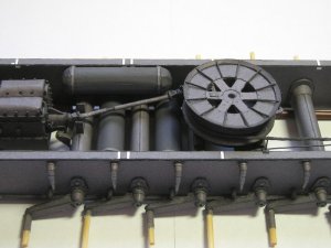

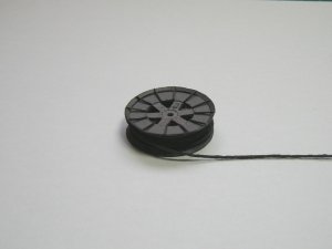

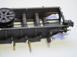

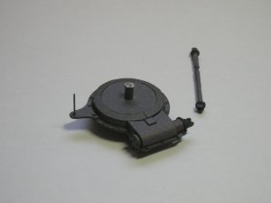

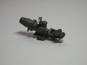

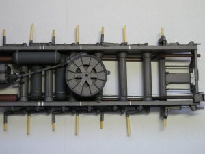

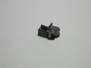

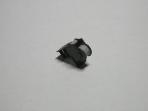

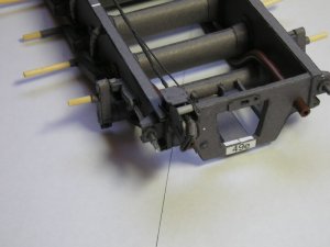

Hello guys
i took a little brake from assembling, but the process is continue slowly
the winch!
the pictures show the winch itself, the rotating mechanism, the rear stopper and general view
on last picture you can see the right angle to position the winch mechanism, so that it will connect correct to transmission and copy the prototype position
there is still to assemble trailer coupling and i will enter the era of wheels and tracks!
bugs:
42c - gluing place for part 42o wrong
42b - wrong insert cut, reversed
45k - same as part 45i, but need to be mirror to it
45o, 45n - diameter to small
gluing places for parts 43d,43e,43f are wrong. the winch must be placed at angle and not perpendicular to the frame

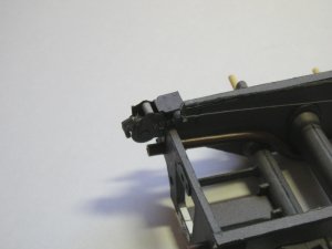

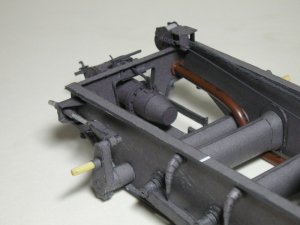

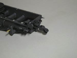

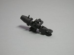

in the shadow of our not so happy events i continue the assembling, because it's the only way to forget and relax a little

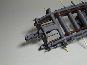

trailer coupling finished and mounted on the frame
it's fully workable an can turn in 2 vertical and one horizontal axes
(you can notice it on some pictures)
bugs:
49o - too small in length
and by this i finish another stage in this big project!
next: wheels and tracks... and a lot of them

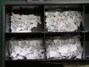

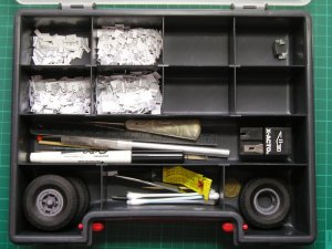

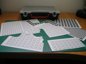

well, there is no big progress, but i decided to put some pictures of cutting process, so you wouldn't think i stopped the assembling :)
i also bought very useful case for the little details and instruments
and on the last picture there are the rest of details to cut...
it will take some more time ;)
