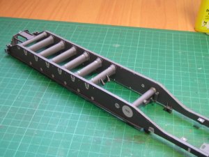

i am starting new project - Sd.Kfz. 9 Famo from Angraf. this model is very complex and with large number of mistakes and mismatching, but i will try to bypass it all and complete the model.
so, 34 pages of B4, 7250 parts, a couple of years for build process :D
i will build it as is, only painting edges

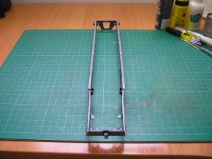

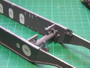

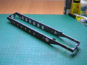

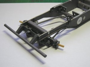

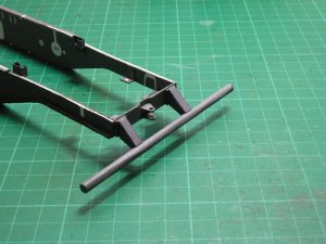

first of all the frame, and the first bug - the sides of the frame are too long for about 1 cm..
the rest is fitting well.
also added some little parts

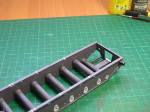

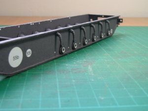

work continues slowly. slowly because of the amount of little parts to assemble, but i don't complain, i like it ;)
the feelings are mixed, from one hand i enjoy the process, from the other there are those little mistakes that you don't know why they pop up
from one hand all the parts spread continuously on the sheets, from the other, suddenly you finding yourself searching for little something all over the 34 pages of B4, and finding it 15 pages far from the place it should be with other parts

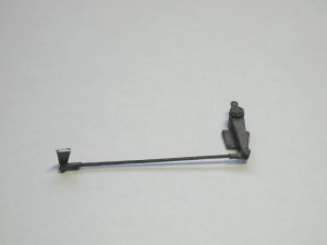

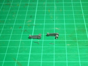

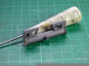

until now i assembled front bumper, driving shaft bridge and braking system (my guess)
bugs:
part 4d to little in diameter to fit in base of part 4c
part 5p to long for part 5o

I just got a copy of this one, not knowing the history of the kit. I will be watching your build with interest. When you say the frame is 1 cm too long, where does this error come in? One side, both sides, front or rear?
It would be great if you could explain any work arounds for the problems you find.:thumb:
Thanks,
Greg
snake7
Dec 13, 2004
424
1,165
93
46
Israel
Thanks,
Greg
no problem Greg :)
the frame is too long from both sides. its not front and not rear. you can put it from front and it will be too long from rear and the other hand. i noticed that the mismatching started already from first hole for the chaises from the end. but the width was OK. only the length was wrong.
the solution is simple: i ignored the frame and glued the part itself on the carton :)
the other two problems where very small. the long detail was just cut out and the little one i just made bigger, because it was inside white part.
i hope i explained myself clear :)

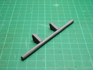

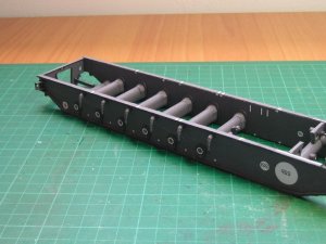

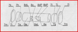

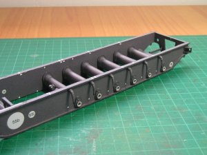

all cross bridges assembled. took some time because of the unusual form of the details.
i found parts 7m, 8d only on page 15, far from the other parts of the cross bridges (for those who own or trying to build the model)
bugs:
(again) part 7j is smaller then must be

How did you solve this Igor?
this is the inside white part, so you can make your own only bigger. but the shape was not circle. so i just inserted it inside to the depth it goes. it gave the shape to the outside detail. the detail itself i glued to place by edges and not by inside part.
i hope explaind it clear :)

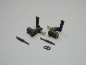

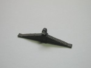

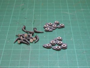

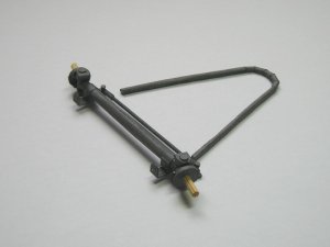

support rings for the chaises and some strange looking parts called amortizations, by instruction.
bugs: detail 9e is missing by 60 pieces (bolt heads)

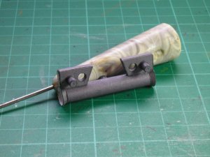

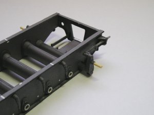

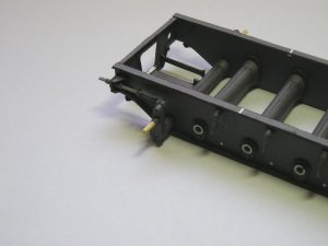

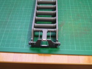

Straining mechanism completed and assembled in place
the axes where made from wooden sticks to strengthen the chaises
bugs: none

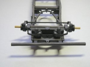

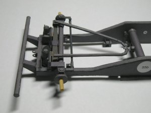

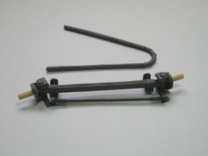

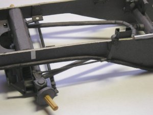

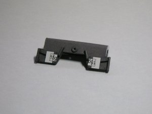

front suspension assembled.
i used a lot of wires, but in the end i got fully workable steering system :p
i will also include part of a scheme for the unit with a lot of bugs
there was a misunderstanding where to glue the legs of triangle strut, but the pictures of prototype helped a lot (included)
bugs:
part 13j must be reinforced with 0.5 mm cardboard, it's not mentioned in the instructions
part 15i too small - painted glue place
part 13b - the gluing place for part 13a is to big - painted glue place
part 14i - the basis for the part 13a is too small - cut out to fit the detail
part 13p is too long and no indications where to glue it to part 13a - cut and glued according to the prototype picture
