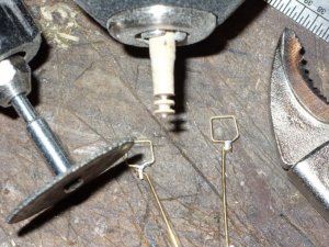

Smlmkgplyprts.jpg SMLplyprts&skrwjks.jpg Parts is parts

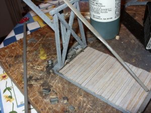

Very cold morning, My wife is working today @ the Children's hospital, taking care of the boys and girls with heart problems. She gets up around 4:30 am, and I was up before that loading the woodstoves, making tea and a sandwich for her. When she was gone, I had a worm spot in the kitchen, so I moved my work board in there.
I experimented with turning wooden pulley parts from a dowel chucked in a cordless drill with a grinding wheel in a dremil as a cutter. I also documented the last screw jack before it goes together.
These homemade pulleys have promose, as I may try to make some bigger ones to see if they will work on my R/C boats which could save me some $$ at a time my hobby budget is strapped. and I am facing possible massive future expendatures (it looks like MMI is going to make the 3 foot gauge 4-4-0, and I have two reserved in HOn3 and one in On3. the three could take a year and a half's train budget, fortunately I did not spend all of last years.

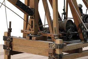

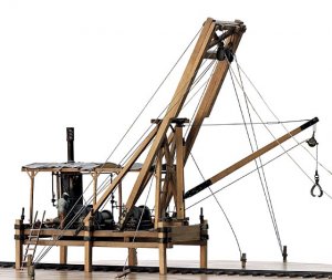

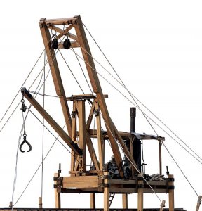

Here's a few shots from the Terrapin website to help keep you inspired.
Doc Tom:thumb:

Sml SP frmup.jpg SMLS-Pplycrks.jpg That's the animal!
Thats the animal! That builder interpeted the photos differently than I do in some areas, especially where theskidding tower attaches to the cross brace but it looks nice. My photos show only one pulley hanging off the skidder tower, so that's what I'm doing. this is what my 1st one looks like right now.
Interesting that that comes from the Terrapin sire, as mine is going to be the loader @ Terrapin Tn.

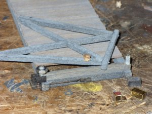

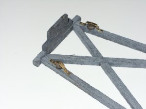

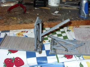

SMLNEXEXCPRTS.jpg not exactly intterchangable parts
one of the booms fit too tight, the other had some slack, , by swapping out the boom and the cross brace , they both have a good fit.

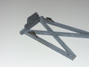

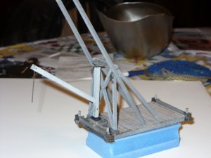

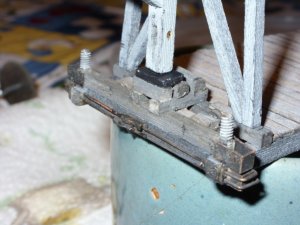

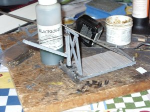

SML-SP TDP.jpg SML-SP TDP.jpg Making the tie down pulley
I have been working on the tie down pulley on the cross brace on unit # 1 . I got the straps made and filed clean. once I get them chemically blackened and bolted down I'll be able to fasten the cross brace and boom to the frame, and start to play with the vertical brace fit and the skid tower.
This piece of foam core makes an excellent photography backdrop.

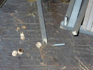

SMLdonepllys.jpg tie down pulleys
got them done. Just need the NBW castings an the back side and this cross brace will be ready to erect.
I may delay a little to be sure there is nothing left to do to the frame that would be easier without the cross brace and boom attached.

I'm thinking
I'm thinking these pulleys are grossly oversize, but I'm running with them.

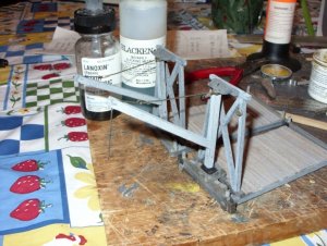

sml #1skpkts&trnbkls.jpg smlskdtwrstr.jpg more progress on the S-Ps
made some progress, have to stop, been looking through an optivisor too long

Hi Bill,
Looking very good.

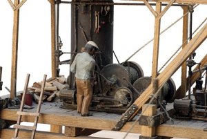

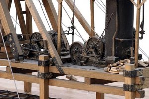

Here are some more pics from the Terapin Narrow guage site. Do these pictures help as far as rigging this beast???
Doc Tom:p
