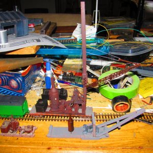

ASL A_1  TWR Skdr a-1.jpg ASL A_1  TWR Skdr a-2.jpg Back at it agian, this time with a Tower skidder!
It has been a while since I started a new project (the steam shovel is still in a project tray, in about the same stage of completion as the last photos indicate.
I am doing a major rebuild of my home railraod. at the same time we are doing a major rebuild of the Club layout in Clarksville TN.. My narrow gauge to standard gauge log reload facility in Ridgemont has been removed.
In that location, I had a kitbashed rail mounted log loader that was made from a Brownhurst crane model (MDC or Atheren most likely, i did the original conversion so long ago there are no digital photos to document what it originally looked like. I will dig through my photos and try to come up with a photo of this crane's last incarnation..
I built two Surry Parker skidder laoders, making one for Dr Tom. when he went to large scale I got the second one back. When I do my rebuild, I will have one at the narrow gauge- standard gauge reload facility, and the other at the log camp; so the kitbashed log loader was out of a job. The tower skidder will likely go to the club for a second logg camp on the newly rebuilt high line.
I had the boom extended with some CV girder material, but I will need to make it lomnger still so I dissasembled it. I filed on the end of the boom, so it will rise higher, and I may need to remove just a little more as I will need the boom to raise up to a vertical position.
Tower skidders did a lot of work and had massive boilers. What I am using here is a Bachman O scale two drum skidder. this is a small machine in O scale , but is a monster in HO scale; just what I need.
I will rebuild the boom, (now a tower) with CV girder material; most likey this machine will go to the club. I wish the crane's original frame was longer, but "m not messing with it, as it is cast metal, and heavy enough to support this project.

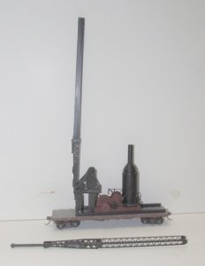

ASLA-1a twer skidder on cr.jpg found flatcar
I had a flatcar in mind to mount this unit, I believe it was an old MDC car . It did not like my railroad, but tracked a little better on the club layout, so I had it there. I finally found it there, and brought it home for use on this project, which will likey be stationary, so it won't matter how ****y the car is.
I photograped it on the workbench, the clutter there is usually much worse.
I'm looking for the spool of light gray button theread that I use to represent wire rope, once I find that, I need to make a swivel head with a pulley for the top of the tower, figure out how I'm going to rig this monster, and then I can start to put the drums in the base of the donor crane.

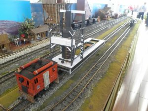

Now that's nice.
Bill,
That is a nice looking build you got going there. I agree it will look real good on the club's logging show.

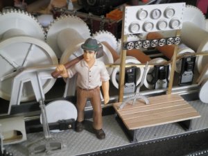

Here are some pics from over on the Large Scale Central forum showing a build of Lidgerwood tower skidder in 1:20.3 Large Scale. The thing is huge and the base is made from actual welded angle iron.
Tom

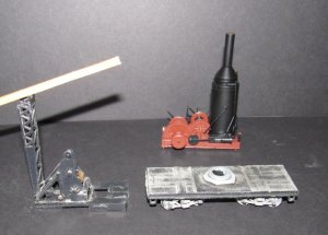

ASLA-1a twr skdr w bm #1.jpg re thinking
after studying the landing site at camp Gravestone at the club where this monster will likey get placed, I decided that a loading boom would be a good idea I am using the end of the brownhurst boom, which I am extending with some leftover pieces from a Centralvalley Truss bridge that I shortened. This boom, as it is is too long. I need to design a pivot, that will let the boom move from side to side, and then I will shorten it considerably.
Not finding the button thread I used to rig my big Donkey project, and the Surry Parkers, I purchased another spool of thread. once I have the pivot for the , or perhaps even before that I may start painting the machinery and start assembling this monster. ot will be slow going as most of my effort is going into the rebuild of my home railroad.

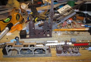

ASL-A1a rsty stuff.jpg 'm reworking some bridge spans for my new RR design, and needed to repaint them with a mix of flat black and red auto body primer to get the rusty blackl metal look. I tossed the tower skidder machinery in there as well to improve it;'s looksand I'm liking it!
the first photo I made had a white backdrop and the flash overpowered the photo, and my graphic converter program did not help much, so I re shot the photo with a black back drop, and this shows my rusty metal look much better.
I sparay with flat black and then follow with red auto body so quickly that the black has not had time to dry yet, and the colors mix on the part. These bridges were off of my Gizzard module, and have been in service for close to thirty years. they were silver to start with, and then they were flat black, and later rusty black. they were repainted several times with rusty flat black, but this is the best yet. from this angle the flash found some of the old silver, which is not visable to the naked eye.
