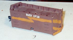

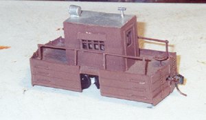

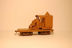

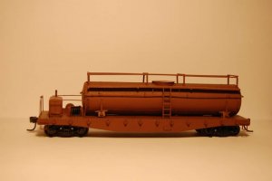

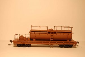

Okay...here are a few of my projects. Two fire cars, a derelict Brownhoist crane, and three combination bucker/flanger plows. All are scratchbuilt or heavily kitbashed and are based on McCloud River prototypes.

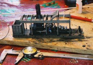

I model eastern Tn. logging in 1928. I rebuilt a passing siding halfway up Iron mountain because it was too small . Extending the passing siding down grade required hacking up the scenery, so while I was there I added a logging camp . This camp was on the side of a mountain. I had a small logging scene on the top of the mountain, so I needed a big machine to bring logs up from the cove below via ha high line.
no commerciallycommercialy available donkeys were big enough, so Inspired by the book in search of steam donkeys, and armed with a bunch of bits and pieces from Rick @ Rio Grand Models, I peiced together his behemoth to get the job done!
The sled, water tank, frame, roof, fairlead , whistle, smoke arsetor and piping are scratchbuilt. The Boiler is A RGM piece, The big hoist is a modifiedbdp  under construction small.jpg small  terrapin  landing.jpg RGM mine hoist, and the small hoist is a modified RGM three drum hoist. the scene isn't done I need to piece together a Surry parker skidder loader to get logs up to the platform and load them on the cars

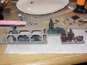

sml doney repair.jpg Donkey shop
Last year they had an earthquake in Indiana or thereabouts. I slept through it here, but it shook up the RR room pretty good. Every car was off the track @ Terrapin. a Rio Grande Models Dholbeer donkey , and a couple skid shacks made the full four and a half foot trip down to floorlevel; which pretty much completely re -kitted the Dohlbeer. A kitbashed donkey went about a foot down hill and sustained medium damage, and a kitbashed lifelike flatcar load donkey went into the log pond @ the big B-S Lumbercompany sawmill.
This thread helped inspire me to get of my donkey, and get the donkies repaired.
To the far right is a bone stock Rio Grande Models Dolbeer donkey (2nd design). to the right is a kitbashed donkey, with a scratchbuilt skid. The boiler and the big drumed hoist are from an SS ltd donkey, and the two drum hoist in front of it is a Rio Grande models 3 drum hoist, which has been modified to make the drums wider. Bringing up the rear is a three drum donkey bashed up out of lifelike flat car loads. the flat car loads are two drum hoists. I cut one off, and added it to this one with a frame modification to make a three drum donkey. The boiler is of an unremembered origin, having been on my layout or in my parts bin for the last thirty years. The lifelike unit comes without cylinders or rods. The rods and cylinders on this one came from a N scale locomotive
The two kitbashed units still need to have exhaust pipping, and some other detail added to them. The Dolbeer is usually a flat car load, the smallet kitbashed unit works the unloading crane @ the big mill. and the other will work a sideshow off of Terrapin knob, if I ever figure out how I'm going to rig it.

Bachman donkey's
Bachman has recently come out with little donkeys sold rtr 2 on a blister back. These are undoubtibly the cheapest fastest way to a decently modeled small donkey, more expensive, and exquisitie kits are available from Evergreen Hill and Rio Grande Models the KMP (?) stuff is not acurate and is thus too expensive for what you get.
I'm playing with the Bachman skiders @ the request of Dr Tom (aka the notorious DR G) and am posting some stuff related to that on his thread (pg 16 & 17 of Logging East Tennessee on the C&S RR

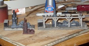

smldnky shop wtks.jpg meanwhile back @ the donkey shop
I got that bachman donkey rebuilt with a scratchbuilt skid, water tank and fairlead built and delivered to Dr Tom's C & S.
Durring that build I had some of my unfinished donkeys on the workbench to use them as construction guides.
Well finishing one for the good doctor (I got a bachman skidder in the deal to alter for my own self) I started to look at my unfinnished projects .
Scratchbuiding the water tank for Dr Tom's donkey was timeconsuming, so I looked around for materials. I found a couple pieces of plategirder birdge material, and used it to kitbash two water tanks quickly and easily.
The bachman donkey removed from its shipping skid and painted sits in front

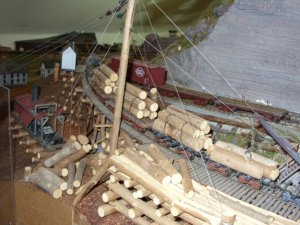

donkey tricks
Tom,
If you rig that donkey there is a trick you can employ. The skid is not decked under the winches, so there are holes under the drums.
What I did on my big donkey @ Terrapin, is I wrapped each drum with grey button thread to simulate the cable (Button thread is strong, and doesn't fuzz, so it looks ok in those close up pictures.
When the rigging is done, the lines to the drums are not actually attached to the drums. they pass over the drum, through the hole in the skid under the drum, and then through a hole drilled through the scenery under the skid. I run a couple feet of line hanging under the layout, and then hook a fishing sinker weight to it. the weight keeps the line taught as everything else expands and contracts with temperature and humidity changes, and best of all, when you snag the high line with your elbow while cleaning track, or trying to re rail that car under the maze of cables, the line has lots of play, and isn't attached to your donkey doesn't go flying.
The guy wires are just tied off to stumps so they are still expsed to snaggage. It might be possible to drill out a dowel, to treat guy wires the same way, and just fake the tie off.

I just put in a 70 foot Spar tree at camp #4 to replace the oversized dowels that have been there for years. I was just starting to think how I was going to rig the line out to the pick up point for the logs high on Grandfather Mountain. I will follow your sage advice. I like how your Terrapin scene turned out.
Forgot to ask you when you were here where you got blocks and pulleys and such from for the rigging you did. I know you got some swivel hooks from Basss Pro Shops, but what was the ship model co. you got the rest from????
