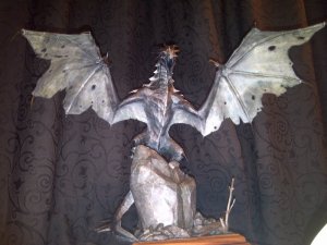

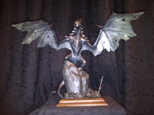

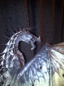

Yyyyeeeeeesssssssss!!!!!!

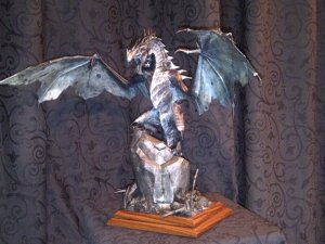

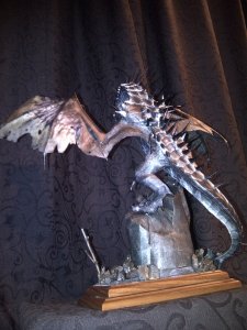

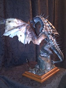

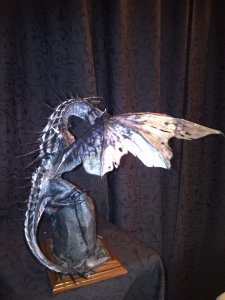

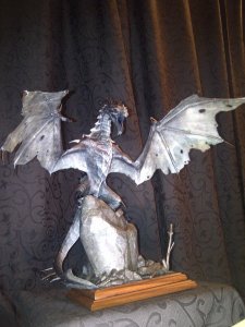

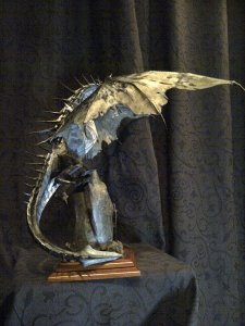

Ladies and Gentlemen,
IT IS DONE!!!!!!! :mrgreen::mrgreen::mrgreen::mrgreen:
I have taken nearly 390 photos with my SLR last night. I still have to process the RAW picture files and convert them to JPG. I just couldnt keep my eyes open anymore last night to do them, so I will process the files tonight instead.
These pictures will also include 'nature shots,' to satisfy those wanting ......:mrgreen:
In the meantime, here are a few pictures I took with my phone camera last night.
ENJOY!!!!!
I will see you all later on tonight with more.

daishi
Apr 14, 2011
313
436
Hungary
Ok that's .... SERIOUSLY COOL!
I think that's about my favorite built so far (mine are excluded cuz im partial :p)
But seriously I love how it looks: that stand is very cool, the colors on the are very cool, also everything else is is very cool too.
Congratulations!
