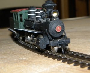

#1, is a Ken Kidder Baldwin 0-4-2 plantation engine. I have added some sadletanks to balance it better, replaced some bad factory gears with NWSL gears, but it has a shorted insulated driver and is not currently in service.
#2 is a Keystone/NWSL shay, built with a few mechanism modifications, and some brass parts to replace the white mental smoke stack domes and, I believe, the air pump. #2 is basicaly done, painted and lettered.

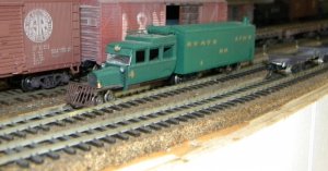

#4 is a Con-Coor Galloping goose, from the first batch, it was produced with a Wayne buss body, but I scratchbashed the older Pierce Arrow body for it, case the buss bodies, while interesting are uglier than homemade sin. they are now available with the P-A body. the Con-coor goose runs excellently right out of the box

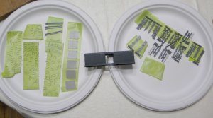

SML # plts.jpg SML FEDs.jpg getting brave
getting brave I'm doing some striping by hand as I paint the cab sides and roofs.
I got a photo of the number plates , brass castings which make a nice improvement on the nose of a low numbered locomotive.

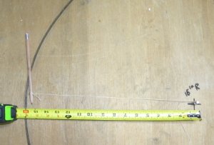

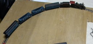

SML aproximating a 16 in r circle.jpg SML testing 16 in radius.jpg Planning considerations
I have three possible plans for HON3 projects.
Since the top end of the switchback @ the club has been turned into Shay territory (the little GE is happy there too) I am considering linking the two tail tracks for the switchback to make a big loop, which would allow the rod engines some room to play.
at home I am considering altering my plans for Gegoukayoosa , perhaps augmenting or replacing the planned turntable with a return loop. Also I am toying with the idea of making a little portable mini railroad .
planning for any of these projects would be greatly enhanced by knowing what I could use for a minimum radius. The folks on the Yahoo HOn3 chat list informed me that my C-16 will handle a 15 inch radius. My MDC 2-8-0 is considerably longer than the C-16, so I started out making a test track with a 16 in radius, which the MDC 2-8-0 will handle easily with several cars in tow.
Next I'll try a 15 in radius. my PFM 25 ton shay will reportedly do a 12 inch radius, and the FEDs have been reported to tolerate a 10 inch radius. I have no info on my NWSL/Keystone shay or my con coor goose, nor the forney or the puffing billy. so I will make increasingly smaller test circles and note what can handle them, and use or missuse that info to make decisions on what to do where. It looks like I have room to do a 16 inch radius return loop beyond Gegokayoosa, the MDC will barely drag inself up that grade, but it might be a lot of fun to doublehead trains up that mountain.
Bill Nelson
Bill
The Blackstone K-27s were tested by Blackstone on 17" radius and Shinohara #4 turnouts by Blackstone.
My FED 2-6-0 instruction sheet advertises a 13" minimum radius. The MDC 2-8-0 states 18" radius, but I know of many cases where it will do less.
Some of the articles on putting together the Keystone Shays reported no trouble on 15" radius, and I would guess it would do better - more like 12". Like all model Shays, the limit is typically the telescoping portion of the line shafts - how much they will contract before binding, and how far they will expand before falling apart. If the expansion distance capability is different from the contraction distance capability, the model Shay will go around sharper curves in one direction than the other.
A narrow gauge Shay that has the engine crank roughly the same distance from the wheels as the line shafts will go around a smaller radius than a standard gauge because there is less expansion/contraction of the telescoping universals. This is where the Roundhouse Shay struggles a little because the engine crank is lined up for standard gauge. As a result, there is little gained in terms of minimum radius due to the narrower track gauge.
My test layout is planned for 15" radius, with the test grade being 3.5% on the 15" curve. I'm hoping for 3 cars from any of my locomotives.

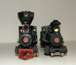

#5 with a frnt cplr.jpg a front coupler on # 5
I finally got a KD 714 on the pilot beam of my FED 2-6-0. I used the tapped hole, which originally held the cow-catcher casting. The notch in the pilot beam for a coupler was slightly to skinny for a 714, but a grinding wheel in a dremil fixed that quick.
The draft gear limits the travel for the lead truck , and on the 16 inch test track it almost touches, so If I do the return loop beyond Gegokayoosa, I won't go below 16 inches, which will fit in the space available, although with little wiggle room. . it is useful to have the fully operational front coupler . I won't put one on the 4-4-0, as I want to retain the cowcatcher for looks. I will experiment with the C-16, to see if I can fit a dummy coupler to it in such a fashion to make it partly functional. I have hacked up the pilot beam on many a standard gauge rod locomotive to get a functional coupler on the front of a locomotive, but I'm not doing that to my C-16.

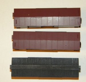

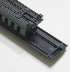

SML ct dwn MDC c #1.jpg SML ct dwn MDC cs #2.jpg A digression- HOn3 car shops
I am putting together a narrow gauge passenger train from Ho MDC 30 foot shorty overton coaches. These coaches are extremely short, and they were inspired by some very short passenger cars which were built for the Sierra railroad for use on it's Angels Camp branch, which had curves too sharp to allow regular passenger cars.
This conversion is an old trick. I know Malcom Furlough used this, but I do not know if the practice preceded his use of it or not.
available passenger cars are scarce in HOn3 Labelle Woodworking makes very fine wooden kits, which are really nice, detailed, and complicated, and expensive Model Railroad General Store makes some nice plastic kits but like most anything good, they are expensive Blackstone will be making passenger cars in the future. all of these are standard D&RGW cars, and they are long enough to be a problem on tight curves. I have cut down a Labelle combine for my standard gauge, but that is a tricky operation on an expensive kit. There are some brass passenger sets, but they are expensive very heavy, and generally don't roll freely.
Once upon a time when mainstream model rail road manufactures still sold kits, you could get the MDC overton kits for $13 to $18. Some these cars came from my stash of kits, and some were purchased from another modeler who was weeding out his stash of goodies. other than and old kit, one would have to buy a RTR car and re kit it I don't know if they sell the cars separately, I have only seen them in sets, which is a pain, as I'd like a coach or three more.
The proceedure with the MDC cars is to remove the ends of the coach. You cut the ends off from the inside, flush with the inside of the side walls, down to the floor level, and then you cut the floor , on the end flush with the end wall. Once you have the car end out study it. There are boards between the outside edge of the car end, and the window frame, and you cut these off flush with the window frame ; (2 cuts, one on each side of the car end. there are also boards between the window frame and the door frame, and you cut these out also (four cuts- two on each side of the door) flush with the door frame and window frame.. Then you glue the two sections with the window frame on either side of the door, and you have a car end just the right size for a narrow gauge car.
with the car ends off, you have the two side walls and the floor. I cut the floor twice, about a quarter of an inch in from the walls. I leave the center of the floor out for now , and glue the shortened ends to the car sides, with the truncated floor. when the glue is dry I mark the bottom of the door with a bencil line showing the car center line. I put the center piece of the floor in the inside of the car, line the truck screw locations up with the center line marks on the bottom of the door, and mark the center section of the floor with a pencil line showing how much it needs to be narrowed to fit back into the now skinnier car floor.
In the next installment I will review what is done with the car underfloor and platforms.

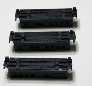

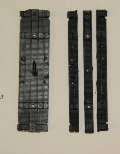

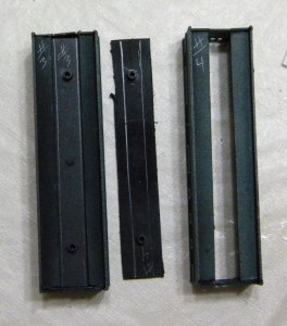

SML  frm up top.jpg SML  underframes.jpg I am up from my nap, and preparing to try to stay awake until after 8:00 AM., in order to be more ready to start living on the graveyard shift, starting tomorrow night I have been working on these cars on my kitchen table, and it is in my night's plans to clean this table. I' m thinking I ought to mess it up more before I clean it, so I'm doing more of the messy work on the car floors.
the outside strips of the underfloor are too wide. rather than cut them down I sand them down with a belt sander. there is a cast in beam on the inside, and if I sand almost to that beam they fit right in place, without having much of a gap on the platform. I find that if I try to cut them down, I don't get as good a result.
T0 mount KD 714 couplers I just cut out the hollow cylinder in the cast in KD # 5 draft gear, and screw the 714 draft gear right down in the center of the #5's pocket. The bolster is a little too tall, and this will make the car sit too high, some some of the round prtion of the bolsters will need to be filed off to et the car height/coupler height just right. Since I will be using trucks I'm not familiar with, I will wait until I have the trucks in hand before I start filing on the bolsters.

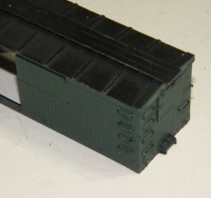

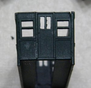

SML roof #2.jpg Sml roof#1.jpg SML railinebox.jpg working on the roof!
the celestory roof is a complex shape, and cutting it lengthwise to narrow it is not an option.
The procedure is just to cut material off the sides of the roof. This makes a roof where the bump up in the roof is too wide, but it is the only easy option, and the result looks good from the side, and so it can be lived with. the alternative is a MRGS kit @ close to $60.00 or a Labelle kit @ close to $70.00.
In the top photograph you can see a narrowed coach body, placed into an unaltered roof casting. as you can see the walls fit just inside the tabs that are designed to fit just inside the unaltered coach body. The procedure is to cut the sides off of that roof just inside those tabs. There isn't much wiggle room there so you need a very fine kerfed (kerf= the thickness of the cut made by a saw) razor saw. since an error here will show, again I use the belt sander to sand off the sides of the roof casting until I'm very close, and then hand sand the rest off with a sheet of sandpaper placed on a hard smooth level surface .

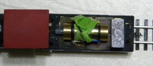

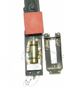

SML 2-6-0 polarity swap.jpg sml wrs ceossed.jpg SML 2-6-0 polarity swap.jpg sml wrs ceossed.jpg polarity swap on FED 2-6-0
When I had installed the locodoc conversion motor to my FED 2-6-0, I had gotten the polarity swapped, so it ran backwards to my other locomotives. That wasn't a big deal, my narrow gauge didn't really go anywhere then, and It didn't have a front coupler, so I didn't have much of an interest in double heading.
Now that I am working for somewhere for the narrow gauge to go, and more locomotive options, it is worth fixing, so I removed the tender shell unsoldered the motor leads from their respective locations on the tender, soldered small extensions on the wire so they were long enough to reach the other side and crossed them over each other.
While testing the locomotive I noticed it had traction problems. Since it didn't have those before I added the front coupler, I suspected pilot truck and front coupler interference. I filed off some of the coupler's draft box, and turned the pilot truck the other side up, and that seemed to fix it up.
I had been doing some work on the three rail line box car kits frames . i also found a partly built rail line stock car kit I acquired at some point in the distant past, so I have added it to the construction list.
The Rail line kits are models of some D&RGW prototypes. Their cars sat quite low compared to some generic narrow gauge cars, so low that the flanges set up in the hollow between some of the frame timbers, greatly reducing the amount of truck swing, and the minimum radius.
because if this I am making dome frame modifications raising the frame higher, and moving the bolster inward to allow clearance so the coupler draft gear doesn't interfear with the truck swing either.

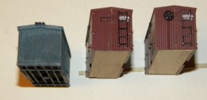

SML C D Man 1860 bx # 2.jpg SML C D Man 1860 BX #3.jpg SML C D  Man 1860 BX.jpg SML C D Man 1860 bx # 2.jpg SML C D Man 1860 BX #3.jpg SML C D  Man 1860 BX.jpg another car cut down project
Cleaning my work surface got me cleaning and organizing my cabinet, so I could store stuff in there more coherently , I found a box with some partly done Hon3 projects.

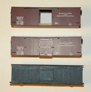

I found some Mantua 1860 box cars. That I had started to turn into short narrow gauge cars. This takes a lot fewer cuts than the passenger car. I cut the height down with one cut just above the floor. On this model I discard the plastic floor, and added a wooden floor.
To narrow it I made two cuts straight down through the roof and end walls on either side of the cast in roof walk, so there are only two plastic pieces to glue together.
These two are going into the stack with the 3 Rail Line boxcars and one Rail Line stock car I found looking through that cabinet. In the photo's there is a part way built wooden boxcar Kit, which shows how closely this easy kitbash resembles a generic 3 foot box car.

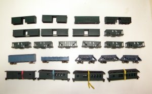

SML NG CR SHPS 1:25:09.jpg the narrow gauge car shops!
It was my planned goal to get my workbench cleaned off this weekend.
It didn't happen. The first disruption to plans was I ran into a guy who is my daughters age who used to come down and play with her when she was tiny. He and his brother were gathering scrap metal to sell, and wanted to know if I had any I needed to get hauled off. Most old farmsteads are littered with such, and it was wonderful to get someone who I know and trust to clean out my woods, so I spent a lot of time helping them find the various piles of scrap metal.
then it turned out one of my co-workers was ill, and the guy we support has fragile health, so I did an extra shift, and only had a one day weekend, so I did not get as much done as I had planned this weekend.
I did get my workbench clear enough so I could find all of my Hon3 car projects at once, and I was surprised. I think I have more cars partly done than I have finnished, which is good, cause if I build the staging yard @ Gegokayoosa, I'll have almost enough cars, once these are done. A photo of the partly done cars is enclosed. I have about four or five kits I have not started yet also, and four more tweetsie style hoppers I have all the materials (except the trucks) cut to size for sctatchbuilding, but haven't started assembaly Yet.

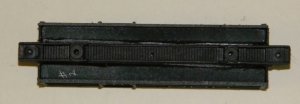

SML altrd blsters.jpg I'm modifying the bolsters on the rail line box and stock cars to raise the body on the trucks and to move the trucks slightly inward to keep the frame and the couplers draft gear from interfering with the truck swing.
I have filled in between the two frame members behind the existing bolster flush with the frame and glued a styrene pad centered on where the trucks will get relocated to.
I need to add another thin layer of sturene as the flanges still contact the frame.

I got a package in the mail yesterday, and I have the Locodoc remotoring kits for the C-16 and the FED-4-4-0. I can't wait to get these super fine motors in these locomotives, but I'm not going to attempt anything in my sleep deprived state. I'll post photos when I'm doing the work. I've done a locodoc conversion on my FED 2-6-0, and I have seen a Westside C-16 with the conversion done, and they run as well as the best rod locomotives out there . A conversion that is definitely worth the cost. I have re motored five or six brass locomotives on my own, and it is so nice to have someone do all the hard lifting of locating an excellent motor that will fit, with the gearing, or connecting linkage all figured out and there .
