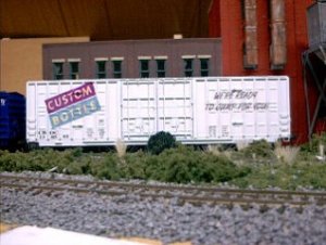

OK...I found a pic of the boxcar I did for Custom Bottle.
This is an Athearn Genesis kit.....and netted me $50.00 from the company!
