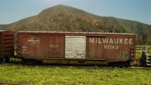

Ok ,we were trying to come up with new ideas to get the membership motivated to post more on the Gauge.One idea I came up with was a freight car of the week thread.
First we are going to do this by type of car.This can be in any scale from Z to prototype. The only rule here is that the pic is yours or was taken for you.
Since this was my idea I am going to start it with a boxcar.You can post on a daily basis but please only one pic a day.
I like this nasty old Railbox car cause I did it all to it.:D

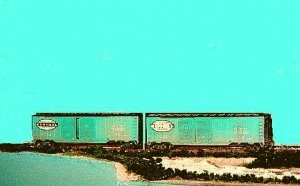

There are legendary stories of the Penn Central losing a box car for months. In that vein here are a couple of lost former NYC 50 footers in the middle of nowhere. hope some one finds them soon!

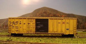

Day 3 OOPS! I missed a day :D
Brand new ATLAS Trainman HO scale Railbox boxcar (of course)
I think ATLAS has a real winner with the Trainman series.Looking forward to the N scale cars and locos.:D

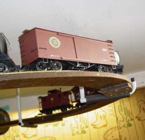

Catt, since we can post one freight car a day on this thread, should the name be changed to "freightcar of the day"?, and just keep the thread going? just a thought;) . :D -Deano View attachment 29415
