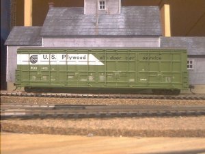

I think we ought to change this thread to Frieght car of the month.
I was thinking...."Hey..No one posted one of these!". Then I went back through and found the Alldoor Catt posted...Oh...Well....

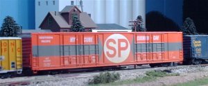

Here's the second one then. Walthers, from a two car set.
