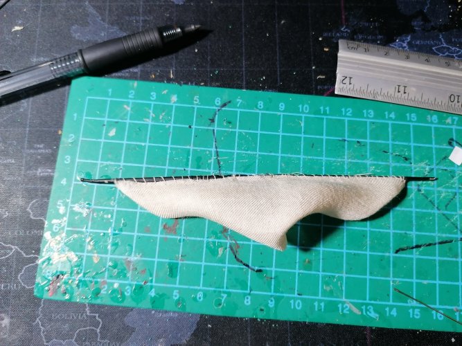

Now, the bit I've been itching to get to, furling the sails :)

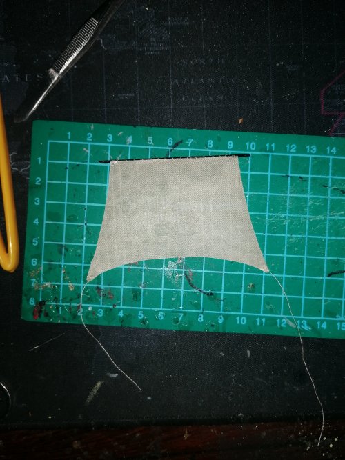

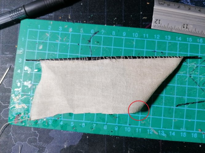

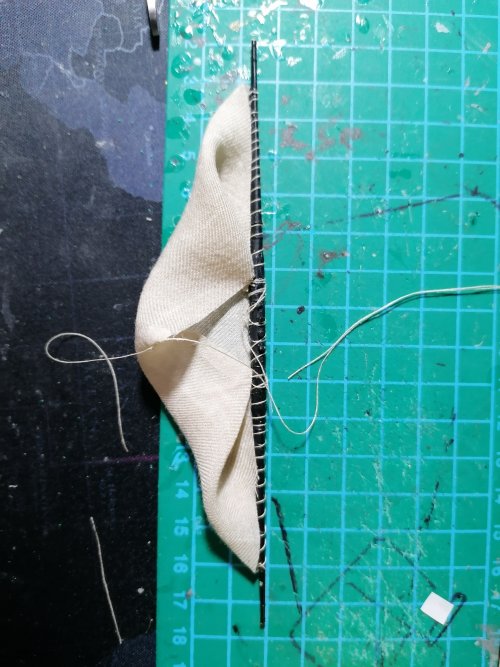

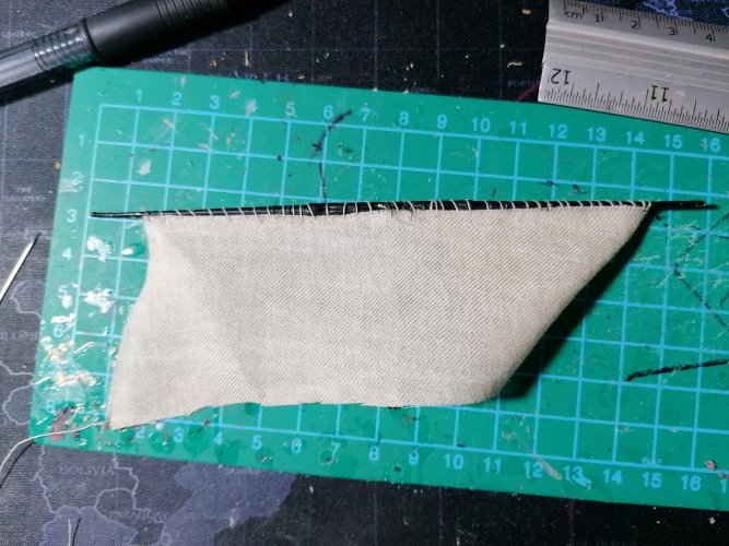

First I cut the sail (bit of a guess-timate since the one provided is moulded furled) and stitched to the yard arm. The corner is then pulled up to the yard and tacked to the yard.
Them the circled area is stitched to the same point as the first corner

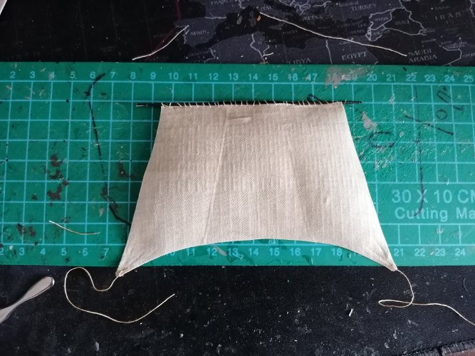

And you get this, front view;
And rear

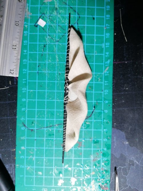

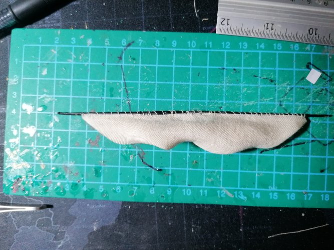

Next the middle part is stitched together, and then to the yard.

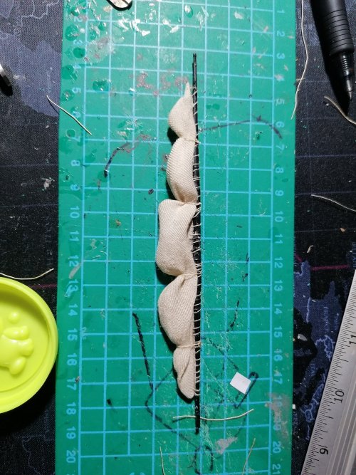

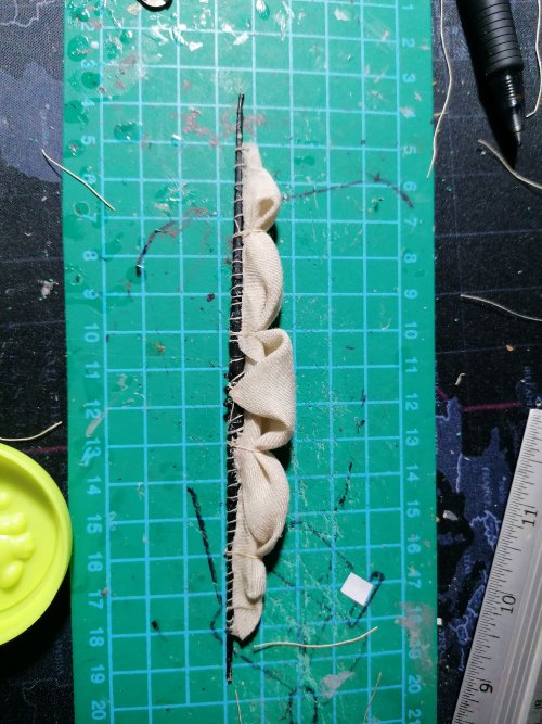

Last but not least, the reefing ropes, front
And rear
Then just a bit of wood glue to nip the edges together

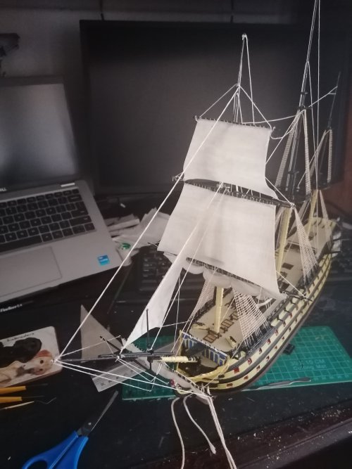

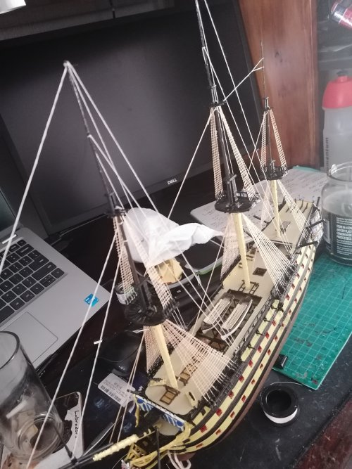

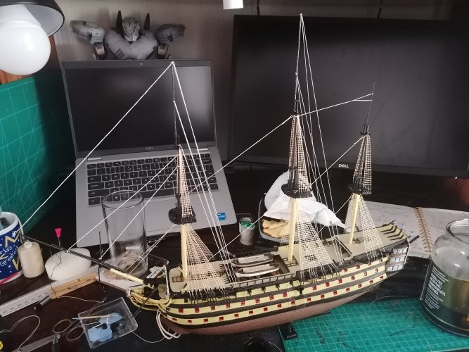

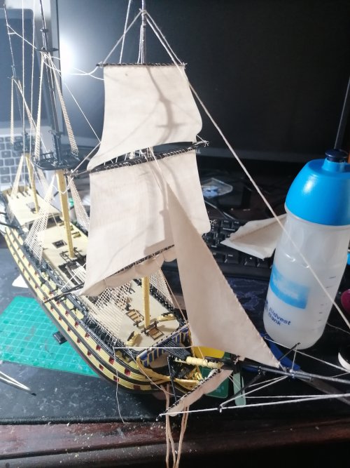

So with the foremast sails done and attached I got carried away and worked on the bowsprit before taking any pictures....
So here we are, foremast complete and one of the flying jibs attached, stitched onto the sheet. To explain the terms; A flying jib is called such as it is attached to a sheet (rope) as opposed to a standing jib which would be attached to a yard.
