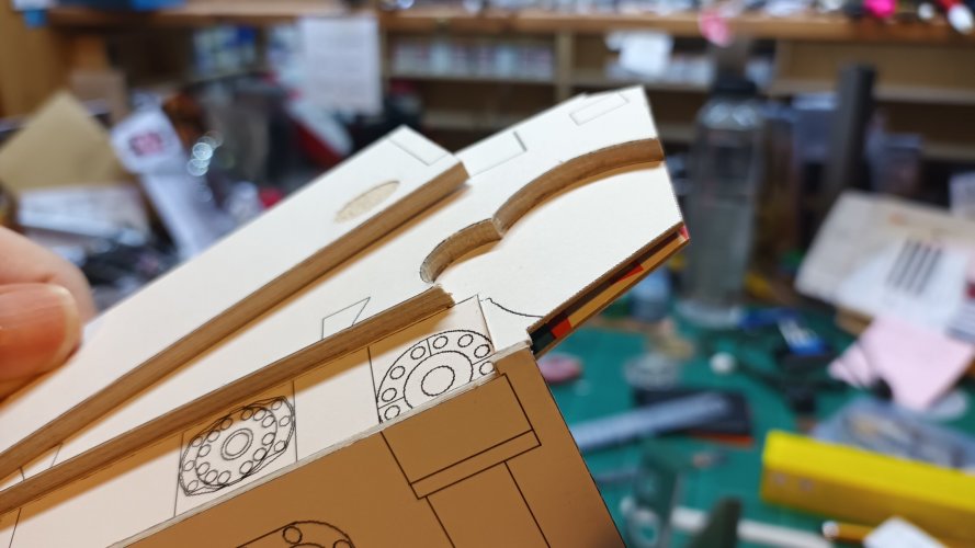

I'm truely impressed here, the thickest laminations I have cut yet were only 1mm thick and I dulled three #11 blades doing them. My Mora Garberg bushcraft knife blade is only 1/8th inch thick, so to be cutting 1.8th inch cardboard and paper... Holy cow.
11,612
12,353
I cut each layer separately. That's easier than cutting the finished laminated piece. If you want to cut a 10 mm thick laminated board you could start using a wood saw instead of a blade.
13,498
9,549
I have a small bandsaw for thick stuff, and I've been known to cheap using Balsa wood. You're doing great! :)
Reactions: Revell-Fan
Chuffy70
Jun 5, 2022
842
1,708
Norwich UK
I noticed that on the AT-ST. The head got pretty heavy and I feared that the legs would collapse. But in the end everything was fine. :)
Yes, in sci-fi who cares whether it can actually stand! Until you build one and find out the hard way :sticktongue:
I like everything cut in one go so everything is precisely the same - it's only cereal box-board. I don't think I'll be going as far as 10mm, that would be some pretty thick armour! :)
Nice a slow with several slow passes on the thickest laminations with a fresh blade achieves a good clean cut - The Swann Morton scalpels are hard to beat, British steel at its finest :cool:
A band saw would be great, I have a little scroll saw which is a tad too macho for this build, so nice and easy with the blade does it - I wouldn't say balsa is cheating, it's all wood based after all ;)

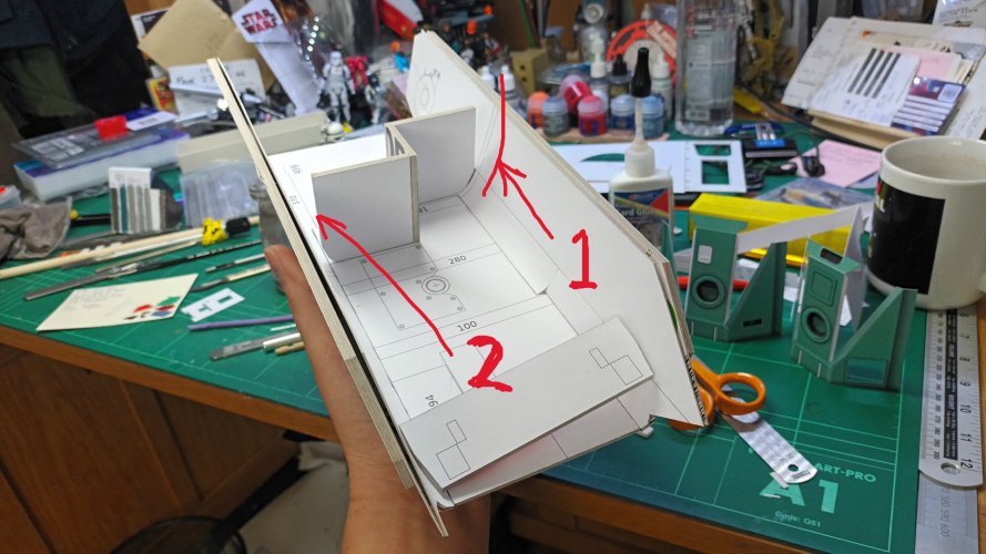

Small update:
Internal walls have been added, I glued the bottom of the walls to the floors at the curved parts first.
Then I'll gradually pulled the walls in to the outer hull sides and will glue everything together.
However during test fitting - the gap indicated '1' is very flush to the internal wall, which is great - However, '2' has a sizeable gap.
So, a bit of head-scratching is going on here to figure this out - Front glacis plate and rear hull plates seem to be the correct width, but not quite sure whats going on?

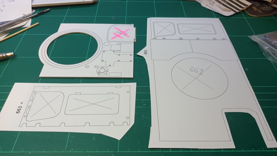

I have jumped forward to some upper hull plates - constructing this easy flat panel should give me my width to check my measurement across the top.
As this tank is becoming heavier, and will no doubt pile more pounds on, I have strengthened the side walls on the wheel mounts.
No lamentation of these parts where called out, but I'm going on instinct these need to be better - I might even fill these with some decorators filler, we'll see.
Test fit of the wheel mounts, hopefully all the curves will be as good as this point.
more to follow soon...
13,498
9,549
This will be a very heavy model. Tou might want to do some of the lower parts with woodd, and the paper laminated over the part. Popsicle sticks and Elmer's Construction Glue is great for permanent solutions. :)
