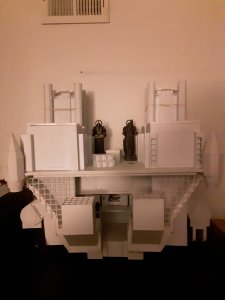

Began the Superstructure Breast Works this week and finally managed to finalize the size of the Cathedral decking. I was off by about a centimeter overall but which will be easy to compensate for.
Below are two images from the basic half finished deck breast works....

Dribs and Drabs:
But in these Summer months it's hard to not take advantage of the wonderful pool weather. Much too nice to be indoors working on plastic models.
But here's a few images to tide over until the rains return.
First the superstructure deck now has forward battlements and the blocks are the beginnings of the center corner towers which do not seem to have any offensive capabilities.
Extending the deck allows for spacing the "Firestorm Redoubts" and also gives room for the fifteen meter tall statues on the Citadel base to be seen more clearly.

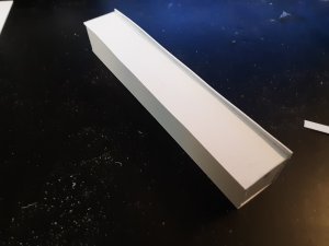

Secondary Towers:
The more I study the image of the Emperor Deck the more detail stands out on this marvelous 3D image by Joazzz2. I was aware of the smaller towers on the superstructure deck but I did not perceive there were ten of them until this week.
What was going to be a minor exercise in tedium has suddenly become a major pain in the arse.
Doubly so because I really hate doing these tiny pyramidal end caps.

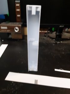

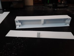

Thanks for the replies. You know, on reviewing the image above I neglected to remark on the crudeness of the construction.
When you are scratch building any model especially one as large as this Titan, you are bound to accumulate a large amount of scrap plastic. There is a lot of internal structure that no one will ever see and there is no point in sacrificing virgin plastic for internal bracing. I keep my scrap in sorted bins 0.015, 0.020, 0.030 and 0.040"/(0,1MM) and use it for internal structure as seen here. Once assembled I sand off the surface to obtain the shape I need. I find it much easier than meticulously building perfect inner components.
