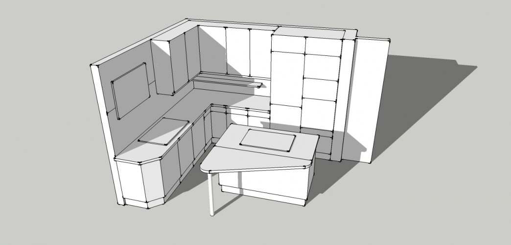

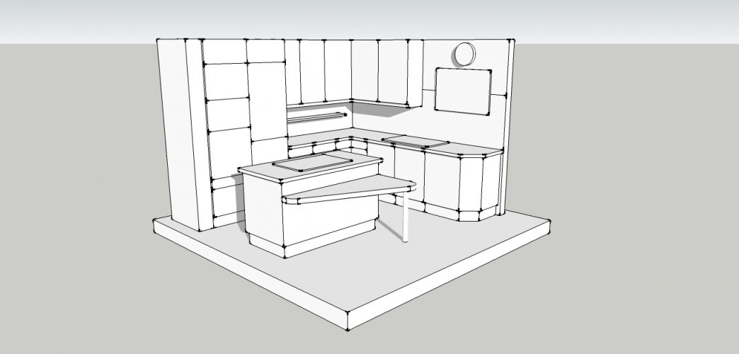

Most of the elements are box-shaped and flat, so easy enough to replicate. I started with taking some measurements in the neighbouring living area which has the same but mirrored configuration. This was done pretty quickly. A few pictures of the whole kitchen and some strategic areas were taken and will be used later in the texturing process.

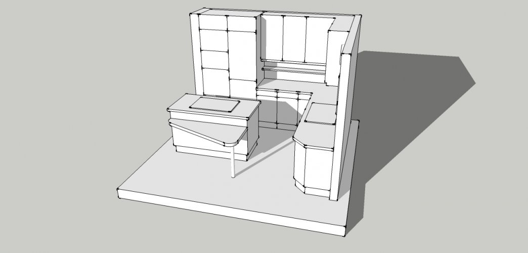

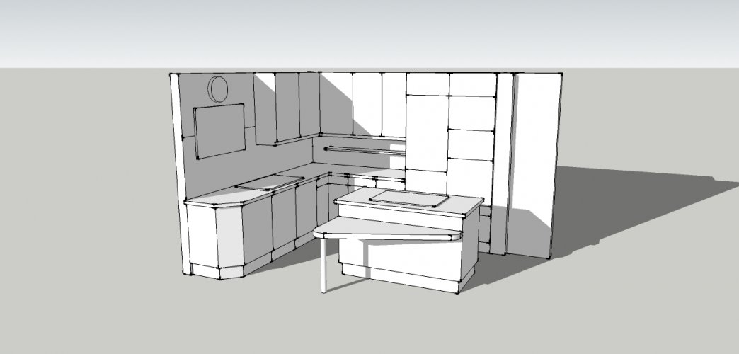

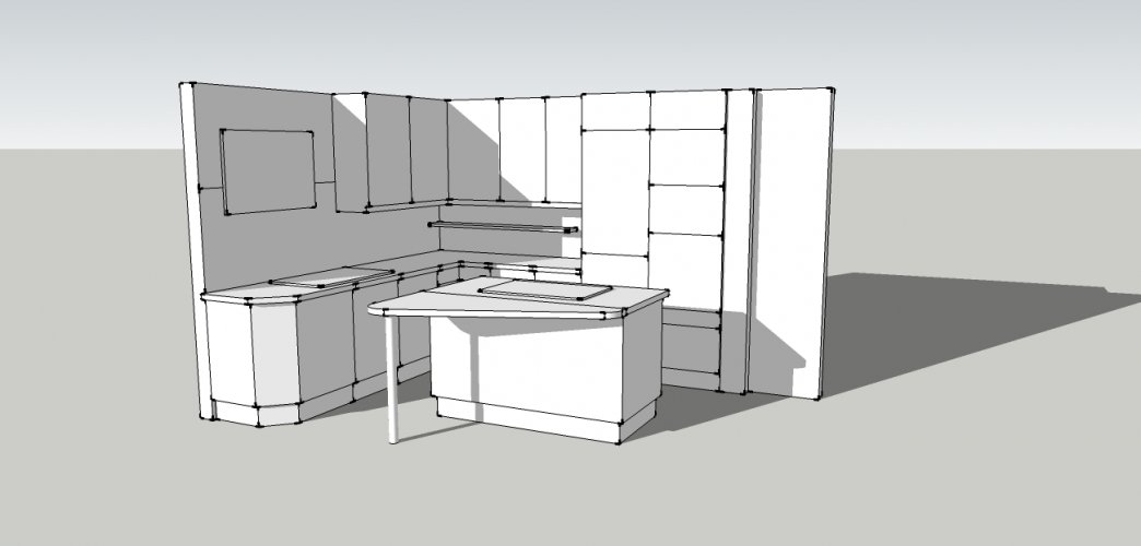

I modeled the parts in 1:1 scale and resized everything later to 1:18. The final model will become cubic-shaped with an edge length of about 20 cm - not too big and not too small.
This looked pretty nice, so it was time for mirroring and scaling.

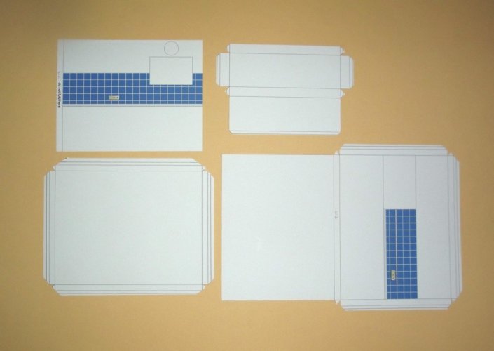

All parts were unfolded using a combination of two SketchUp plugins called "Flattery" and "Unwrap and Flatten" (major thanks to @abdullahsamir for the hint; it does not work perfectly but it does the job and saved me 48 clicks when I unrolled that cylinder ;) ).

Well then. Most of the time went into unfolding and texturing the parts. Preparation is the essence here. The big plus is that everything is pretty straight forward, even the graphics. Printing took place before the black screen of death appeared so I had all parts necessary at the ready to assemble them.

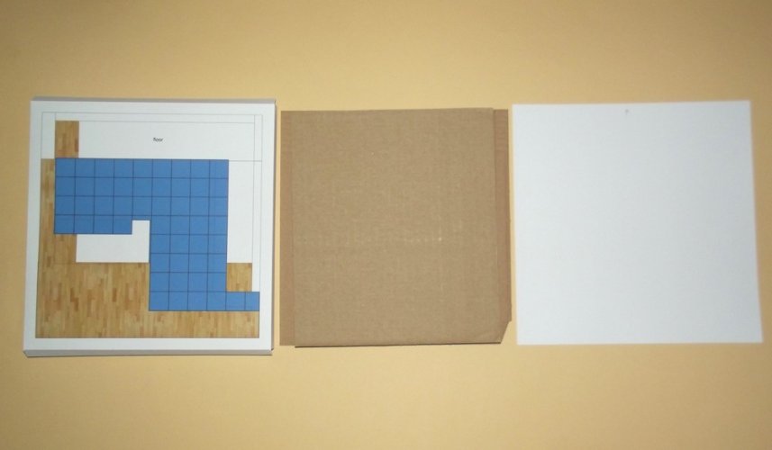

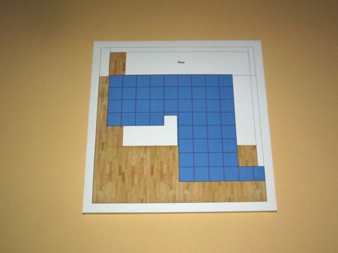

The floor consists of a top and a bottom half. Some corrugated card laminated together to meet the desired thickness was put between them to stabilize the floor.

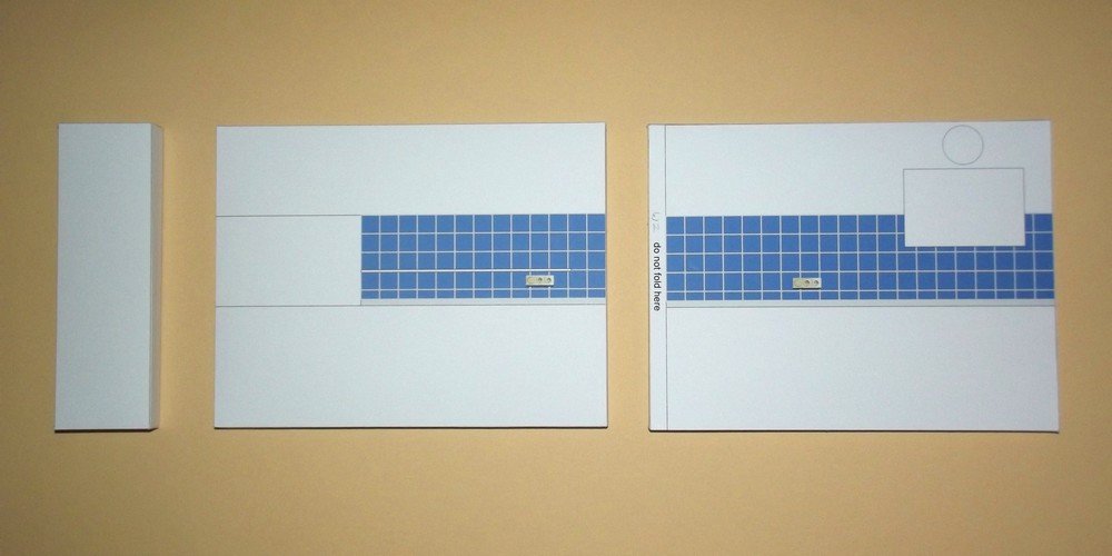

The walls are constructed in the same way:
Again, corrugated card was put inside for strength.

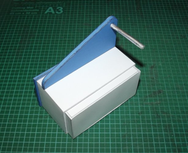

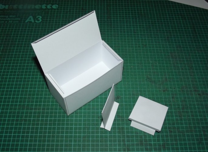

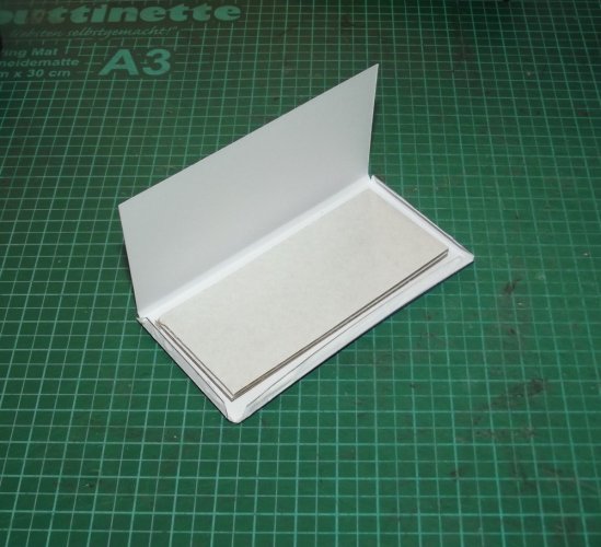

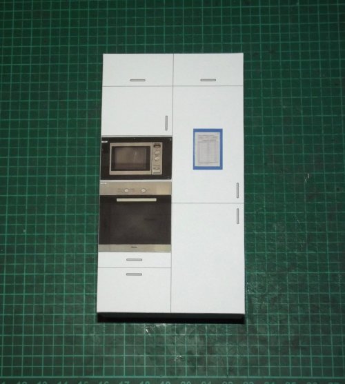

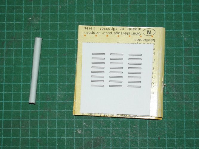

The fridge / micowave / oven combi is a simple box:

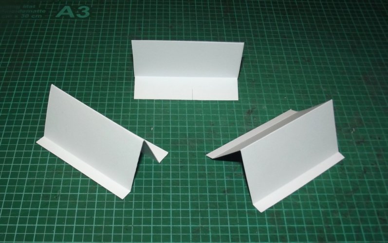

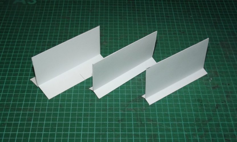

I added some T-shaped formers which I made from some leftover paper.
They were glued into place:
Fridge ready. The sheet on the blue board is a control sheet to document the temperature (important to make sure that everything works properly). :)

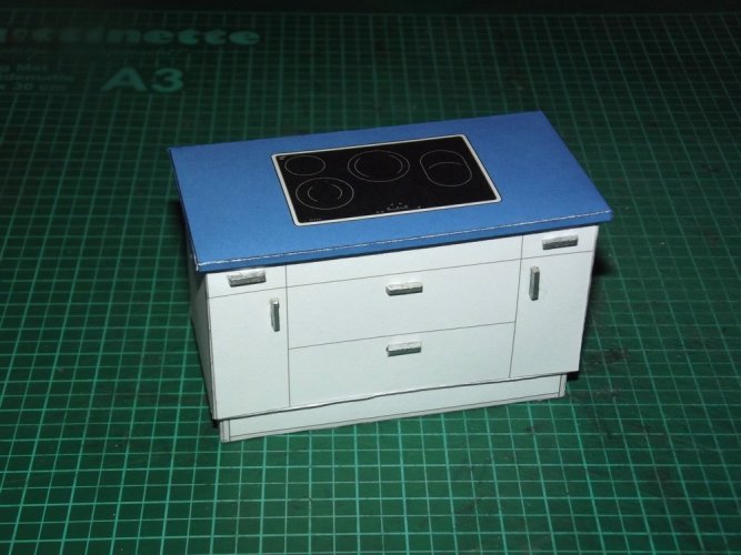

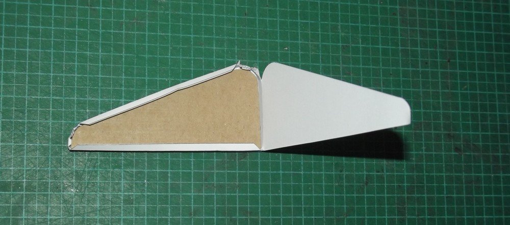

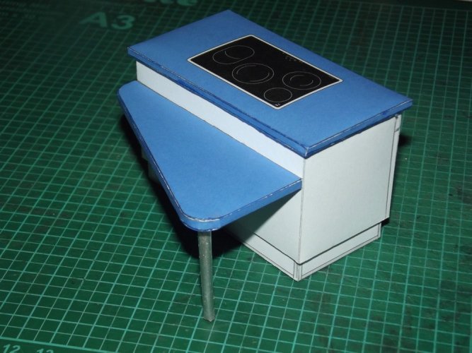

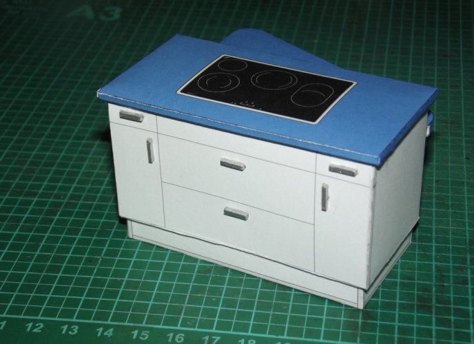

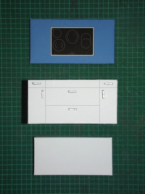

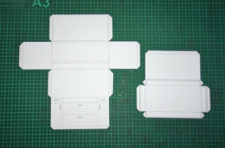

Next is the cooker / table combi. It consists of two plates with corrugated card inside, two boxes with formers made on-the-fly and a pole.

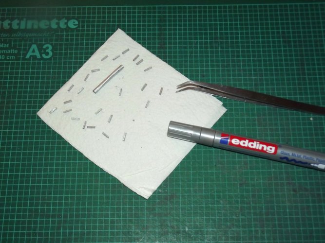

The pole and the handles were painted with a silver marker.
The table was attached to the back side of the cooker (which is actually the front when you enter the kitchen).
Do not look at the white spot on the pole, after going through the pictures I noticed it and painted the pole again. The spot is gone now. ;)

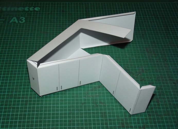

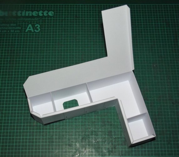

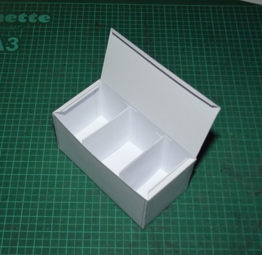

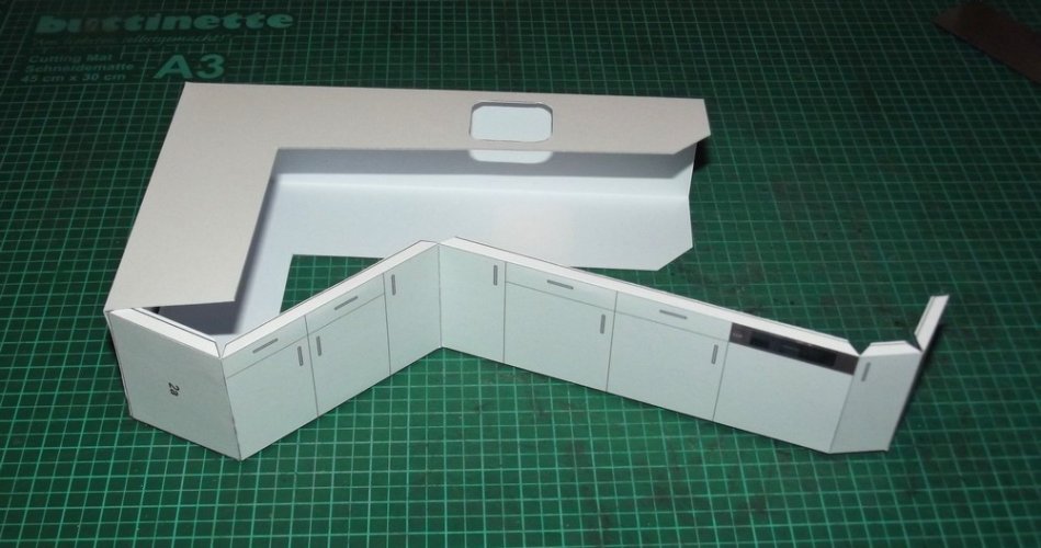

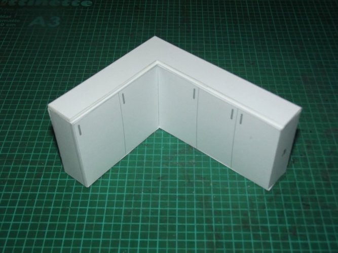

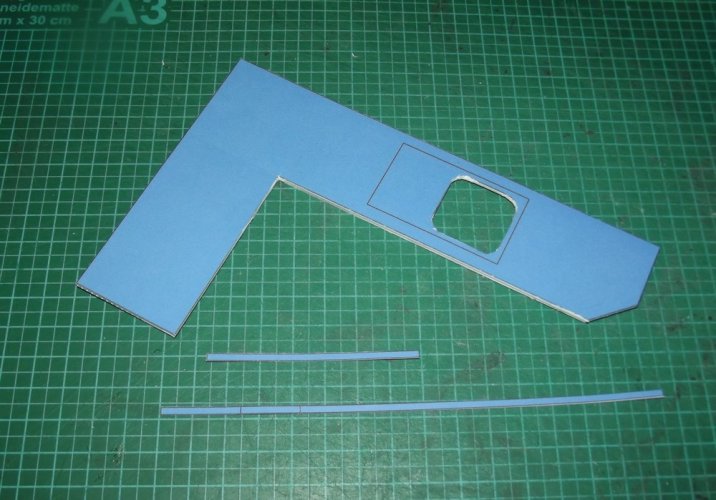

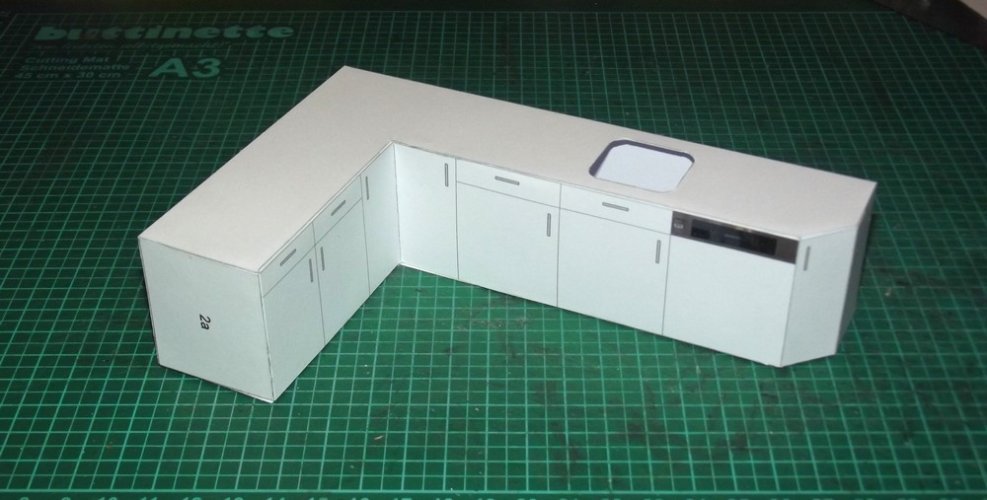

Next came the L-shaped kitchenette with the kitchen sink.
A few formers were inserted:

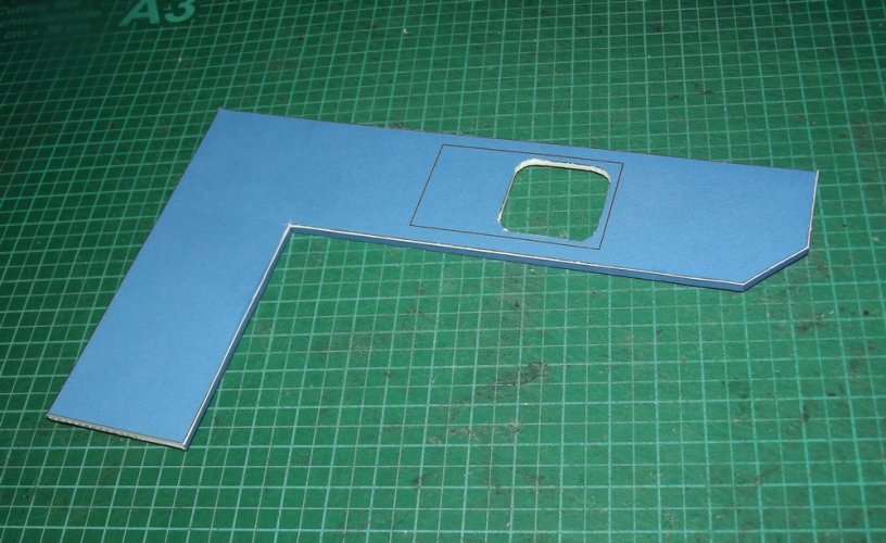

The countertop:
Laminated to 2mm thickness. Two blue strips were used to clean up the edges:

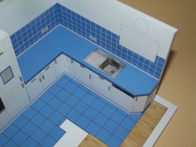

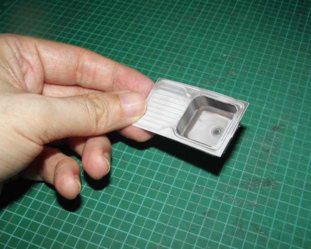

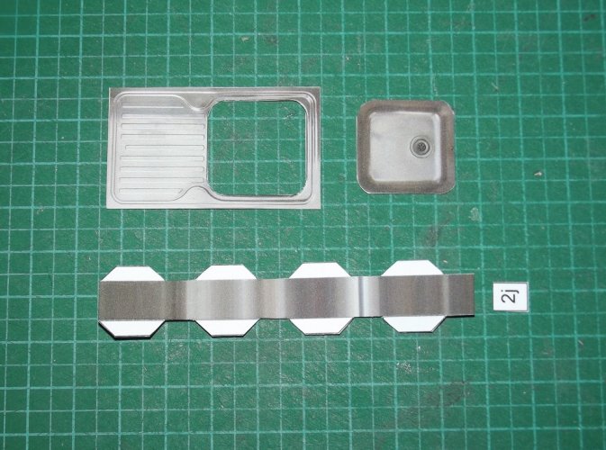

And the sink:
Pretty straight forward work. The dark spot in the upper left corner of the sink is the shadow of the water tap which will added later. It is not a dirt stain! ;)

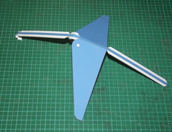

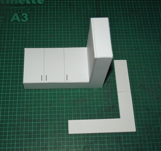

Finally the wall cupboard:

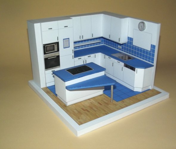

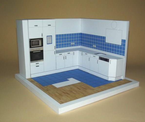

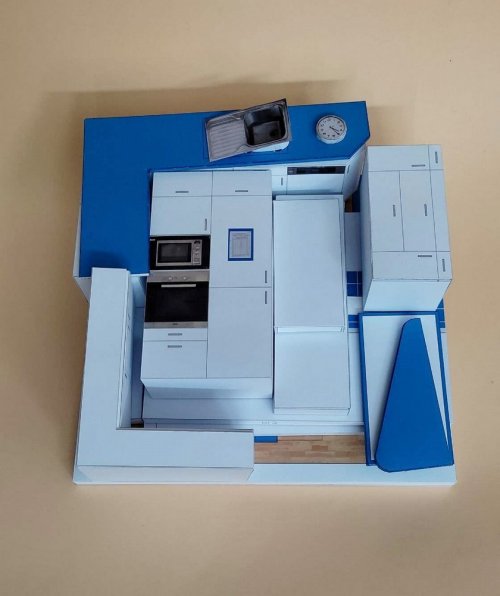

The result: Kitchen-to-go! :)

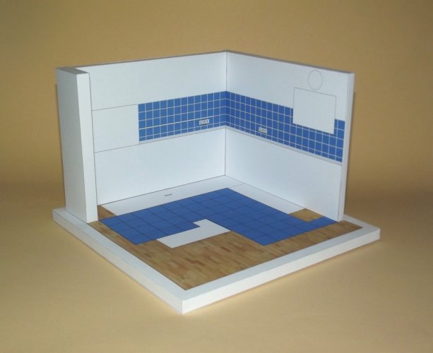

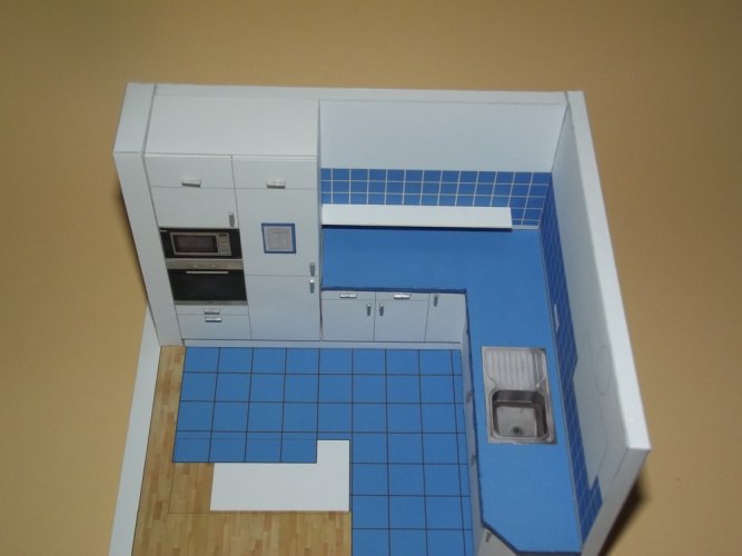

Now it was time to put everything into place. First the walls:

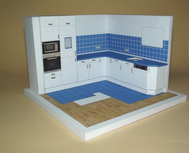

Then the other components one by one:
The sink fits like a glove! :)
The cooker table is not glued to the floor yet because I'll need to add some deco to it. Much to my surprise there were no fitting issues at all! :)
