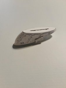

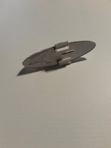

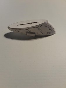

Next Update: Neck is done.

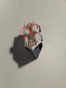

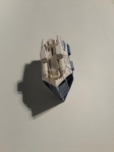

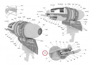

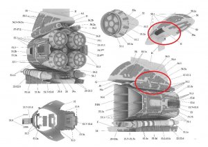

Note: found a problem with the instructions. In the instructions there are 2 blocks attached to the engine pod, and fits into voids in the neck.
If you attach them to the engine pod, the neck will not be able to lock into place. My "Fix" was to glue them into the voids, thus avoiding the
problem.

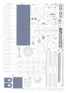

Found another problem. There are 2 parts labeled 85 on the different parts sheets, one of which should be labeled I2a, as shown below.B-Wing Starfighter_Page_16.jpgB-Wing Starfighter_Page_10.jpg

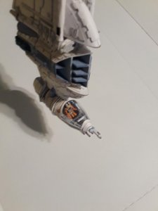

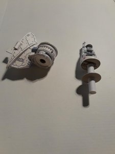

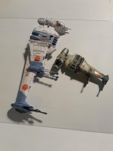

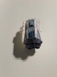

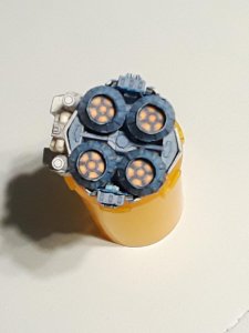

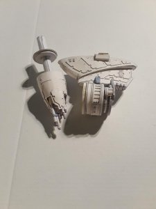

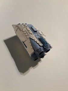

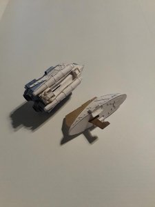

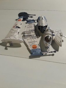

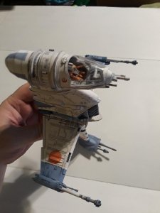

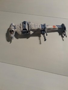

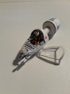

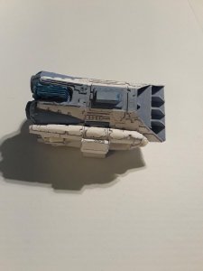

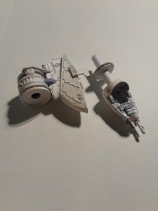

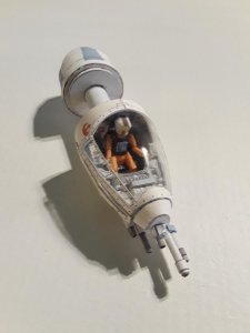

Update: was able to spend most of yesterday working on this, and was able to push on quite a bit. I plan on working on the pilot today and maybe get the heat formed canopy done too. Oh... I have the seat done as well but it is not pictured as I may have to modify it for the pilot. not sure though.
13,503
9,559
Al these components pieces are superb. The engine module is fantastic!! :)
12,552
9,951
OK, this model looks FANTASTIC! Had I not followed this thread, I would not believe that it is made of paper/cardstock. I looks far better than the plastic model!

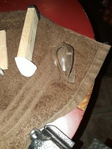

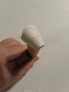

If you have time would you please explain for all the Heat and stretch Method... my question is, " how you get the mold"?
Reactions: Rhaven Blaack
ennder
Jul 26, 2008
458
1,110
83

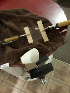

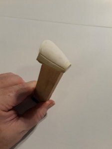

Ok. The heat and stretch method. The first thing I do is make the canopy "inside out" because you want to fill the inside with the clay or putty or whatever you decide to use. I use Sculpey clay, because you bake it when you form it into the shape you want and it will then keep that shape. You can get it at most hobby shops.

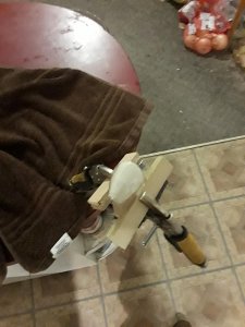

once you have your "buck" made attach it to something that can be easily held in a vice or by some other device. You will need both hands to do the stretching part.
Next you will need some "sheet" plastic. This can be the flat section of any "bubble type" packaging. in this cast I was able to "liberate" a piece
from the box of the Beard Trimmer I just bought. I use 4 pieces of 1/4" wood to hold the sides of the plastic to heat and stretch. I heat the plastic over a burner of the stove, and then stretch it over the buck held in the vice attached to the counter.
after it cools on the buck, take it off and trim the excess plastic and there you have it.
