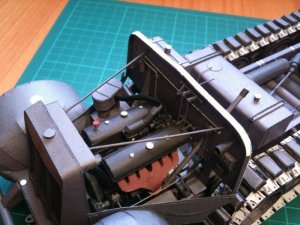

    continue from previous post
    the mechanism is movable
    i did a quick animation to show you how it works
    [​IMG]

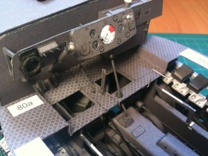

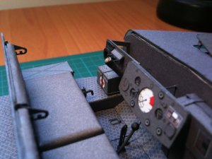

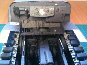

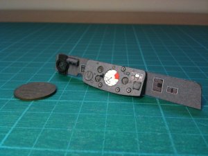

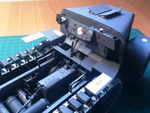

    Hello modelists
    today i assembeled dashboard
    at general there were no porblems, but i was in need to cut a little at the bottom of the panel, because the shaft got in the way
    also i did imitation of a glass covers on the clocks and put some levers
    bugs:
    none

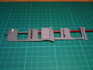

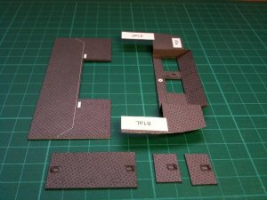

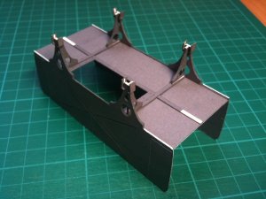

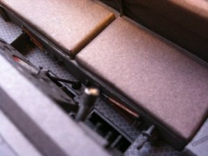

    when i prepared next parts for the assembling it turned out that a lot of parts are missing:
    72b -the inner side of of driver compartment sidewall (a big one)
    82b - the bottom side of middle mudguard (also a big one)
    74k, 74l, 74m - those are parts of big hatch from rear (on second picture)
    a minute of silence...
    got myself together and continued the project
    eventually, no matter how i tried, the color of the printed part, of the side of driver compartment, didn't match (part 72b that missing)
    so i found the spare color at the end of the journal and made the parts from it
    also i assembled the floor
    as i wrote, parts 74k, 74m, 74l are missing too
    as usual, i cut those from spare color

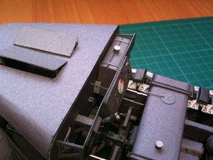

    i am starting to get used to it and its no god :)
    when i tried to insert front floor to its place, the fuel tank got in the way, so for future assembling - glue it after you put the floor in the place

      45

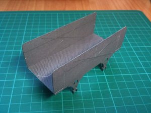

    hellofriends
    i did another push and assembled front floor with all the levers and pedals
    all of those are connected to proper places, as you can see on the pictures
    left pedal connected to gear coupling
    middle pedal connected to air pressure cylinder that responsible for the brakes
    right pedal connected to engine throttle (doesn't seen on pictures)
    left lever responsible for activating tow drum and connected to the end of transmission box
    middle lever, handbrake, connected to two stoppers on shaft drums
    left gear lever connected right to the gear box
    also i assembled rear compartment walls
    the story about missing parts still doesn't end: middle part of front wall is missing. X strips on the both walls are missing too
    bugs:
    part 75b - missing. made from spare color
    part 75g - missing. made from spare color
    part79j - not right, cannot be glued to place, no space for it. disposed

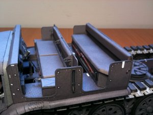

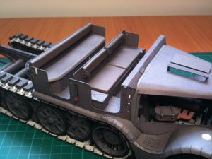

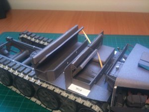

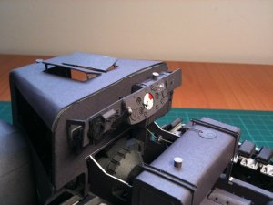

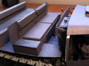

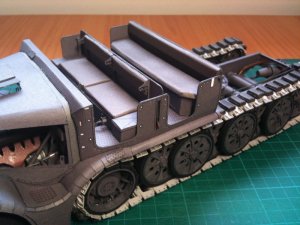

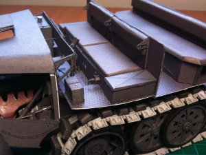

    continued with driver and soldiers compartment
    put seats in place.
    they can be raised

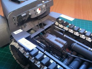

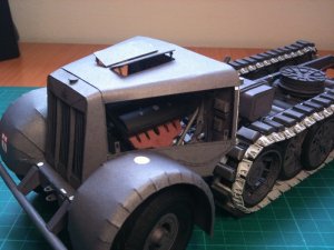

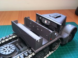

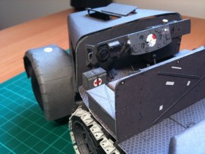

    Hello
    some progress with the cabin
    middle mudguards didn't fit well, so i was in need to cut and adjust it properly
    also they weren't in line with front mudguards, but i fitted the step between them somehow
    sidewalls also got a problem. the pockets of left/right signals (red ones) were interfering with boxes inside the cabin. cut and adjust, cut and adjust..
    eventually i assembled the cabin somehow, but i don't like the result.
    from other side, there's no other way, only if i will break half of a model to fit it properly
    i must confess - i lost all the pleasure of building this model
    now i only want to finish it

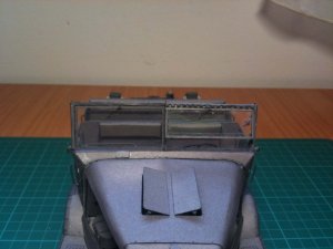

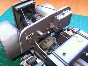

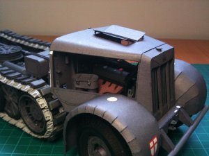

    11

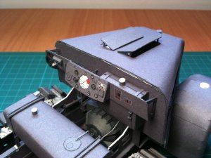

    Hello guys!
    thank RealHawkman
    after a wonderful vacation
    i am back to my sorrow project..
    i made some instruments and placed them in the cabin
    as usual, a lot of parts were missing, especially all the fastening belts
    bugs:
    missing parts 111a, 111k, 111j, 111g, 111h, 111i, 111l, 111m, 112j, 113d, 113c, 113e
    did all of them by myself from spare color
      File size:

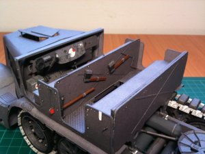

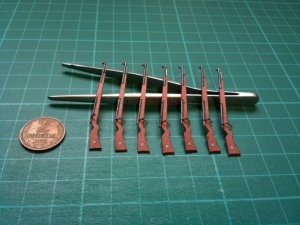

    I've assembled 7 Mausers, but the wire, for the big handle they must be attached to, has been ended, so for now i am switching to front glass
    bus: none

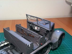

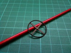

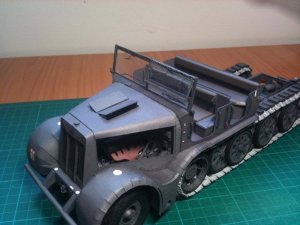

    I've assembled front windshield.
    The design of it was unbuildable, but i managed somehow to bring it to proper look
    Also i attached some handles and the steering wheel
    Mousers will be placed at the end, when i will fill completed model with al kind of "garbage" :D
    bugs:
