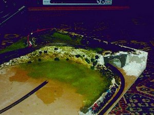

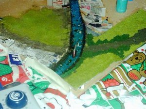

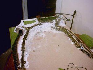

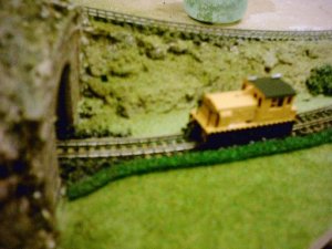

  6. jimbob005
    jimbob005 New Member
    Nov 26, 2005
    28
    ok i looked at the water part and heres what i came up with (after waiting for it to come from the us) so i wil put up some pic thanks for all the nice and helpfull info on the gauge thanks to all of you
