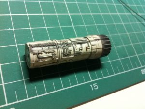

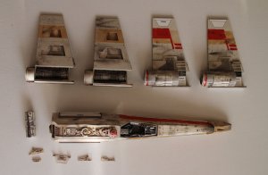

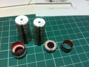

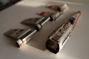

Finaly! I am cutting and gluing paper together again. And it feels sooo good:). After period of designing and texturing new engines:Computer: I am now building them. Template works well, all fits together nicely witch adds to my happiness:). I will post some build pictures soon and will add this new parts to resource section.
I added and will add lot of paper to the wings so now I am worried that wings will be so heavy that they will not hold on the fuselage. I must figure out how to reinfoce their connection.

Make spars out of Popsicle sticks, or some other type of wood. You have the advantage of having Rhino t print out a template. I would have the spares for the wings through the cockpit. If they are going to pivot, the wood will be an asset. ;)
Reactions: bigpetr

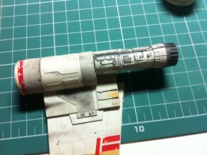

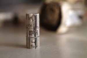

That would be very fine solution, but because of engines, there is no room to stick such reinforcement to the wing without being visible:(. I was thinking to reinforce the joint with strips of paper from all sides (top bottob, front and back) but not sure it will work. Must do some tests.
Thank you for sqish elaboration:).

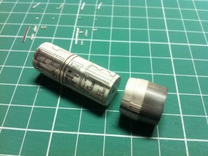

Building engines did not last long, because after making one engine I noticed they are too narrow:realmad::headbange:. After lot of persuasion to myself (dont want to sit in front of the computer again so soon) I decided to widen them. Easy and fast task to corect 3d model and unfold it, but to rework textures was pain in the ass. But it is done now and one bacis shape of one engine almost finished and looks as it should.

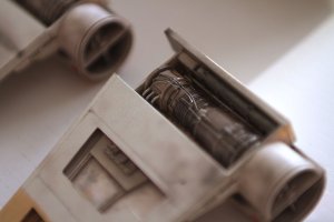

WOW boy! I've lost the notifications from this thread so I wasn't here for a long time and... what I've lost!!!!
This is a whole new level of cardmodelling! Never seen an X-Wing like this one before, in ANY material.
