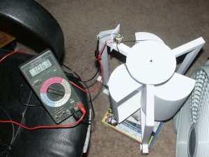

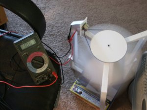

Here are some photos of a Wind Turbine I did several years ago (2010).
One was taken without a flash, blades are blurred, one was taken with a flash, blades stop action.
No fake tricks were needed!;)
Mike

can you relate how many amps that is, or volts? maybe how fast it would recharge a 9 volt battery?
that's the way to build a windmill I think, tall as the propeller blade kind, each one with power out to grid, stacked up a pole, in a wind farm, the reservations are nothing but wind, and could be power farms. no birds killed as much anyway. they are probably driven mad by sound, or vision or magnetic misguidance. these kind could reduce kills. so that's two things going for that design. the coastlines have wind all the time too. easing the grid is a good idea and fossil fuels will last a little longer or kept in reserve for industry. great job!!
That is the volts showing. Amps were so low my meter wouldn't read them. electric motor cost $4.60 from Tower Hobbies, carbon shaft was$2 and the flanged ball bearings another $2 each.
Used to sell kits on eBay, but the supply of bearings went away, so stopped selling them. Built a couple of bigger ones to run a car alternator. One is going to go to a friends cabin up in the mountains. It is made using waterproof paper from Yupo Paper.
Original plan was to mount two of these to existing power poles and supplying power to the grid.
BTW measured the fan "wind speed" using a handheld anemometer. 9 mph at the turbine blade.
Mike
