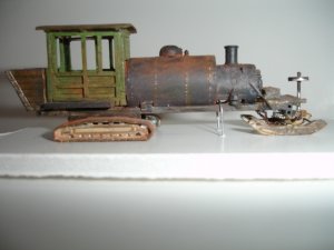

    While doing research for my logging module I came across an article about hauling logs back in 1900. Pictures of a steam driven tractor. Modeltech Studies makes kits for HO & O, but none for N so I kit bashed one. The first picture is of real one and then my kitbash.

    Very nive model. what did you use for the tracks?
  13. willy4
    willy4 Member
    Jan 17, 2008
    76
    tracks
    Glen
    I used the tracks from a Backhoe kit made by Railway Express Miniatures kit #
    2161. The water tank is a 1/2" brass tube with furnace tape rolled around it with a pounce wheel on the back side to make rivets. The smoke stack and steam boiler is from an 0-6-0. The frame is 3/32 brass. All the rest are scatch built.

    I too I'm interested in the Lombard. I've hit a road block with my HO scale version. Need some help with the chain drive. How did you build the one on your model? To date I considered the drive from Jordan trucks and NWSL drive chain but have not been happy with either. Any suggestions?
    Thanks
    David F
  19. willy4
    willy4 Member
    Jan 17, 2008
    76
    Lombard
    David
    Not sure if you mean the tracks (chain drive). At first I thought of using the tracks from a military tank, but found a Railway Express Miniatures kit and used the tracks from the kit. My tractor is in N scale so I am not familiar with HO kits. Modeltech Studies have a HO kit.
    Sorry if I can't help you.
    Bill
