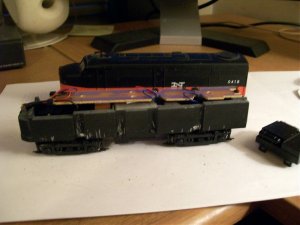

  3. eightyeightfan1
    eightyeightfan1 Now I'm AMP'd
    2,781
    If thats the same FA mentioned in your " How Do You Open The Cover", thread. I find that hard to believe. My Walthers FA's frame is nothing but a big chunk of metal. As you can see, it takes up most of the free space of the shell.
    Its pretty weighty...

  7. PrairieTrains
    PrairieTrains Member
    May 25, 2008
    31
    Yes- the opening instructions were my inspiration. Your right - it is full. Just found room for a little clay and a couple of washers. I probably will have to take all that out to put in a decoder - but that is months down the line......Pat
