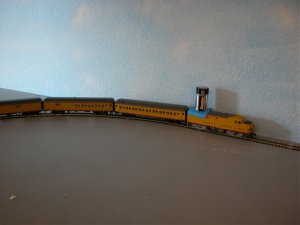

    Was testing this new set with some preliminary track and grades. As you can see below, I had to put a box of screws on top the loco - just to get it to begin this MILD grade without stuttering and slipping and requiring full throttle.
    I'm sure that part of the problem is a cheap loco (I bought it for testing and potential abuse) and the fact that the track is not secured. With the added weight it operates quietly and smoothly. Is that normal? What would you suggest. Thank you in advance for your advise. Pat

  2. Mountain Man
    Mountain Man Active Member
    Jan 20, 2007
    1,612
    Looks like it might be lead weight time! :cool:

    I guess that gives a whole new meaning to ballast! As you can see I had to put the "Energizer Bunny" on top just to get it to run on its supplied track! No grades! I'm new at this but I guess you have to take the cover off and find some way to cosmetically add the weight? Can you pour BB's into a window? - just kidding:p Lead weights put toward the back? Thanks for the help to a real newbie - but glad I get a chance to test out some ideas before I get carried away with the layout. Pat

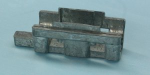

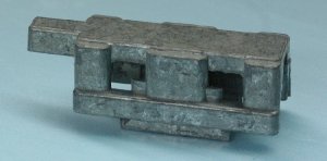

    I've always thought that the Protos, while looking good, were a bit "light in the loafers" ;):p - if you want an FA (of sorts) that really pulls well, the old Model Power units are pretty decent, especially considering their price. You can also add a lot of weight to them - the modified units shown below, both powered, weigh a combined total of over 50 oz. :-D
