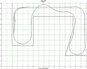

  18. Nomad
    Nomad Active Member
    Sep 26, 2006
    1,634
    Floyd, I did this last night. I have not calculated grades or clearances yet. To me it looks kind of toy like, but see what you think. On the left you can see where a yard would be. There could be a another yard in the right hand loop, since you want passenger and freight trains. I think both yards would end up being elevated. The track would start climbing on the right, go over the curve and then start back down. If your interested, I can try to figure in a double track for 2 trains. Curves are 20" radius, the biggest you can get on that width and still stay away from the table edge. Kind of tight for passenger trains. If you don't like it, you won't hurt my feelings, believe me.
    Loren

    Loren thanks for all of the work you are going through. I really like the idea of a double track operation and it would make things more interesting, but not to challanging I hope. My grandson keeps chomping at the bit to get things going but he understands that we don't want to do just anything to get a train on line. He is going to be eight in December and has always taken a very keen interest in trains. At around the age of three he even had me stop so that he could touch the tracks at an old feedmill side railing.;-) We are patient and your layout idea looks good to me. In the meantime I am about done with the drywalling of the room and soon will be ready to paint and set up the tables/track again. Again your help is really appreciated.:thumb:

    If you do intend to go with a double main, can I suggest that you don't simply double the route around the layout? Make a more "scenic" route that can be completely isolated from the resot of the trackage so your grnadson and other visitors can run something "round and round" without 1) having to throw turnouts to make it happen, and 2) interfering with whatever other operations are in progress.
