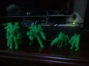

    258
    Looks like a Space Marine and a Kroot....not able to discern what the others are.
  5. Leibolmai
    Leibolmai Member
    Aug 28, 2012
    46
    Two Tau battlesuits. Same character, different weapon and arm position.
