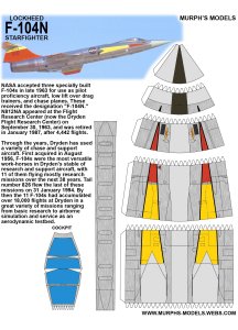

How does one get the aluminum effect with the highlights and subtle shades of grays for recoloring aircraft bodies with Photo-Shop?
Here is a sample.View attachment 154460
It looks like they did a layer over the original art and set the layer to darken with a gradient between two shades of gray. Then they added another layer over that with gradient rectangles and squares laid out in patterns. You can also find free aluminum textures online, make a selection of the plane body then go to "edit--paste into". Photoshop will make a new layer with the texture showing in the shape that you selected. You can then select that layer to fill "darken". You can do the same thing with square and rectangle panels to make them lighter or darker. Or you can layout panels in more than one layer as just solid colors, make a selection and "edit--paste into" the aluminum texture. I've attached several aluminum textures that I found in a few minutes on Goggle Search. Tried to find stuff that didn't have a copyright in them. The textures can be lightened or darkened in Photoshop by going to "image--brightness--contrast" or "image--adjustments--levels". I usually copy the color plane markings and place them on the top layer so the grays don't effect them.
