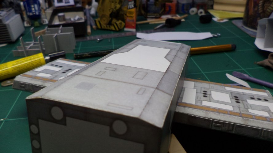

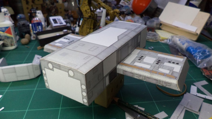

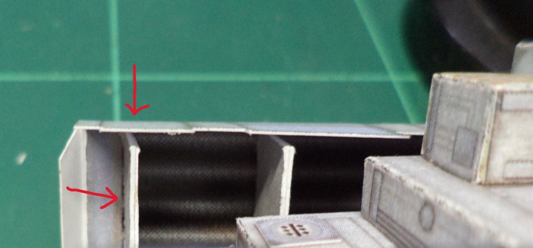

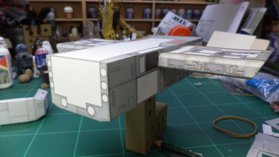

Finishing up on the wing and gluing into the body was next on the list...

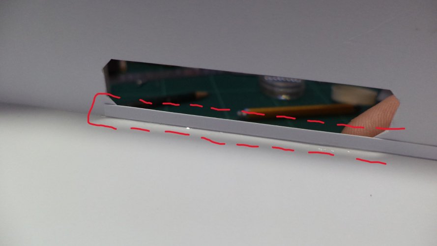

When the wing was pushed through the main body, there was sag where there was no support to hold the surface (red arrows) thus making an ugly gap on the top surface. It was on the bottom too, but not as bad - the blue lines was where I had added the internal wing braces, with hindsight, the wing needed more than five, and probably one right near the opening.
Popping the wing out, I thought of adding a strip to negate the gap.
Strip added to the internal surface.
Wing slotted back in, and the gap was closed - this will have a flood of glue or just painted in an aid to hide the repair. You'll note though, the two blank areas next to the gap fill, which will receive two surface add-ons later. Hopefully taking your eye away from the join.
The strip also strengthened the thin part of the hole, an added bonus.

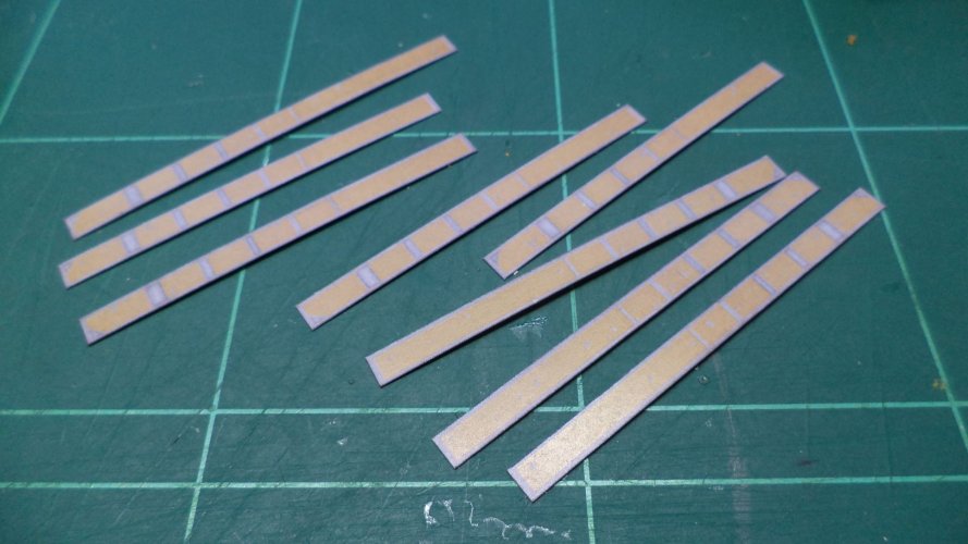

For a break away from major construction, some surface parts were added to the corresponding 'blank sections' on the wing.
ADVISORY - add these 'AFTER' you insert the wing.
Top and bottoms strips for more wing details 'NOTE' the smaller lengths are for the bottom. ALWAYS dry-fit before gluing, as I managed to get one wrong! (yanked off very quickly!)
All together they 'look' very similar.

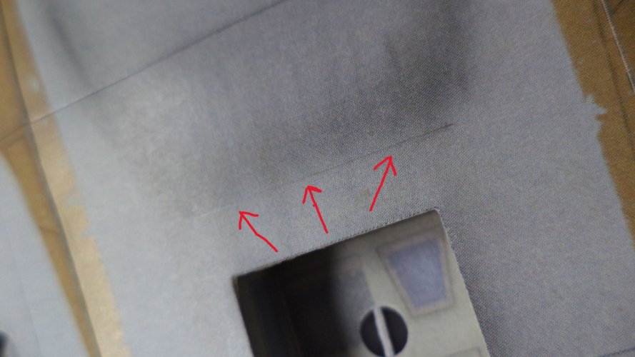

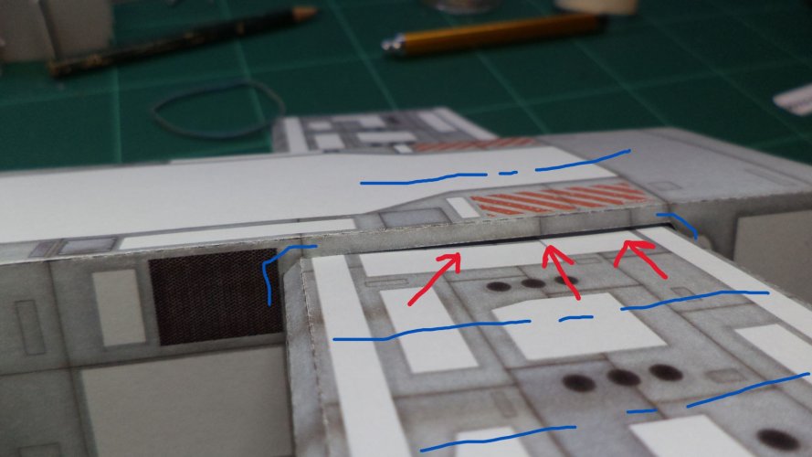

The main-plain looking good, but some slight sag on the surface areas, thus again a nod to adding more, rather than less internal supports - kind of reminds me of stressed skin on old aircraft (my excuse ;))
Bottom glued in, nice and snug.
Horizontals look perfect, with no droop - very happy with that!

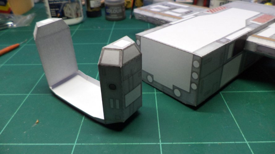

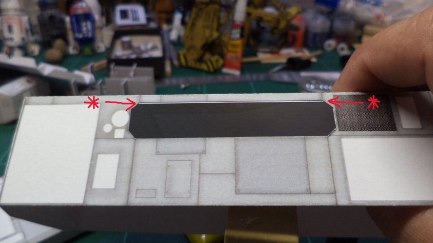

The front nose section was a few steps further ahead, all the glue tabs - which I took my time to glue only a couple a day, had made the whole front cockpit fully formed.

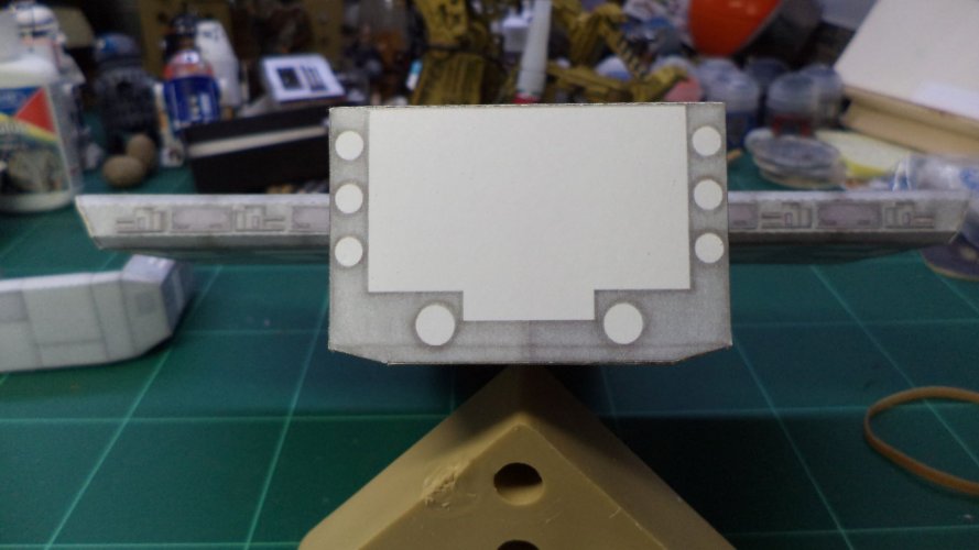

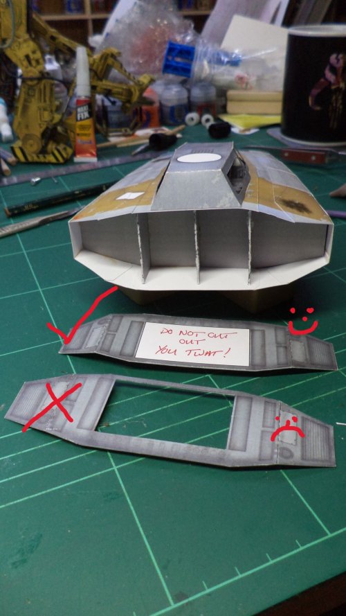

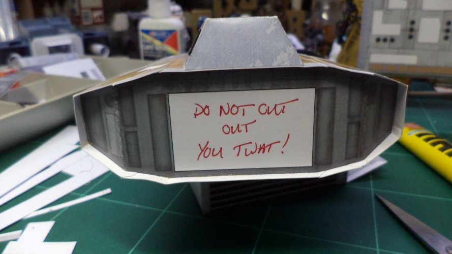

So with the back-plate sitting on the bench for ages, it was time to engage the two parts.
Here's the odd thing - on the parts sheet there's two of these parts, and I found out why - its for idiots like me!
The bottom part was the one I originally cut out, thinking the blank area was to be removed, "no stupid!" all the 'remove parts' on this are BOLD RED!
So to aid my stupidity, I put a note on the back-plate to stop me doing it again!
There is no view of the back area on the CGI plans for this build, thankfully I have a full resource of pics to help out.
As you can see, the part is recessed into the back of the cockpit.
I added some doubled up stock and added these into the corners, which will stop the plate from sinking in too far.
The plate fitted into the space with only minor adjustments. I doubled this plate up with thicker stock to add further strength and bear in mind, the white area is where the droid section glues to, that's 'TO' - 'NOT THROUGH!'
My memoir looking back at me 'think before you cut!'

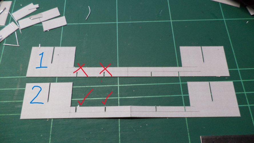

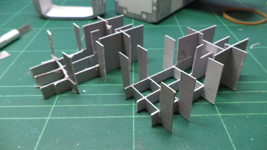

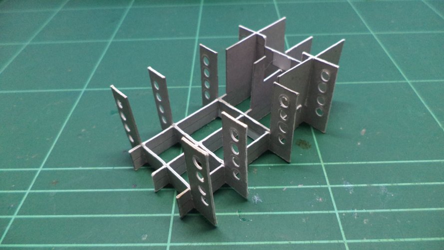

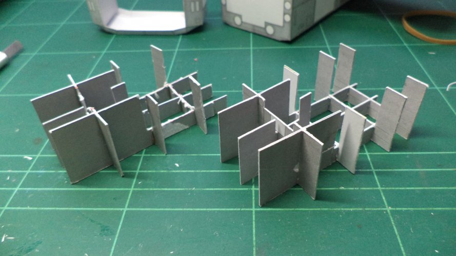

Main structure was reprinted and straight away I made a mistake! Cue tiny amounts of swearing, followed by a trip to the kitchen for a drink!

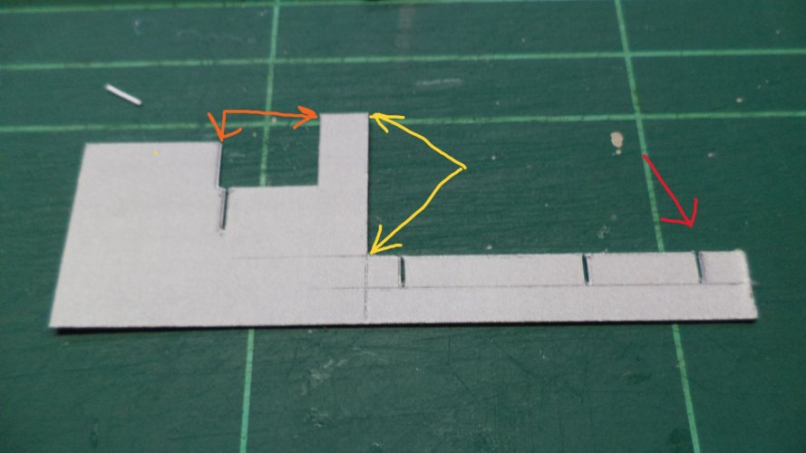

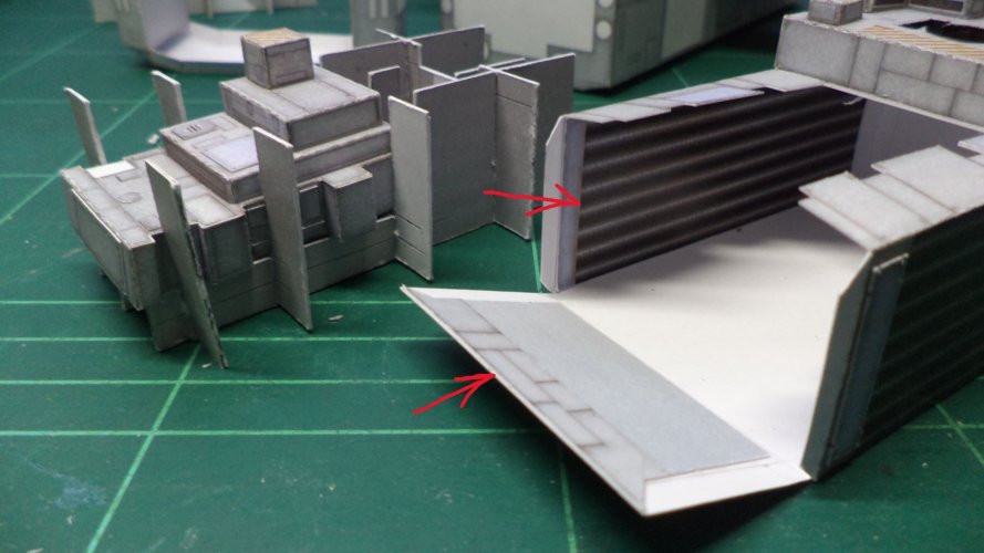

As I'm now adapting the part to my own specs - the plans were in my head, and not jotted down - hence the mistake.

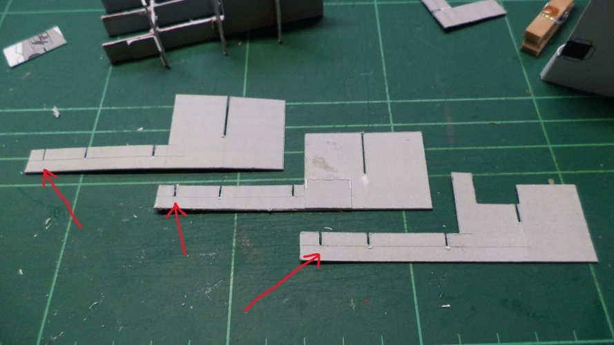

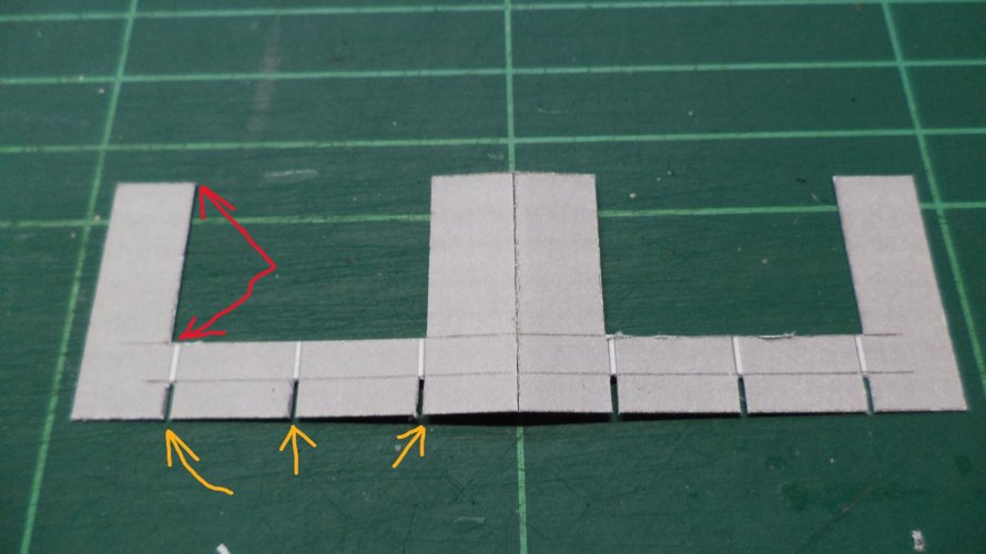

Part 1 - I cut the slots up, rather than Part 2 - slots up!
The middle spine was adapted to aid this part to slide in. I had already added the droid socket, so the required depth was cut off the back on this section (ORANGE ARROWS) to go under the socket.
The yellow arrows denote the required depth I needed and the red denotes an extra slot 'up' for another spine piece which will become clear later.
Spine rib piece, red arrows showing new cut depth and yellow arrows showing new slots 'down'

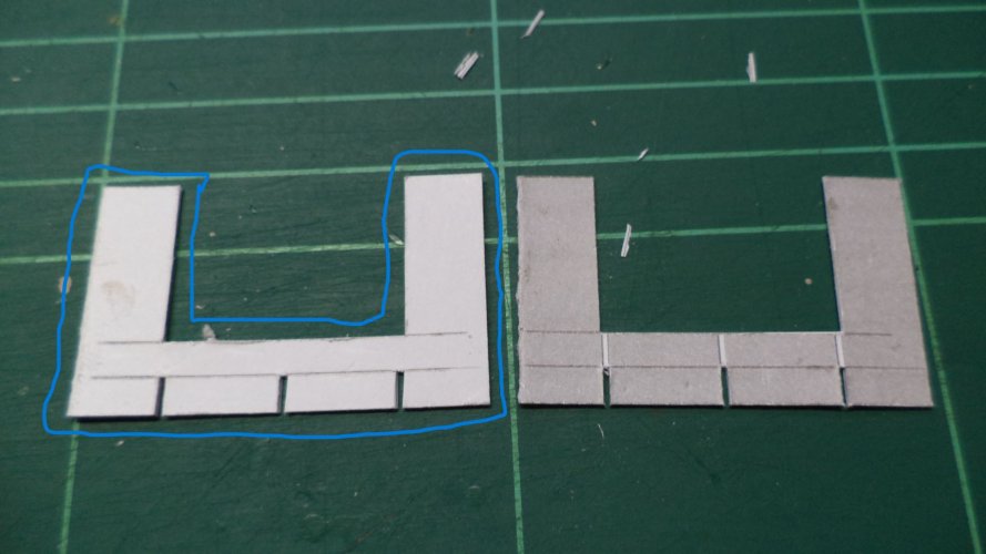

A third rib, outlined in blue, was made by copying the others - 'slots down'
Repair to the 'mistake' - I cut the part out, outlined in red, turned it over and just spliced two slabs either side. job done!

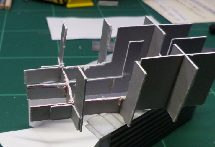

All main spines done, with the extra slots 'up'
Construction complete 'NOTE THE EXTRA RIB AT THE FRONT'

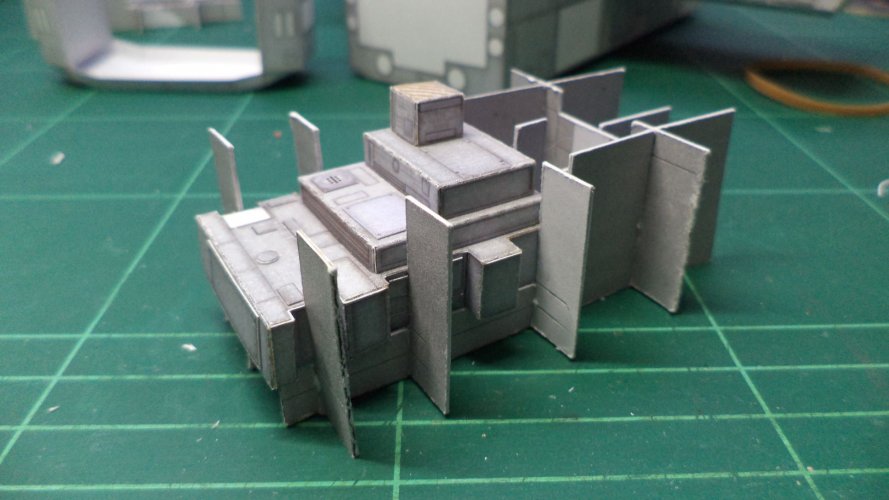

Test fit of the part which needed to be 'sunk'

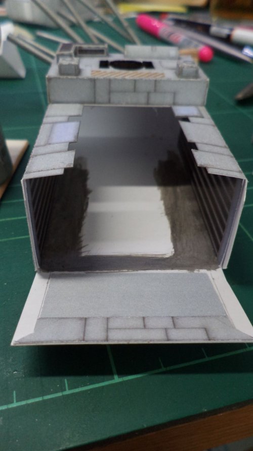

Now as the pit was now on show, the inside needed some extra detail.
The parts which were mis-printed some weeks ago were added here - side walls and the front flap/wall needed 'extras'

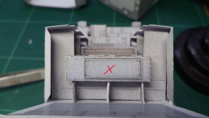

Structure dry-fitted into place to check for errors or other such problems. Red X denotes this part of applique needs to be removed.
The third extra rib was added to help the frontal part from floating in mid-air. Easier to see in the next photo.

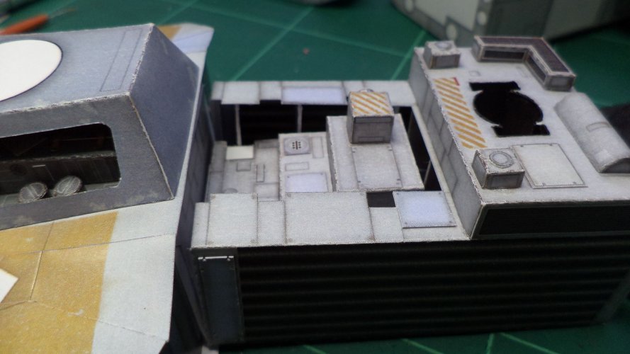

Dry run to see how the cockpit and mid-section look.
A relief to me that this part has nearly come to a close.
It was a frustration to begin with, but a learning curve in righting a wrong, and also led to some discarded parts being used after all.
The internal parts will need some edges touched up with paint before becoming entombed and I may add something 'extra' in there!

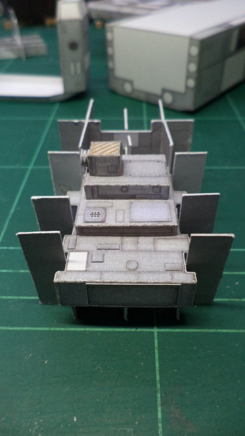

Well we left off last time with the new internal structure constructed and test fitted, which meant some prep work was needed.

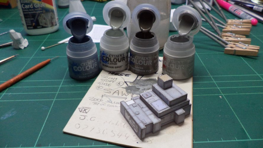

Suitable paints were opened and all cut and rough edges addressed with the wonder of pigment.
The test fit showed the floor was visible by looking down, so some paint was added by the hairy stick.

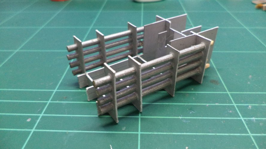

As this section was a major intersection between the cockpit and the rear section, there really was not much going on in this section.
You would expect all sorts of cables, pipes and wiring coming through here!
I hatched a plan to make it a bit more interesting, and less-like a box with no tricks!

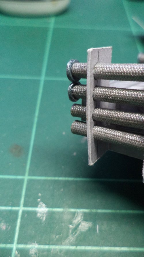

Step one, bung a load of holes in the uprights...

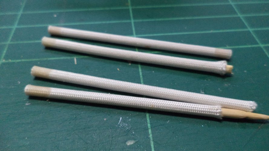

My friend was throwing out some ceiling lights, which had some small wires covered with some nice braiding, I thought I'll have those they may come in handy - so yes they did!
Step two - I pulled off the braiding and inserted some wooden rod with a smattering of super glue on one end to stop any fraying.
Step three - splash some oily silver coloured paint on those rods shove em through the holes, and "hey presto!" it starts to look as if there's something going on!

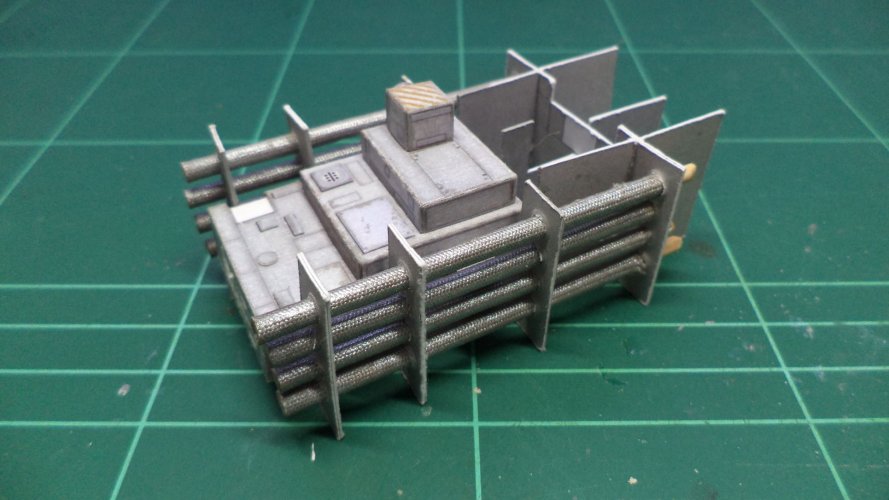

With those three steps completed, the greeblie insert was added to the mix.

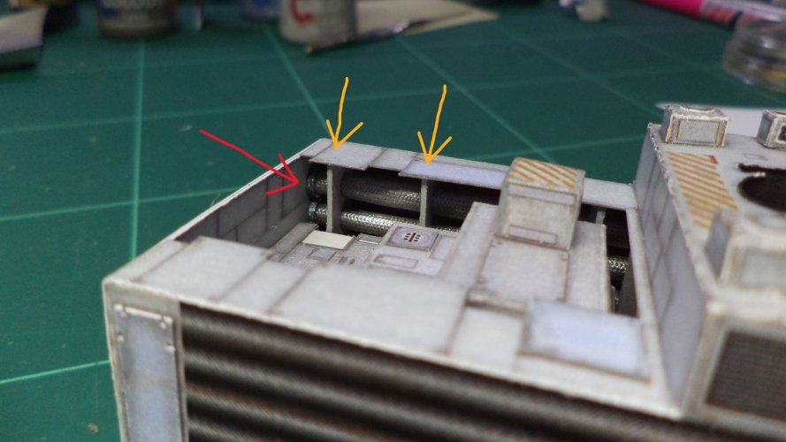

The top two rods on each side are the most visible, and when butted up against the front wall they don't really 'look' as if they go anywhere.

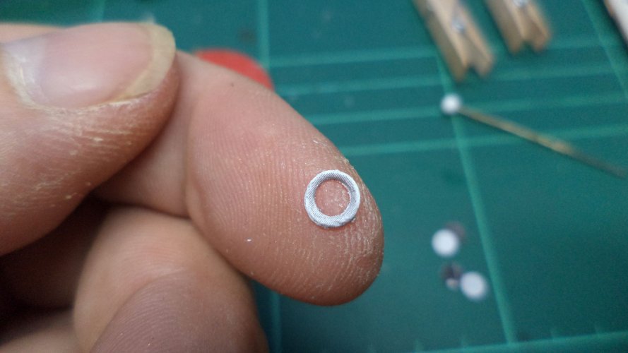

I cut some discs and punched out the middle, which created collars to add onto the ends.
Collars added to the ends with a lick of paint too...
With everything inserted I was very happy as to the end result. Red arrows showing, well to me, that they connected to something and the yellow arrows - showing how by putting in the extra rib allowed me to connect with the overhanging plating.
Those with a keen eye will notice the blank area, the greeblie for here will be added later.
Finally this section of body is complete at long last!
With this little bit of extra detail I really think it looks as if its 'doing something'

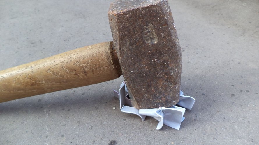

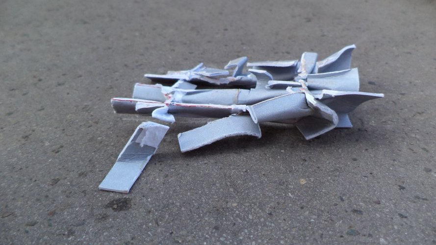

As to the old part, vengeance was mine! Cue the lump hammer and my mind & body were purged!
The demise of the old part was passed onto the supervisor for his inspection of total inhalation!

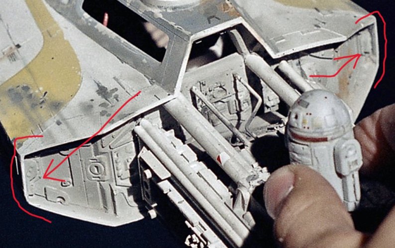

I have seen from a few members renewed interest in a certain members Y-Wing, so whilst I'm having a break from other projects. I thought it best to carry on with my Y-Wing build,
I'm trying to catch up where I left off, but I think we are in the right ball-park, hopefully!

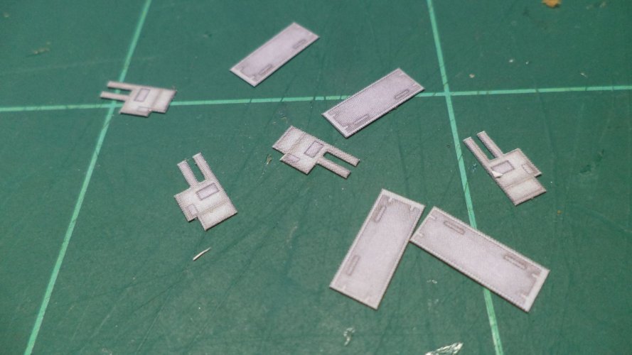

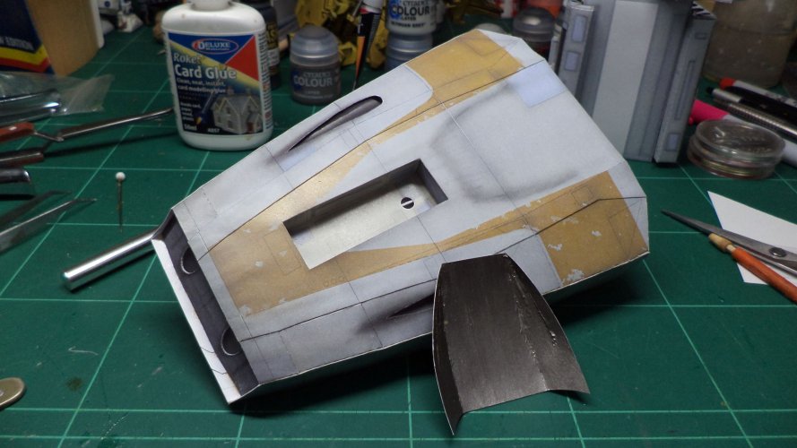

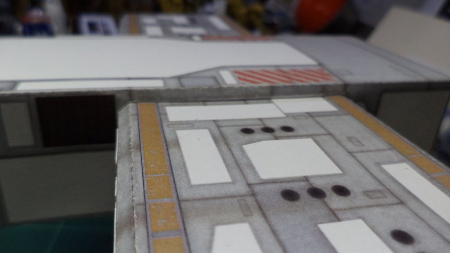

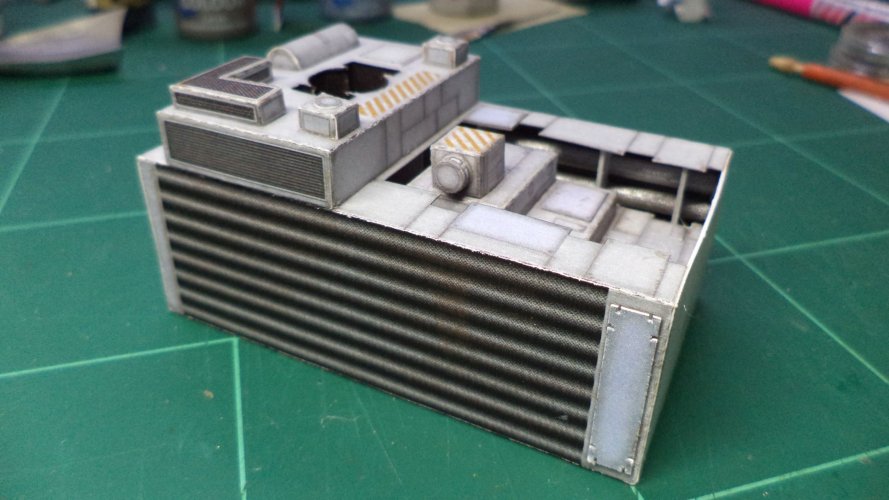

The front of the main body has this part attached to it, a fairly easy piece to construct.
The sides of the droid pit/neck area are painted, with a few greeblies added, and these too are ready for fitting.
The underside of the cockpit has a curved fairing - the shading gives a rough outline where to place it, but no real definitive lines.
The underside given a crude lick of paint, but you won't see much in here when pipes are added later.
A dry fit was in order, followed by a faint pencil line to give myself a target.

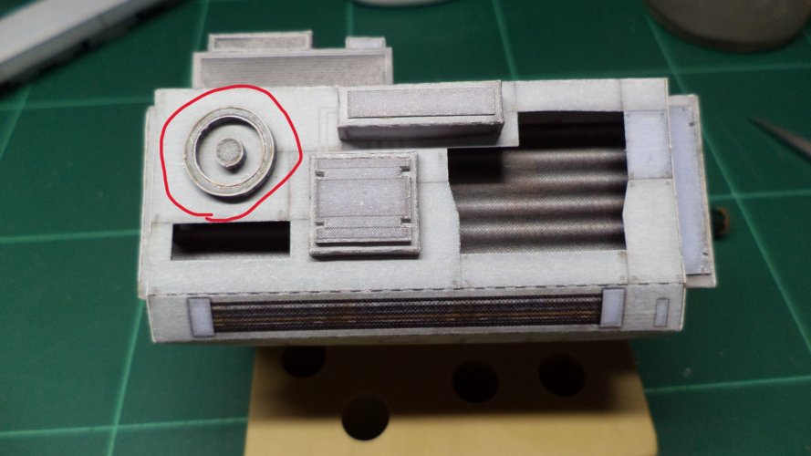

Starboard side greeblie circled came out fine...
Port-side however was a bit of a mess - so I havre tryied to make it look as if fluids have been leaking to half-heartedly disguise my shoddy wo
All parts added - no major fit issues with these, so all is well
