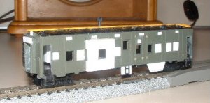

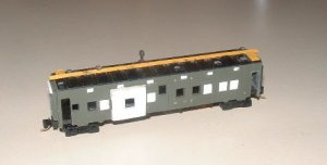

Thanks for all the suggestions, friends. After much thought, I opted to plug the windows with 1 mm styrene. Each piece was cut almost to size and then (painstakingly I might add!) filed and "snadded" to the point where they could be pushed firmly and snugly into the opening. There appear to be no gaps between the plugs and the window frame (but probably at 2 feet distance, one couldn't see them anyway!). Cutting out the end doors and the four side openings to the vestibules turned out to be a challenge since my "nibbler" was too wide. But drill, cut, file, and sand (snad) did the job. Slow work, but I think I'm going to like it.

absnut
Oct 18, 2002
334
Maine

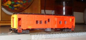

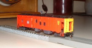

I rushed and it shows in places but, nothing that can't be touched up. I need to get a decal set to finish the lettering....... of course, the appropriate decals are no available in N scale, so what is available will have to do. The most important result is the proof that the troop sleepers are "bashable". My guess is these differed somewhat from one another so mine is a reflection of that..... I used the left side of one and the right side of another as my "model". No prototype number would be accurate so I picked one out of the hat. My BAR trains will, now, have at least a representative caboose in tow! :D

Looks absolutly great! Microscale makes a few BAR decal sets but no cabooses. Looks like you got some decals. I found this on the net, you have probably seen it before (link below). Maybe these guys have a set in HO. You can go to a color copier and copy it at 54% to a decal sheet.

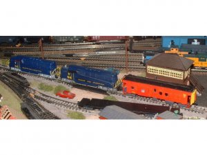

absnut
Oct 18, 2002
334
Maine

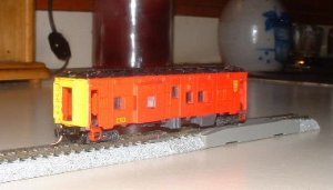

TC, styrene plugs fit the bill, for sure. No photo of it on a train but, here's a crew on their way out to pick up the Searsport consist and head for the coast.
Dick
