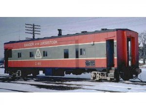

Thanks for all your input, I appreciate the interest. I considered just painting out the unwanted windows but, the clear plastic insert does not come out flush with the car sides. Also, there is noticeable "space" between the "glass" and the window frame.Simply plating over the opening won't work for this model as the BAR recessed the plating so that it was flush with the car sides. I will ponder all the suggestions I've received and experiment to see what works best (and is fairly easy). I will not be put off by difficulties :) There are no problems..... there are only solutions!!! Here is the item I wish to model only I will paint mine in an earlier scheme.
